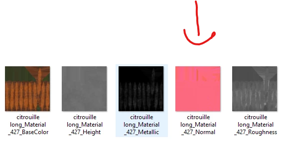

I have a problem with my normal maps.
Each time i export my textures i end up with a "pink" normal map.
It doesn't work on 3dsmax (or i don't know how to use it)
I tried with other props i had but i get the same results..
I tried with an older version of Substance Painter but i still have this problem..
What can i do ?

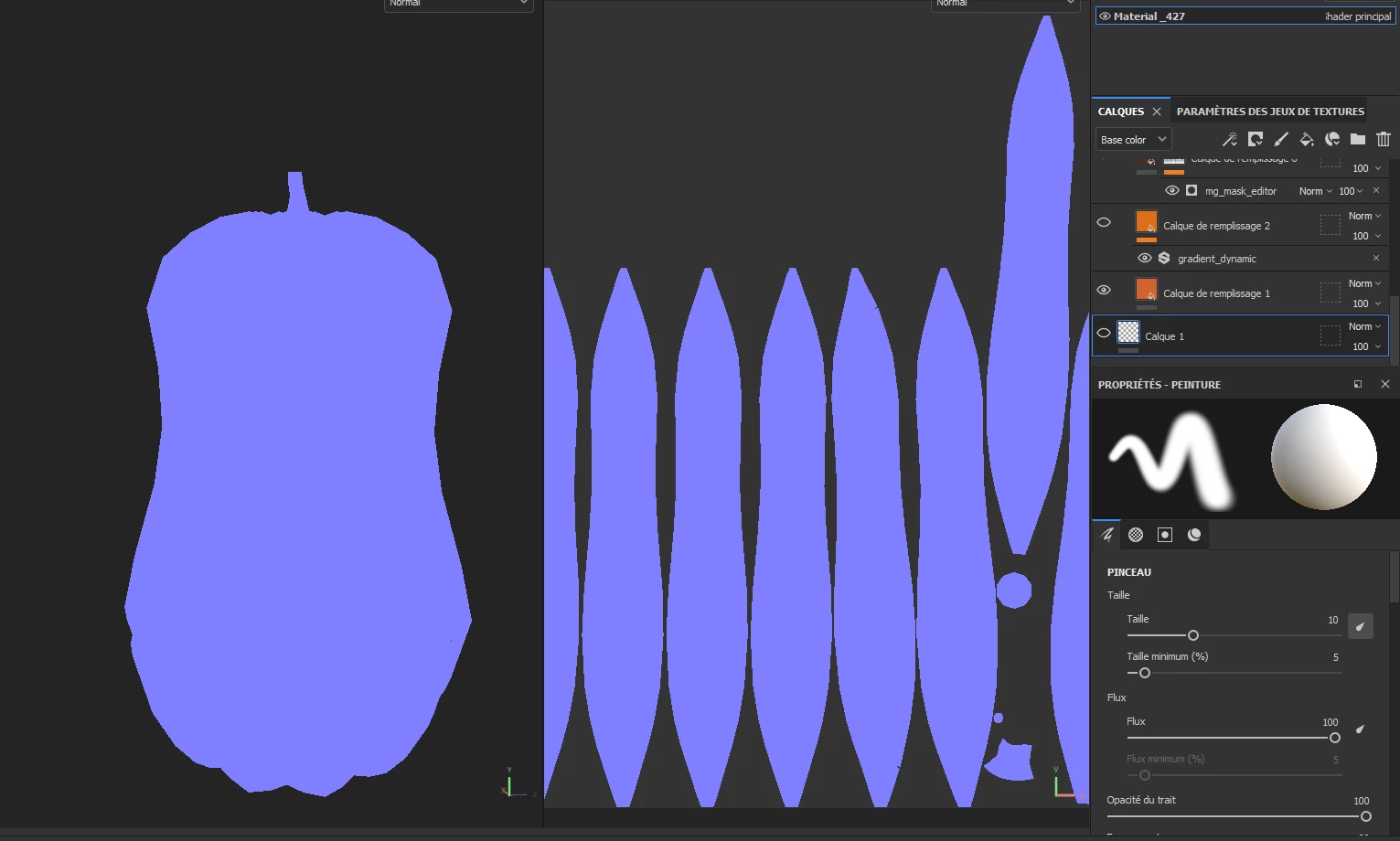

-With the filter

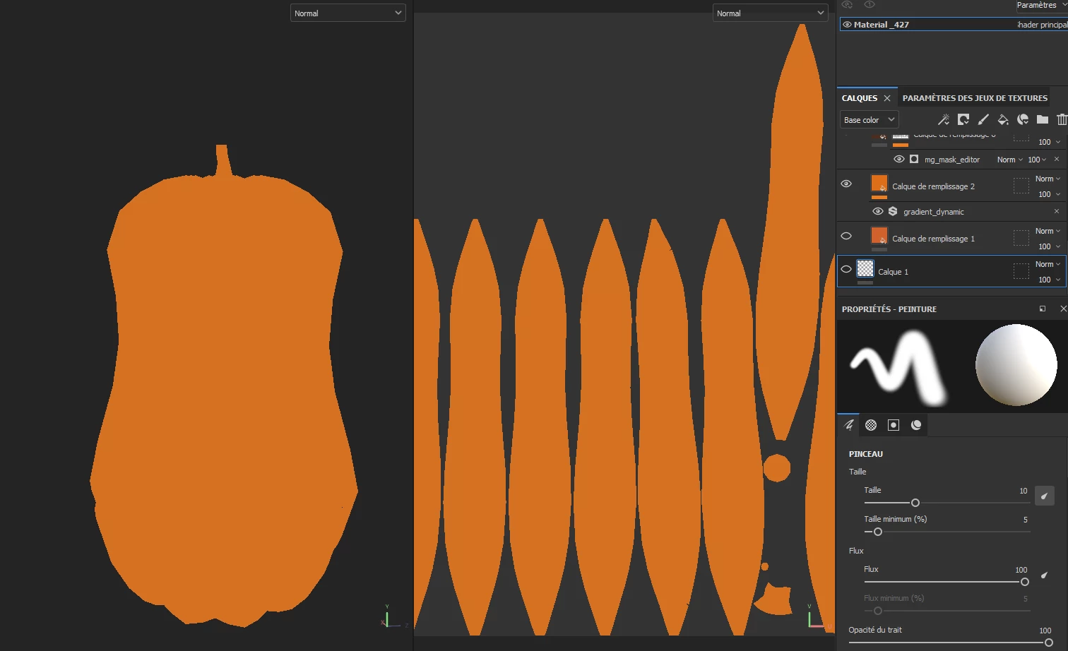

-Without the filter

-With the filter
-Without the filter
