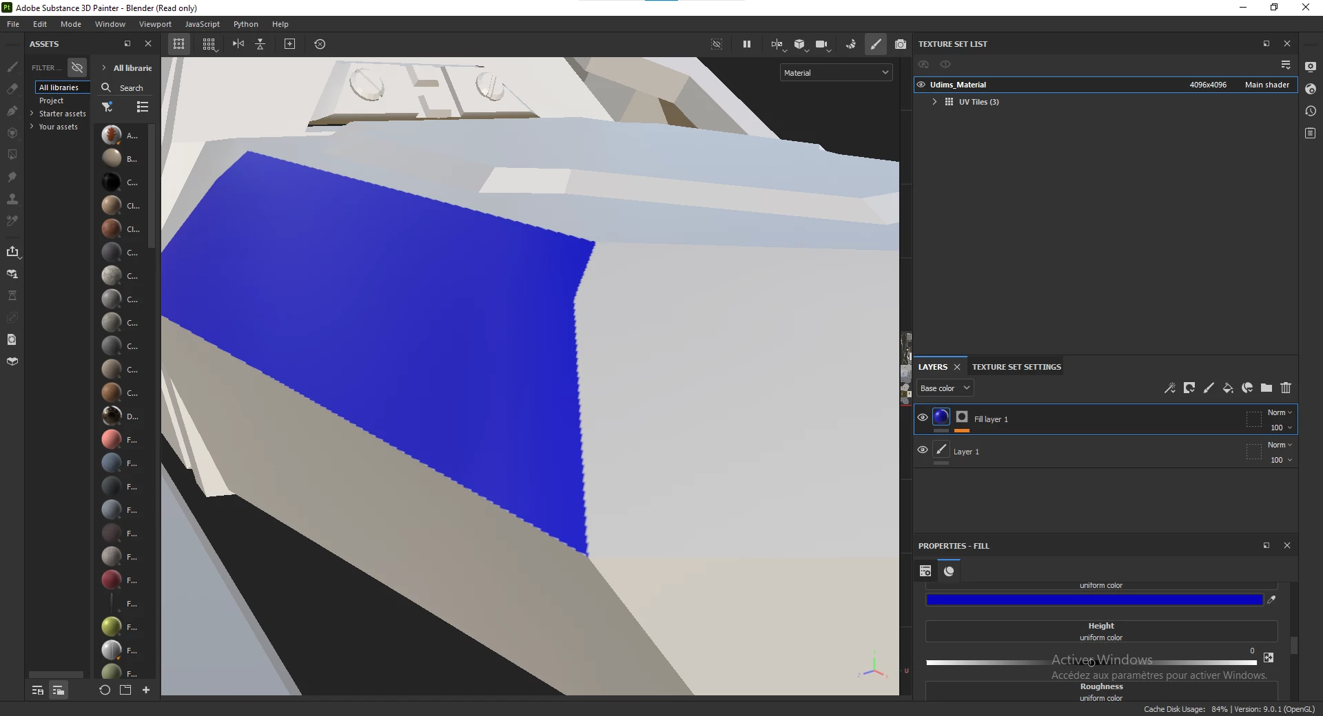

Hello. I am looking for some help with substance painter. i have this awfull pixel problem around my edges.

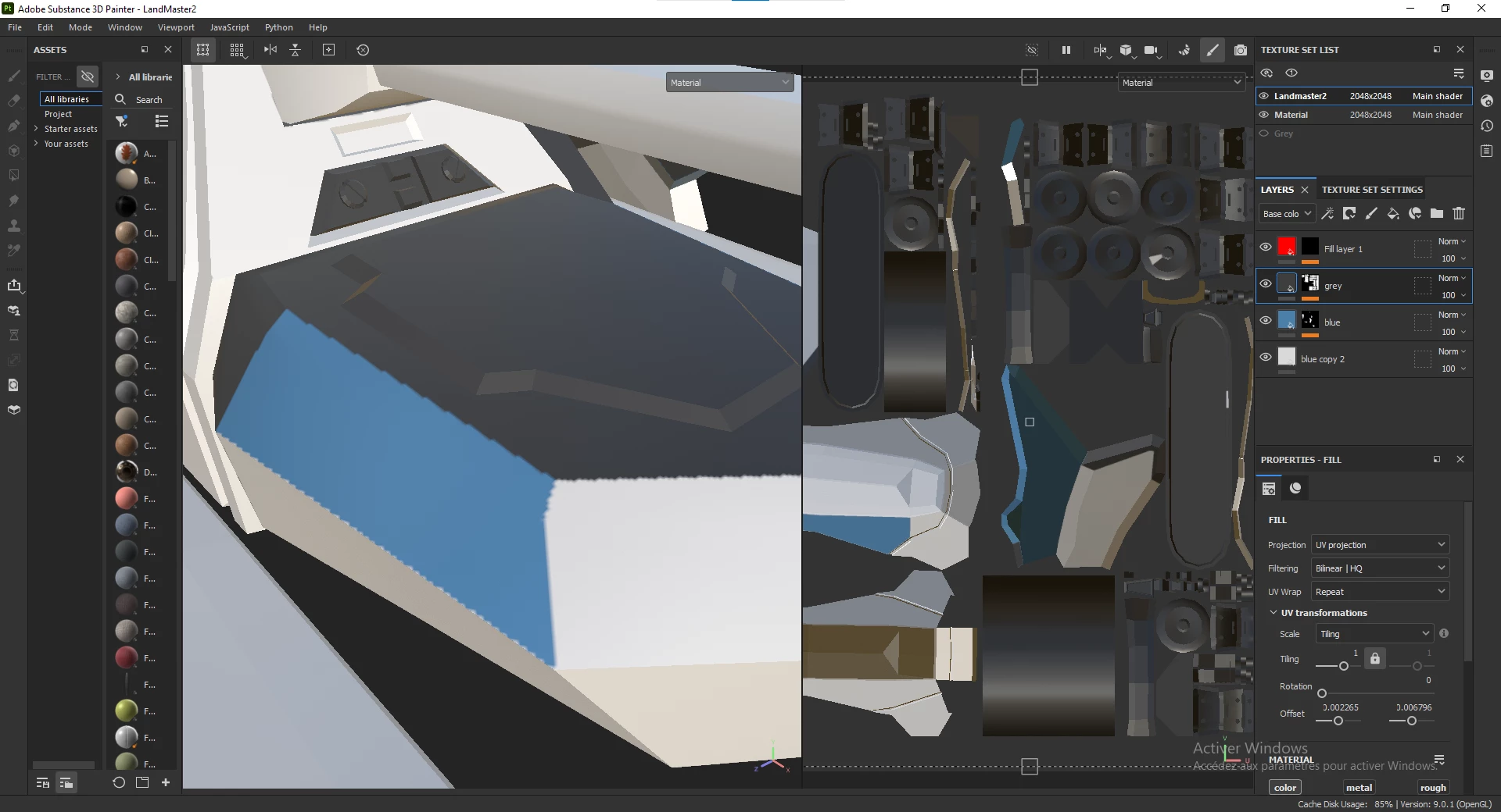

After I added colors I got this pixalization at the edge. i tried dividing the uvs on two diffrent materials to add more space for the uv. didnt work. I now realize that probably wasnt the answers.
also this is a low poly model.

Hi @buildingtub723,
The issue seems to be indeed a Texel Density problem. You can spread the UVs on several UDIMs, or increase the texture set size for 4096. This should already help.

Oct 27, 2023 9:18 PM UTC
I follow your advice it seem to have improve a lot thanks!
