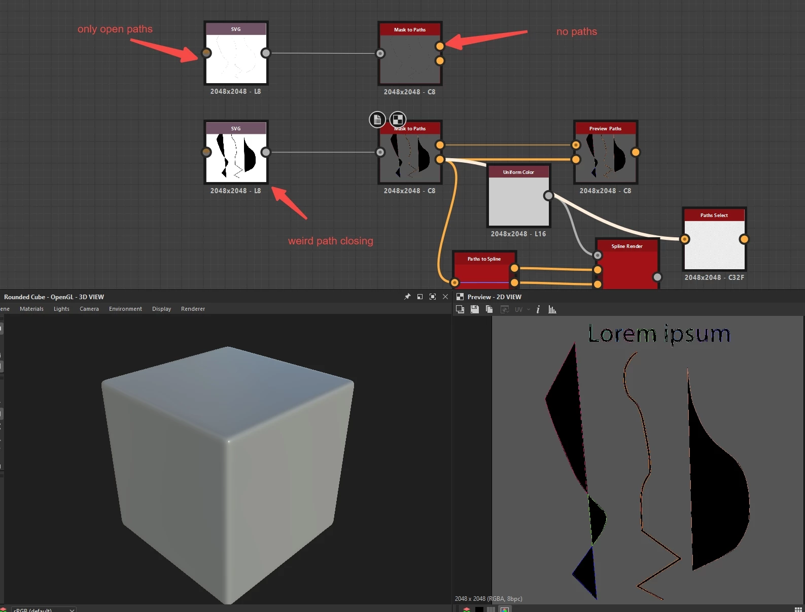

I imagine the hole process like that:
1.import an svg from Illustrator into designer.
2.connect to a mask to paths node
3.use those paths to do the magic further downstream (maybe convert them to splines first)
But in there a similar problem arises. When entering an svg node linked to a file with only open paths in it, the “mask to path” node doesn’t pick up anything. Only when I have at least one closed path in the svg file it picks up an outline, but also unfortunately closes the open paths from end to end.
So, what could I do to get a single curve, path or spline in substance designer? Maybe give it a different kind of input file?
