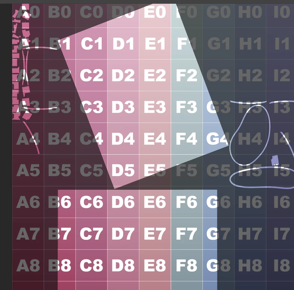

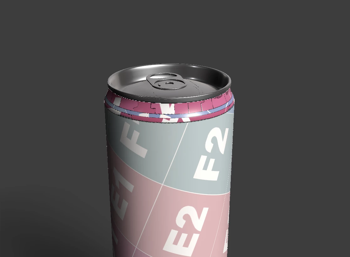

I wonder if this is the same with a can design. I have been strugelling with the UV map from Dimension and Stager.
Seems like the UV never lines up as I wish it would. At first I belived to be the error on my end as I was the one that designed the can. However, after using Adobe's files that are within dimention and even from stock.adobe.com, I ended up with the same results. I have a attached some screen graps to see if maybe anyone has expirience this issue too.
