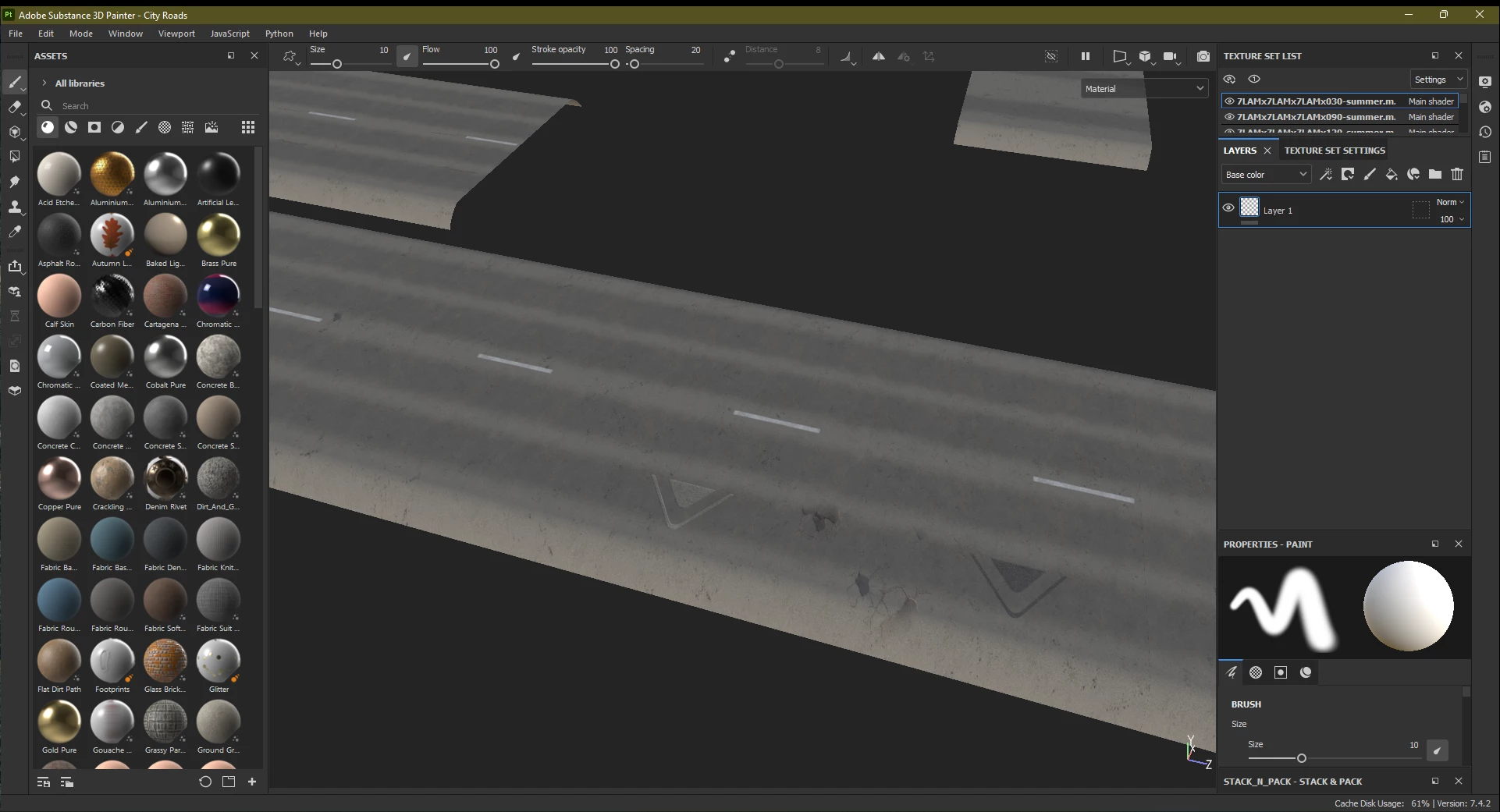

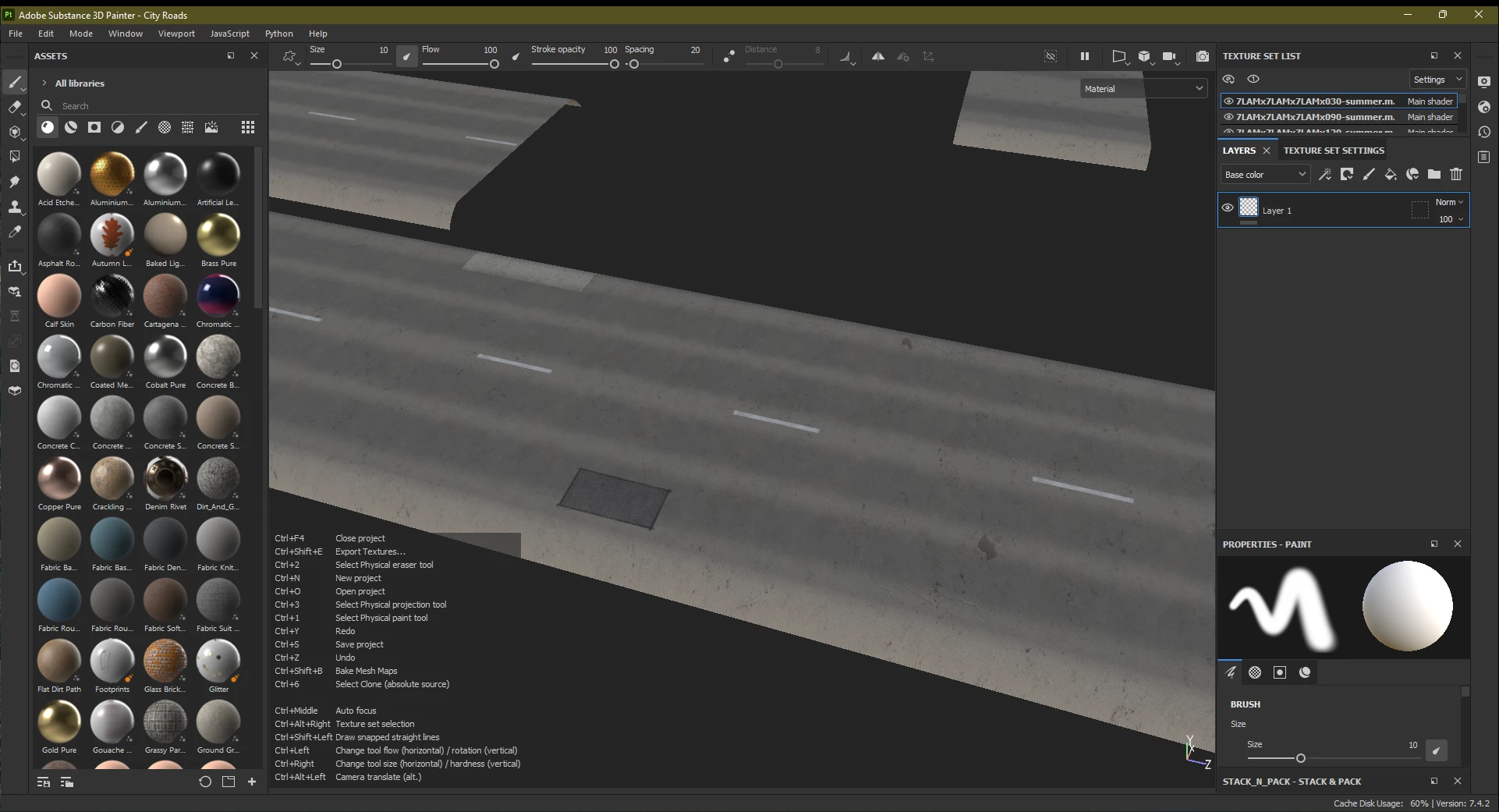

A quick update on this weird stuff. I had to add a few more meshes to my model so I went to project config and loaded the updated fbx file.
My texture looked like this before doing so:
Then I loaded the updated file, and came to see this (before and after baking, it's the same):
Watch those triangle-like shapes. I remember when I could not use the stencil, I gave it several tries, and for one, I used this triangle as a stencil. Then I deleted it, and created the fix on the asphalt using the projection tool and my pen. It is weird that by updating the project with a new FBX file, these stencil paints came back as they should not even exist anymore. As far as I can remember, I even deleted the Paint layer from the mask stack and created a brand new, so I really don't get it how this could happen.
I downgraded from 7.4.3 to 7.4.2 and 7.4.1, performed the same procedure, and got the same results. So it must be something with my project file, rather than Substance.
At this point I don't even think it's the video driver, it's more like a corrupted file. I feel very sorry for my carefully designed potholes and road fixes. 😞 If you want to help me, you should probably send a few bottles of whiskey.
