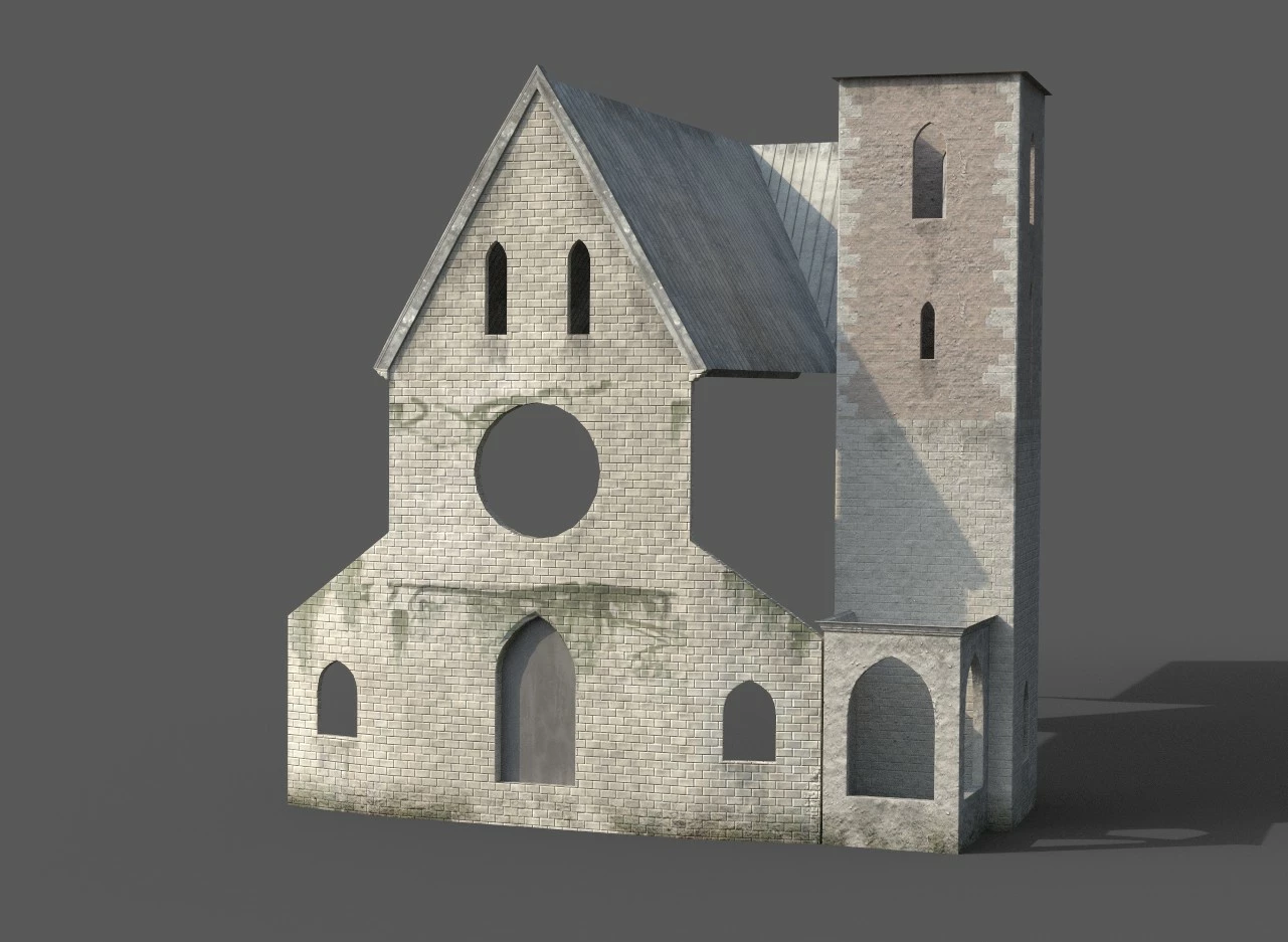

Image. 1 - architecture textured in Painter. Imported as fbx, about 10 objects, and 20 UDIM

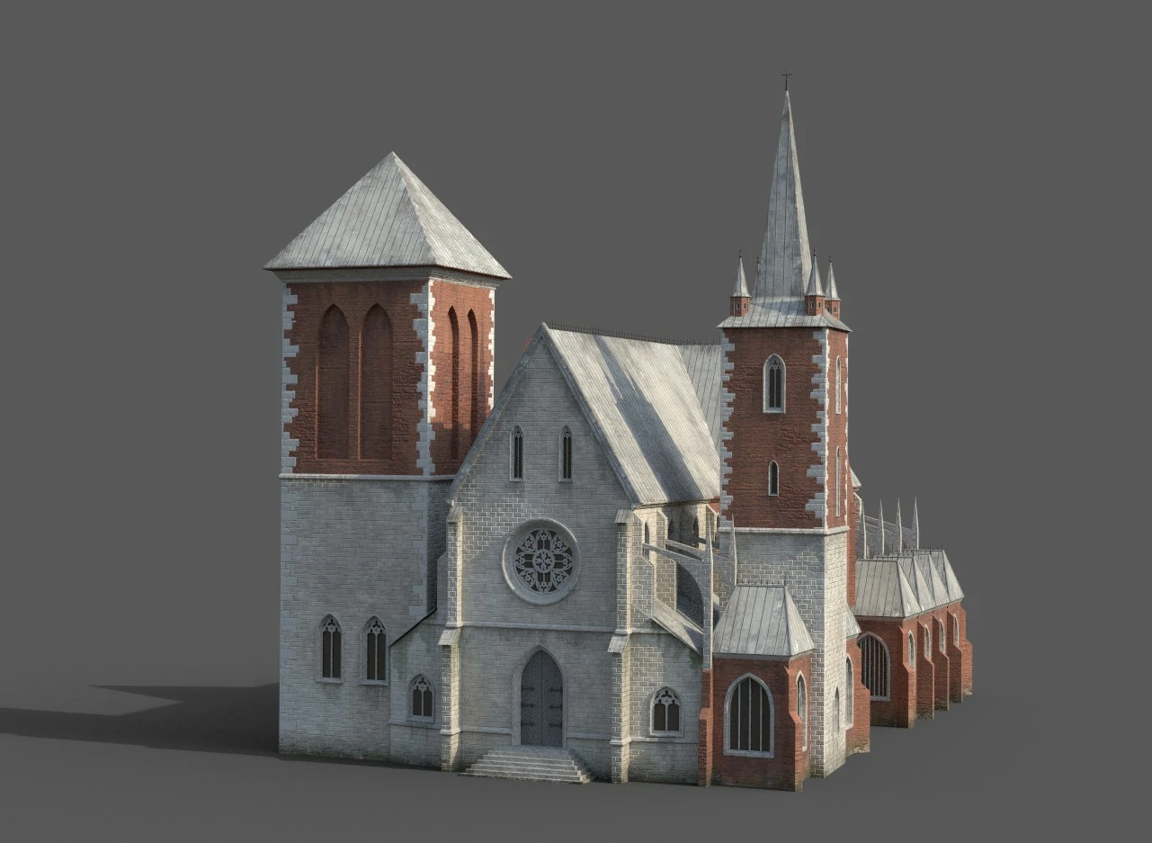

Image 2 - I am moving the objects, the tower on the right and the wall front. Reimport as fbx and the result is comletely bad

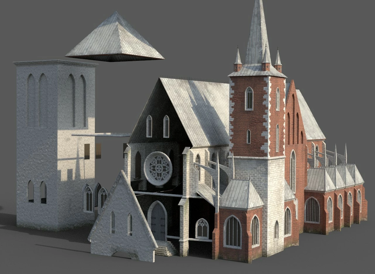

Image 3 - Test. I have imported only a few objects, and the texures on these objects are wrong. In all cases the UV does not change.
Someone can explain this behavior of PAinter. Does it mean that after starting texturing I cannot change the mesh. Move, add element etc. Changes are part of the job.

Brush strokes painted in 3D space are reprojected in 3D, so if you mesh change/move thet brush strokes won't be re-projected as before. That's actually a feature : this allow to change your mesh topology or UVs while the mesh should still remain in the same position as before.
You should leverage the Geometry Mask hiding feature to paint underneath things instead of moving away obejcts.
