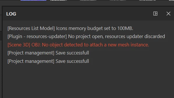

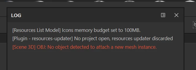

I have gotten several error messages in the logs:
What does "[Scene 3D] OBJ: No object detected to attach a new mesh instance." mean?
And what does "[Resources List Model: Icons memory budget set to 100MB" mean? When I look into my settings it says +500MB.

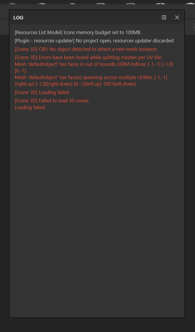

Hello @Lei5E5D,
Thanks for the message.
The lines we should worry bout are those in red. In your first sent log, I can see there are multiple issues with your UVs.
Face(s) spanning across multiple UDIM means there is one or several UV islands localised on multiple UV tile (1001, 1002, etc.). Make sure that no UV islands is spanning between two (or more) tiles.
Also, Substance 3D Painter doesn't support UDIM on negative spaces (below or to the left of the tile 1001).
If the errors persist, I'd advise you to load the object inside another software to make sure there is no issue at the export.

Hi Cyril,
First of all, thank you for getting back to me. You were right! I checked my UV editor and I saw one tiny little piece that crossed over into the negative space. That helped to fix my UDIM.
However, even after fixing that issue, I still have a notification at the bottom right that says the same in red font " [Scene 3D] OBJ: No object detected to attached a new mesh instance" . But somehow Substance 3D Painter still looks like it does bake when I bake the meshes and still lets me add textures. And in the log it seems to be still autosaving. Is there still something wrong with my OBJ? Please note, I was able to load the .obj file into Blender and export it.
