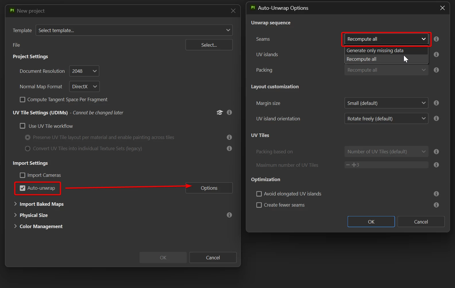

Hi @SnowCold,
You can try to use Substance Painter's Automatic Unwrapping. It usually doesn't make small islands as Blender does with its Smart UV project. However, our Automatic Unwrapping can have hard time computing hard surfaces objects, so I don't guarantee that it will be perfect.
When creating a new project, check the "Auto-unwrap" box and specify "Recompute all" in the options panel.
That being said, if you want clean texturing, you'll need to learn how to build clean UVs.
