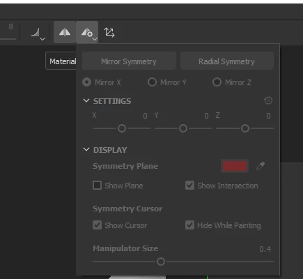

Symmetry Settings not Working.
I've been following through on the Substance Painter 2021 Getting Started Tutorial - Part 03. The problem occurs when he introduces the viewer to radial symmetry. Whenever I try to hover or click on the symmetry settings, it briefly pops up then disappears. What is happening? How do I fix this?

The Setting UI panel is frozen. Can't access the settings

I'm encountering the symmetry tool setting panel greyed out and inaccessible on OSX with a M1 mac:
Substance 3D Painter, version 8.1.1
Build 1736 - cc21af9a095e8e113192710615ddad6d929df9fc

same with me. symmetry options not active or greyed out.
