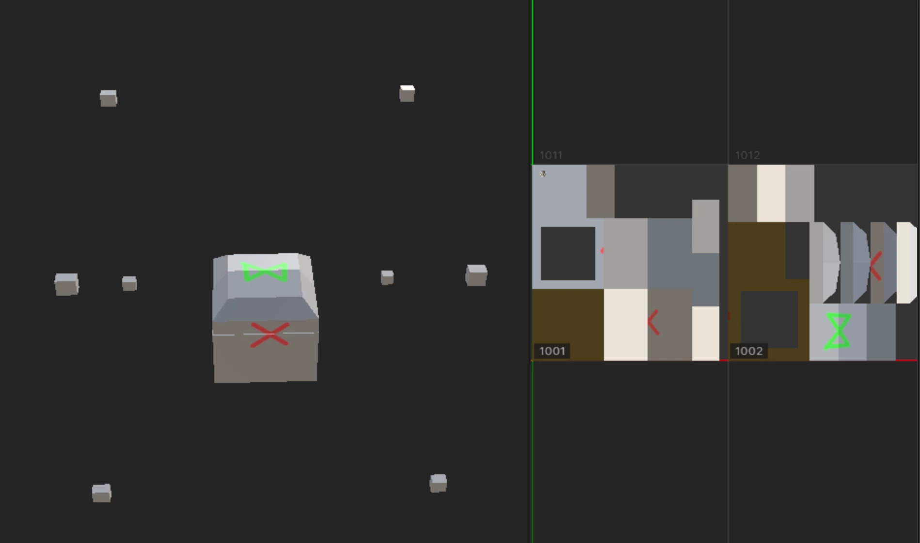

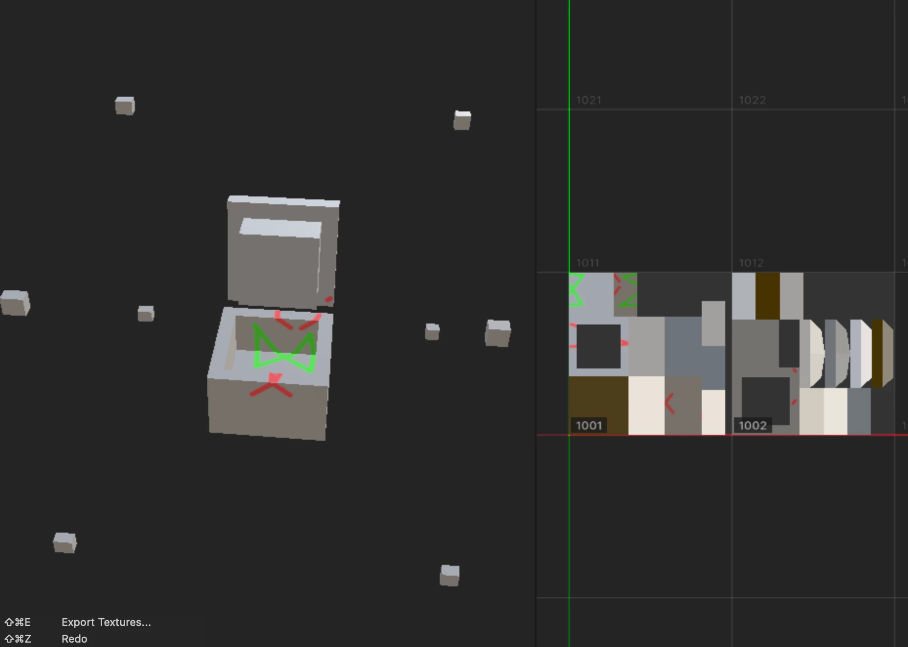

Here is a simple version of the issue I am facing. as you can see the stroke have moved when I imported the same mesh but on a different state (location and rotation are different for the lid).

  • I have 3 meshes with the same material unwraped using UDIM so 1 UDIM tile for the box and another tile for the lid . The 8 little cubes that serve as a bounding box are also unwrapped on the UDIM.
  • I export the first frame of my animation as an FBX, I export the last frame of the animation as an FBX
  • in substance painter I import the first frame FBX, paint on the 3D view a red and a green mark (the red mark spread across the two meshes).
  • put my paint layer in a folder and create a smart material
  • go to edit > Project Configuration > File and select my last frame FBX (check preserve stroke position on mesh but also try with that parameter unchecked)

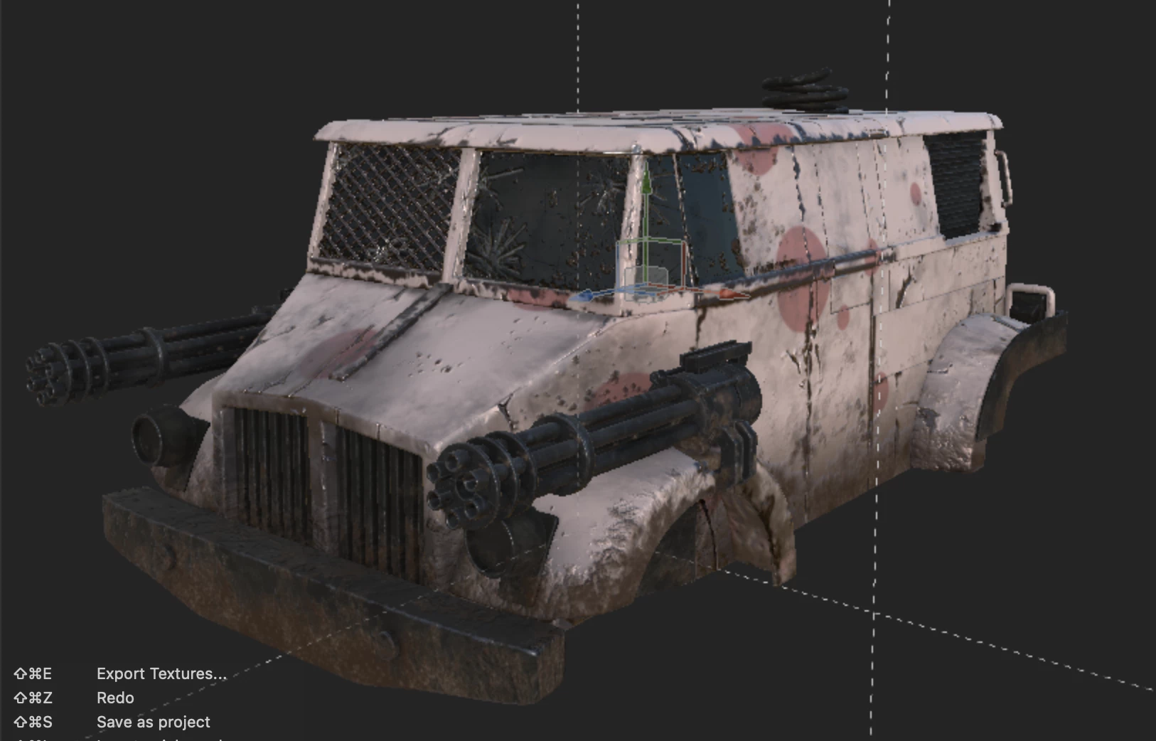

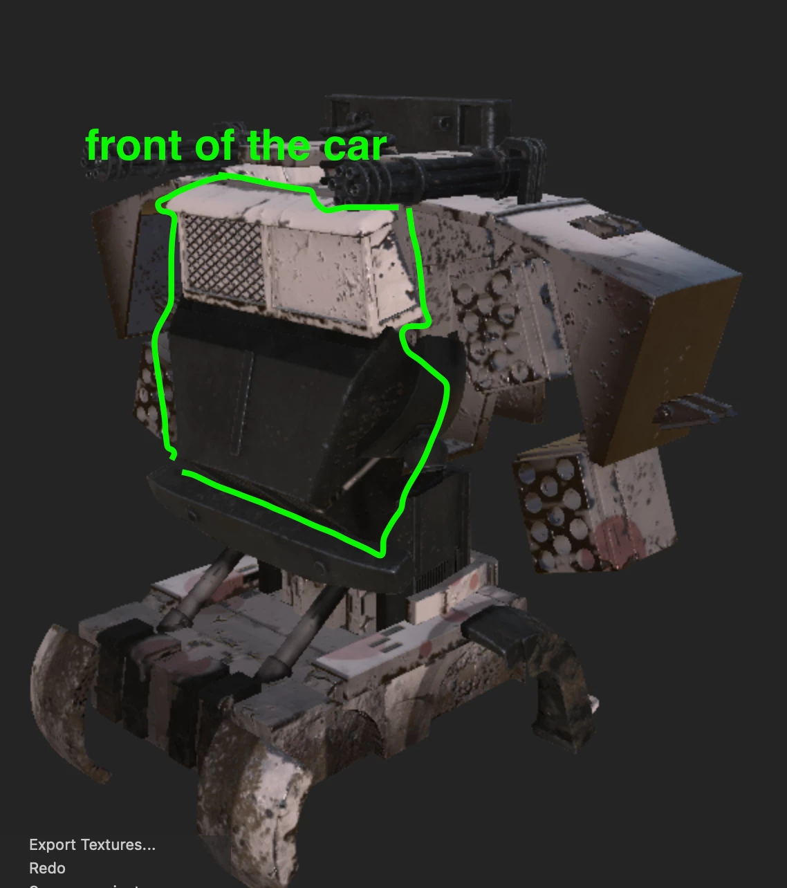

Here is my more complex project with the strokes not sticking to UV
A workaround would be to export the texture I painted on the car state of my project, import robot state FBX and keep working on it, but I would loose the ability to control precisely my texture thanks to the multiple layers and mask used on complex projects. I also know that If I had painted on the 2D UV then the stroke would keep their location between the car and the robot state, but depending on the seams it is not possible.
