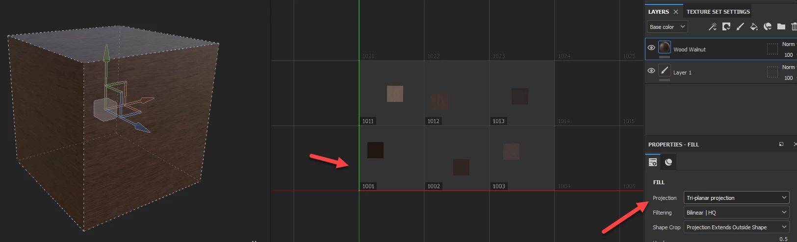

Hi there,
I'm fairly new to painter. I've used it a few times. I've used the Tri-Planar projection previously with no issues.
Here I have 3 rectangle shapes, very basic. They are cut into more that one UV, so i need to use tri planar to even out the wood grain. As soon as I chose the tri planar from the drop down, it just removed the material, and the mesh turned back to white again.
There is not an error code, and nothing in the log. I double checked to make sure all my UV's were facing the same direction , and they are.
Does anyone have a thought as to what I've done wrong? - thank you for your help.

Can you make sure your UVs are within your 0-1 space (packed within your tile as per my screenshot) ?
Jul 5, 2021 11:13 PM UTC
I'm using UDIMs to get a better resolution. Each of the individual tiles are within ratio though. I just don't understand it. I've used UDIMs in painter before without an issue. I'm not sure the UDIMS are causing it though. I've used a tri planar with UDIMs before with no issue.

If you're using UDIMs it will work just fine, however you don't want anything in negative space (below or to the left of tile 1001).

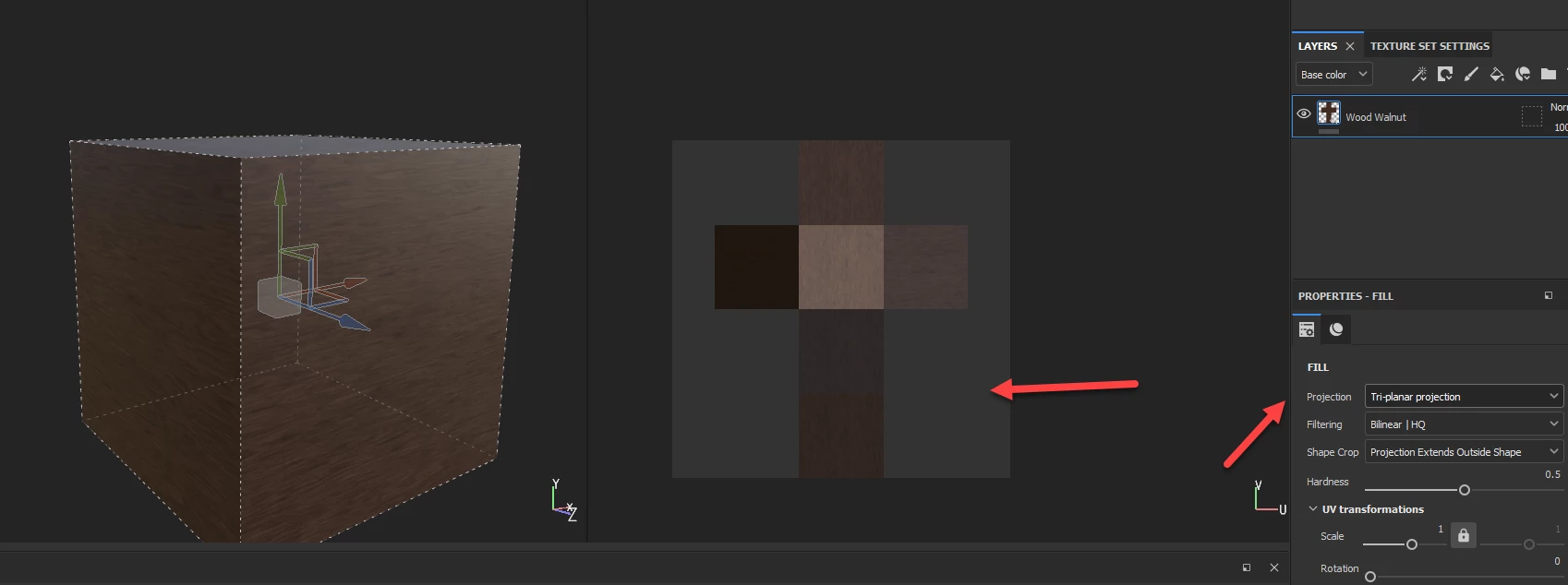

Your 2D view doesn't look proper for UDIMs though so I would assume you have something in negative space otherwise it should look like this:
If you put it in negative space it wont work properly so double check this. If this doesn't help then you might want to share your mesh file.
