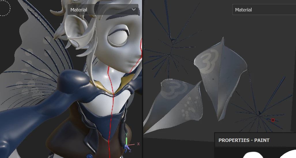

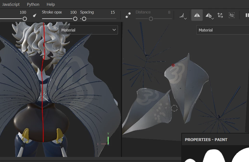

Dear Cyril,
Thank you for your reply! I think I have the importing files figured out--I had another question in regards to a problem with painting on my model: attached is an image of a model I am working on. Whenever I apply a stroke, it ends up with a spotty trail...I am painting onto the model itself because whenever I try to use the symmetry tool on the actual material maps, it seems that the stroke I paint on one side of the wing gets mirrored on the front side of the opposite wing. Are there any alternatives, and am I utilizing the symmetry tool wrong?

Cyril Dellenbach
ago. 7, 2023 8:43 AM UTC
The character is probably not perfectly symmetrical. A slight change or rotation could end up with a "false" symmetry, which can become obvious when working on specific spots.
You could try to turn off the Backface Culling parameter of your brush. Considering the strokes are still painted on the other side of the mesh, turning off the Backface Culling may help.
