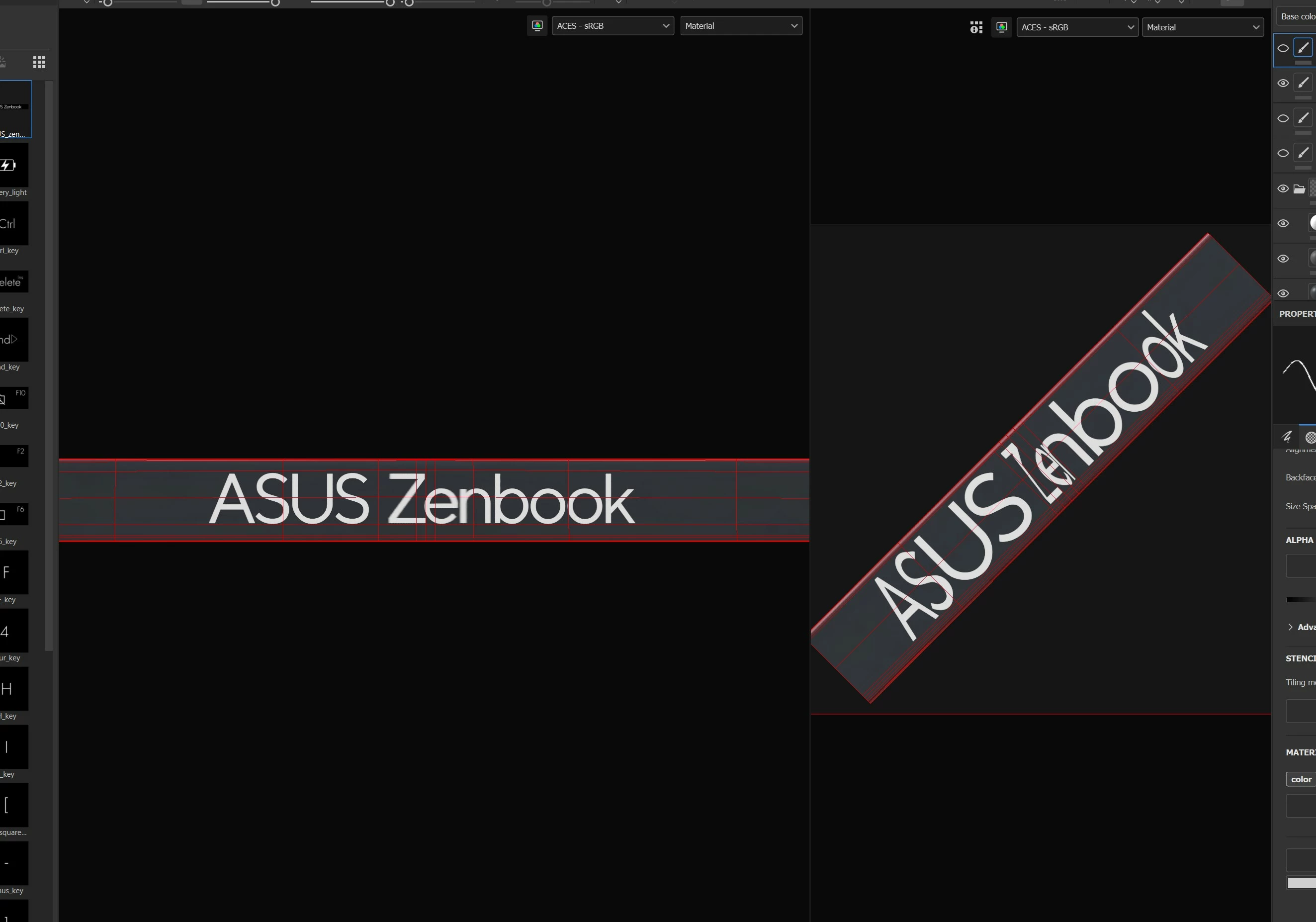

OK, back again with this, I'm having new issues due to the subdiv schema. Why can't painter work well with meshes that don't have subdiv schema? or even meshes with subdiv schema set to none. It loads the mesh, but it's all messed with parts of it invisible and the painting is totally whack. When you have a subdiv schema it screws up the UVs because of the subdivision and can cause all sorts of weird ass distortions (see image) that requires additional edge loops or maybe some sort of creasing. I just want my original usd mesh (no subdivision from USD) file inside of painter! How can I achieve this?
