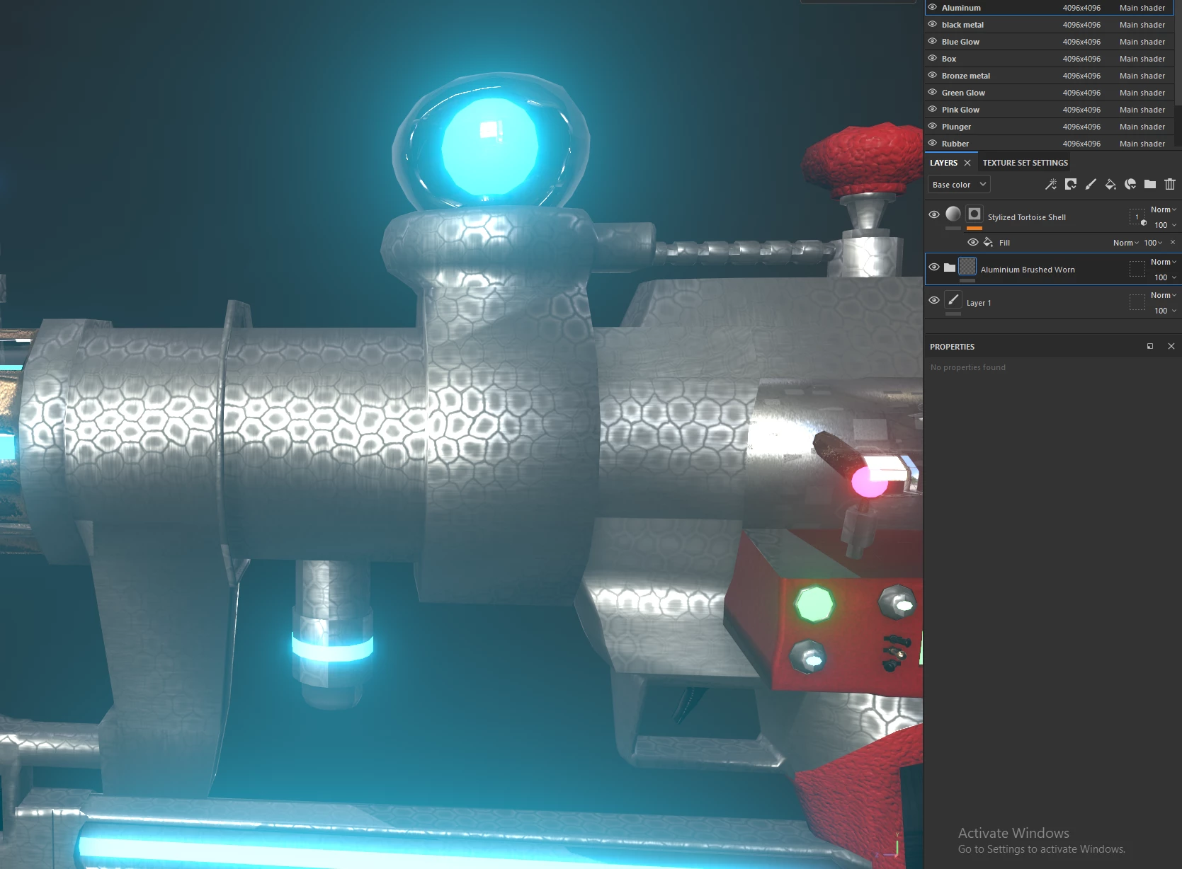

Using a roughness texture, to place color
I added the roughness channel from this turtle skin material, on top of a aluminum material to add a pattern. It creates these outlines with spots in the center. How could I make it so the outlines in the metal have a different color? Could I also make a separate color for the grayish spot in the centers?

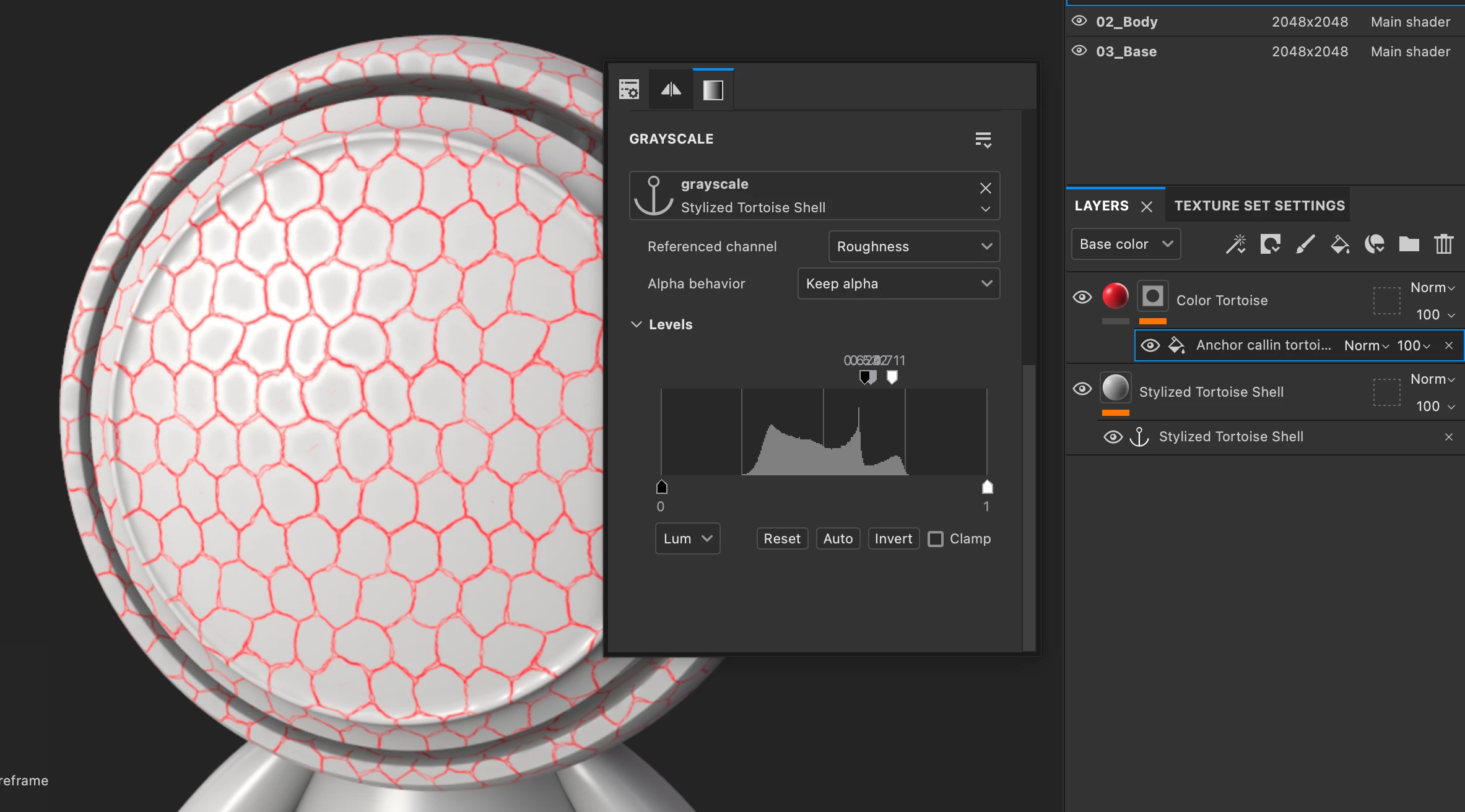

    Hello ​@Muji17,
    You should play with Anchor Points. Place one in the Tortoise texture, then create a Fill Layer, add a Mask, add a Fill Effect inside the mask, call back the Anchor Point’s roughness and finally use the Level to refine where you want the mask to be.
    Hope this helps!

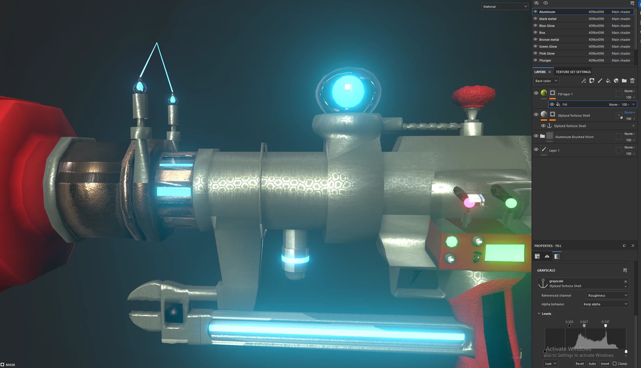

    I am still able to see the pattern but when I try I am seeing a green tint on the whole material not just the pattern from the roughness. Is there something I set up wrong?
