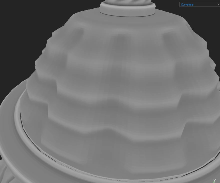

Hey guys I'm getting these really nasty seams when I use the curvature generator or the mask editor. The seam is barely visible in the curvature mask itself so I am confused why it is so strong once using a generator based on that map. It is less of a problem when the UV seam is on a hard edge, but for some objects like this one it is impossible to unwrap without a UV seam on a curved surface.
Ive tried baking the curvature map out with all sorts of different settings without any success. The sliders sharp/fine/soft/medium etc under the curvature generator can reduce the visibility alittle but does not eliminate the seam.
I figure I can just paint it out, but I would prefer to keep things fully procedural until the last steps rather than having to paint every time I use one of those generators.

You can try the tri planar option in some generator.
For myself when the automatic solution is impossible I'll create a paint layer between the generator and the mask and I'll paint on it with a dirt brusch to hide the seam.

Hey thanks for the reply! Ive tried the triplanar setting and found that it only applies to any additional texture added to the curvature or mask editor generator. The part of the mask created from the curvature editor contimues to have a seam. Painting it out definitely seems like the best solution, just makes it abit harder to transfer between objects or make changes later sadly.

Yes if the triplanar option don't work in the generator the best way is  to add a paint layer between and paint on it to hide the seam,you could alternate with a dirt brush the white (add) and black (remove) with x shorcut to hide the seams.
It 's difficult to transfert between objets but with practice it's fast to do it for each object.
