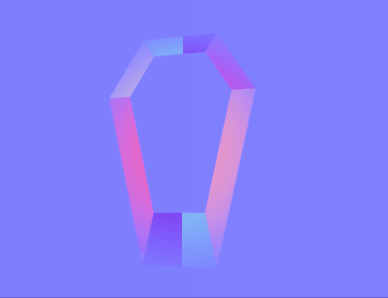

Why does Substance 3D Painter make such visible UV seams? It's definitely normal map problem, because if I export the texture set and apply it in a 3D modeling program, the seam disappears if I disconnect the normal map.

Correct answer Cyril Dellenbach
Hello again @JP Agner,
Thanks for all the details, this way I was able to reproduce the issue with the same Smart Material.
You were perfectly right, this specific issue isn't due to the shader quality, but to the way we handle certain filters and specifically the MatFinish. These filters are affecting directly the normal map, not trough the height as we usually do inside Substance 3D Painter, but directly the normal map. Unfortunately, the normal map is a bit more complicated to turn seamless. We can see it clearly with the Perforated Circles Filter.
We are aware that these filters aren't seamless, but for the moment, when using these types of filters with visible seams, you'll  need to find a workaround. I'll suggest to look for a grunge/alpha/texture that acts like expected and play with the height more than the normal map. As a simple example, you can get close results with the Metallic Grate Round Texture rather than the MatFinish Perforated Circles Filter.
For your question about UV shells orientation, this is accurate, but this shouldn't be a problem inside Substance 3D Painter. You can always make sure your UVs are well oriented to avoid any unexpected behavior.

However. I did a lot of experiments and found out that there are two types of visible normal map UV seams.
In one case, the seams are only visible in Painting mode and are not visible in Iray mode or in other 3D software upon texture export. In other cases, the seams are visible everywhere (Painting mode, Iray, and in exported textures).
Increasing shader quality can get rid of visible seams in Painting mode, but only if you're dealing with the kind of visible UV seams that does not affect exported textures or Iray mode. Enabling anisotropy for some reason also does the trick.
Unfortunately, I've been dealing with the second type of visible UV seams issue. I used Copper Red Bleached smart material in my example, and it seems the problem is with the finish_rough filter. Maybe it doesn't work well with tri-planar mapping, I'm not sure.
Also, I've noticed a problem with visible UV seams in baked normal mesh map (when baking details from high to low poly). For some reason, it's much more noticeable compared to when I bake details in Blender. I bake at the same resolution of course.
One more thing. I was told that UV shells orientation matters, because
"the tri-planar is projecting details in xyz <...> Where as tangent space is correcting your normals to compensate for UV seams and UV island rotations. Imagine if you have a UV seams down the middle of a crater on your geo. You've orientated your UVs to maximize space but by doing so they are rotated opposite to one another. Tri-planar says Green is up so when baking the normal map the green channel will always be coming from top-down on the texture, this would screw up the UV orienated in the wrong direction. However tangent space has compensated for your UV rotation so for the green channel it will appear in the direction of where up should be on the geo to your UV. These two methods conflict each other right? One always says green on your texture will come from top-down. The other says Green will come from wherever the top is on the geo."
Is that accurate?

The issue here was simply the filters MatFinish that unfortunately don't support seamless work. The UV island rotation can indeed create a seam in the map, but simply because a normal map works in a tangent space; the purple (for example) will always comes from top to bottom (in DirectX format), regardless of the UV orientation.
However, this is the expected behavior and it doesn't mean there's actually a seam in your material. In fact, this is the opposite.
