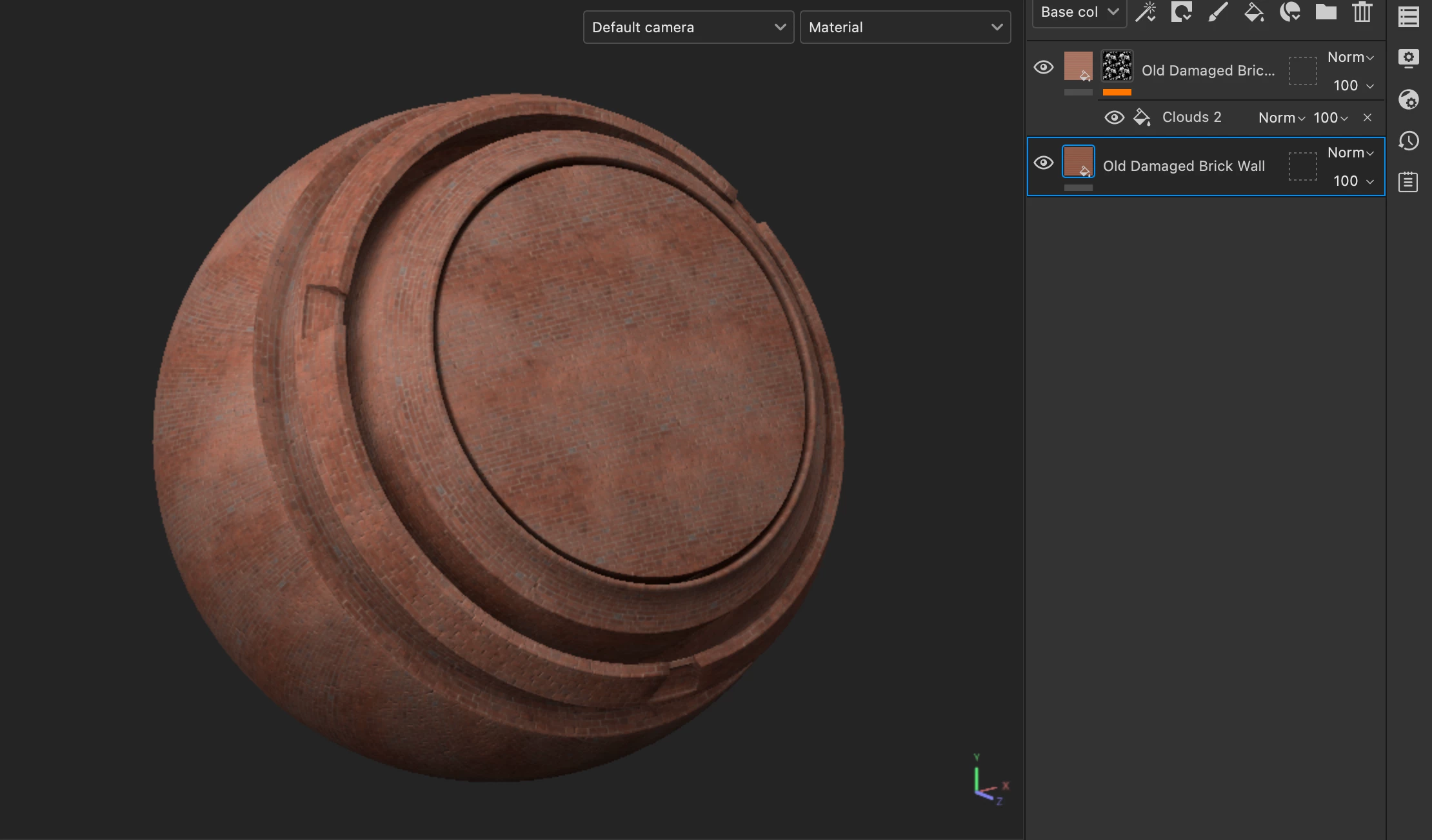

Workflow question. What is the best aproach when texturing large objects like terrains. I am always having the issue where I use a material and I tile it to get the scale correct but then I start seeing the tiling. To combat this I usually copy the layer and mask with a different noise which helps but is a bit laborious. For example I am trying to texture a pyramid like buildng which is 50 meters but I am struggling to get the scale corret.

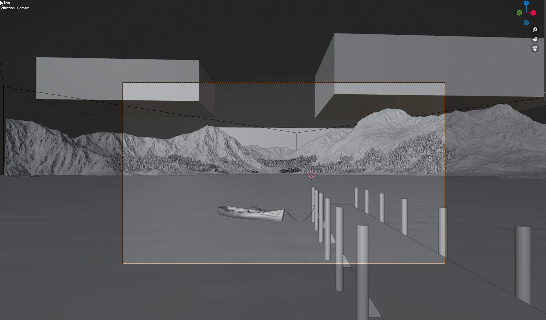

Option 2
I create several square tiles of similar materials but with variations. I then export those squares and tile those on the surface in my rendering app using random rotations and generated masks with non straight edges to break up the edges. This can work really well on natural terrains such as mountains or hills, particularly when mixed with other such material blends, e.g one for rocks, one for grass etc. It has the advantage that the surface texel density exceeds by far the 8192 x 8192 of a single tile.

Thank you option 2 sounds interesting, so just make some tileable textures and use them in 3d app?
davescm
Feb 19, 2023 9:22 PM UTC
Yes that is how I texture this kind of terrain. The pier is textured using option 1, the mountains and slopes using option 2 (note the snow, rocks and grass etc are also separated using masks generated in World Creator).

For example, you could add a brick material to the pyramid, tile it until it looks good and, on top of it, add a sand material that you would paint only on certain parts. This way, the tiling of the bricks would be a little bit hidden by the sand material.
You could also simply add a variation of your map with a noise mask.
This looks like what you did with the different noises, but this is the most common workflow.

Thanks,  some materials do work better than others I noticed.
