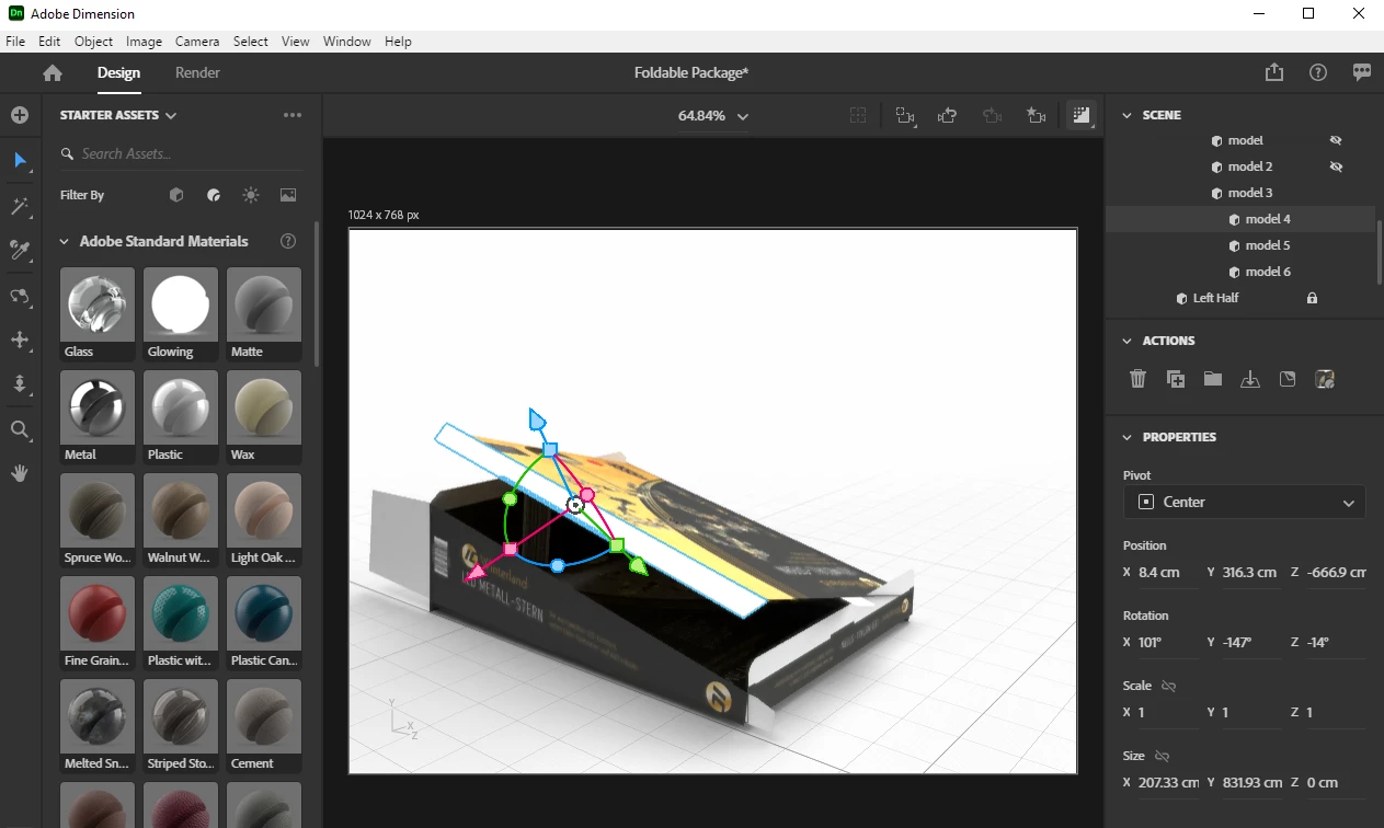

It would be possible to make that in SketchUp, and give it heiarchy to be able to fold it. And Dimension imports SketchUp files, which should give you a foldable box inside Dimension as well. I couldn't find a way to move the axes in Dimension, and it didn't always follow what I had set in SketchUp. Here's the Dimension file that I made, you can dig through the heiarchy of the model and rotate parts to fold them. I added the SketchUp file as well.

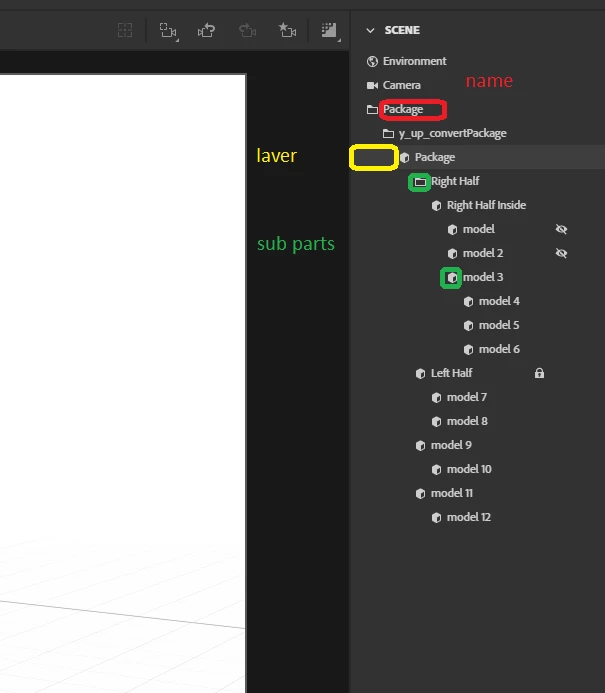

how to move a tab = select it then move it
this is a SkeakUp file and a custom one at that so I assume the big issue is just finding the tabs?
good news = Adobe Dimension reads \ opens SkechUp files correct
bad news = Adobe Dimension has no clue what the file actually is... it just opens it with whatever settings you have made
  • the file you made has custom mum \ child settings that Dimension doesn't really see so you need to click on the model (green) in order to open any sub parts of the model
  • red = change the name (which I would just to help track which part is which) & yellow i.e, any other part of the layer just selects the layer itself
  • in Adobe Dimension you have; top, center and bottom which normally is how the part joins to the main model or how it sits on the ground plan but in this case your SkechUp has custom settings for some of the tabs and Dimension tries to follow that if it can... you can break these joins and reattach them if you need some special option but (watch the vid) have a play first to see if 1 option is going to work for you
p.s, sorry about my spelling I'm in a train mate

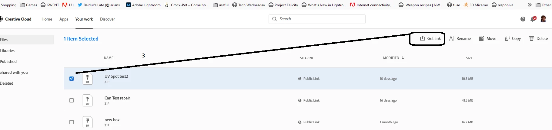

you can't upload a Dn file to this forum... yes I know what Adobe staff said
work around;
  1. zip the Dn file (only zip works not 7z or any other type) and drop it into your Adobe sync folder
  2. allow the creative cloud to finish uploading it to their server then open the web ui
  3. select the zip file and set your share option
Colin Holgate
Mar 6, 2021 4:54 PM UTC
Loading
Thanks for the suggest work around. I've tried a different one, lets see if this works (it will have the file for the next 7 days):
Foldable Package.dn
Ussnorway7605025
Mar 7, 2021 12:23 AM UTC
it works well... nice model Collin
Tip: Adobe Dimension always folds relative to the ground plane
