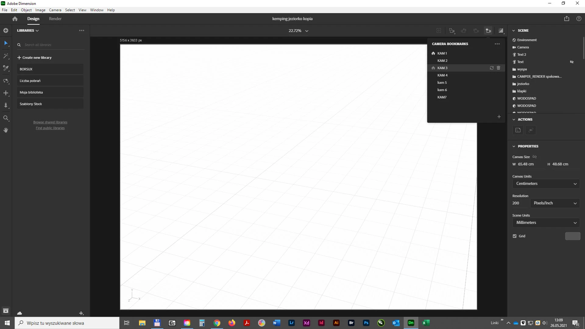

Witam mam pytanie modeluję model z wieloma obiektami w Adobe Dim - plik docelowy osiągnął rozmiar 7,8 Gb, działa normalnie, wszystko renderuje poprawnie, ale po zapisaniu i zamknięciu i ponownym otwarciu pliku warstwy są załadowane, ale niestety obszar roboczy jest pusty?

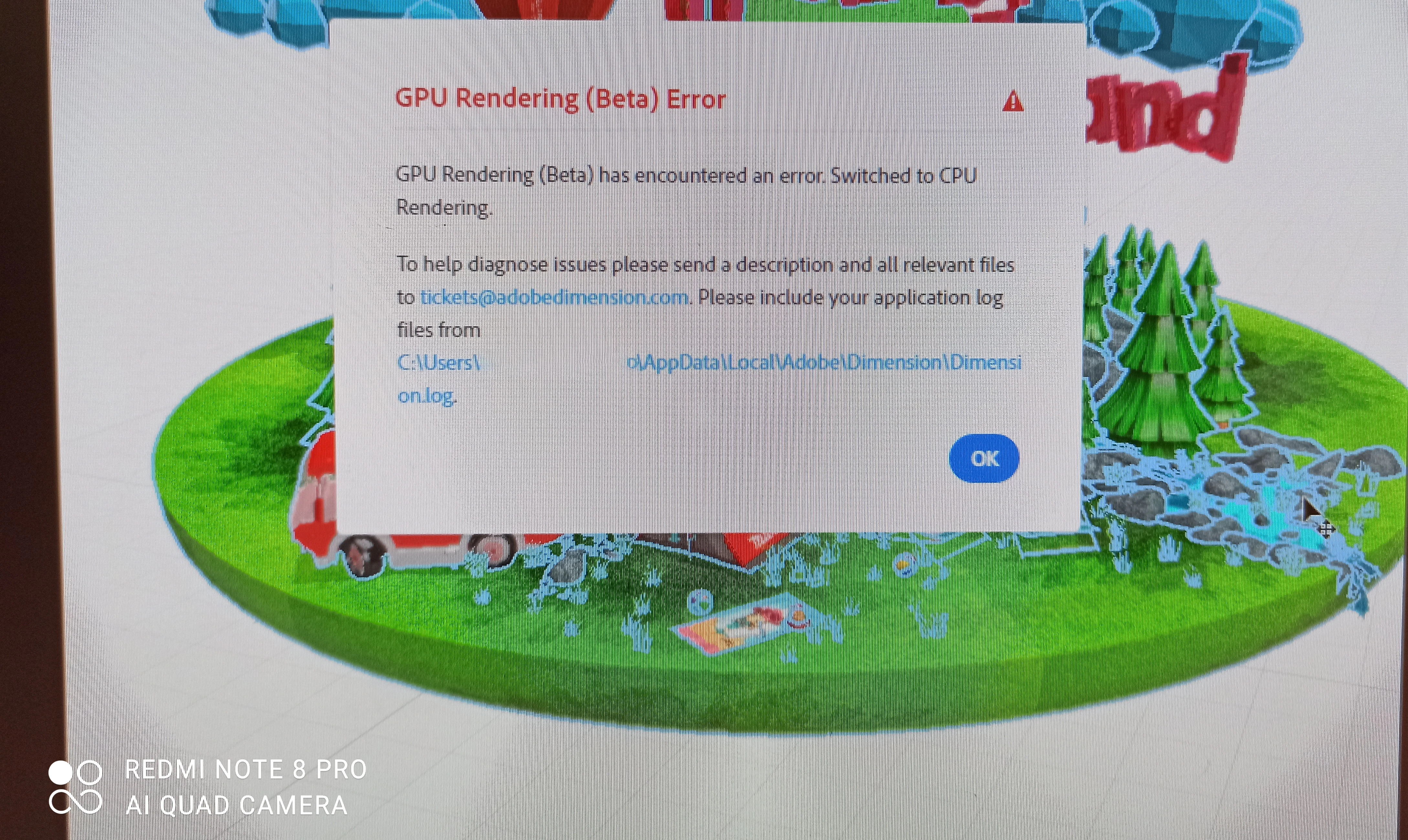

Ok yes in that case your work sever is set up incorrectly to sync in real time and it's only a matter of time before hardware starts to fail with the SSD drives going first but that doesn't really have anything to do with Dimension
The error you posted is because the file remember settings and the way you are working doesn't allow for the difference between system hardwares when opening and rendor is hardware dependent

after long tests in various ways on 3 computers, including one corporate and two private ones, I came up with the idea to create a new document in a lower resolution of 180 dpi and import an earlier file that did not open and here again a lot of tests because the administrator blocks some of us at work capabilities. I disconnected the company network from the computer and moved the file locally to the disk on the computer because at work we use a server on which we make daily backups after work. This made the 8 GB file open much faster - in 3 minutes and earlier on the network up to 10 minutes. At home, on private equipment, unfortunately worse: windows 10 pro / 16Gb Ram / NVidia GeForce GTX1050Ti / IntelCore i5, I imported the file into a new document and disconnected the internet network. The file was imported and everything worked smoothly, only the render process was quite long but nevertheless everything worked. I have Windows 10 pro / IntelCore i9 / Msi RTX 2070 GeForce / 32 Gb Ram at work. Yes, the file is quite complex, it has a lot of objects, but after this test, the rendering process opens and works - today in the morning it showed a problem - a photo from the phone :). I don't know how much it will work, but so far this scheme is working.

Hello, I have a question modeling a model with multiple objects in Adobe Dim - the target file reached 7.8Gb size, works normally, everything renders correctly, but after saving and closing and reopening the file, the layers are loaded, but unfortunately the workspace is empty?

What is your OS and system parametrs? Try to seperate total model and import it part by part if it possible. May be that can be the problem with 3d model complexity. Can you share file to test?
