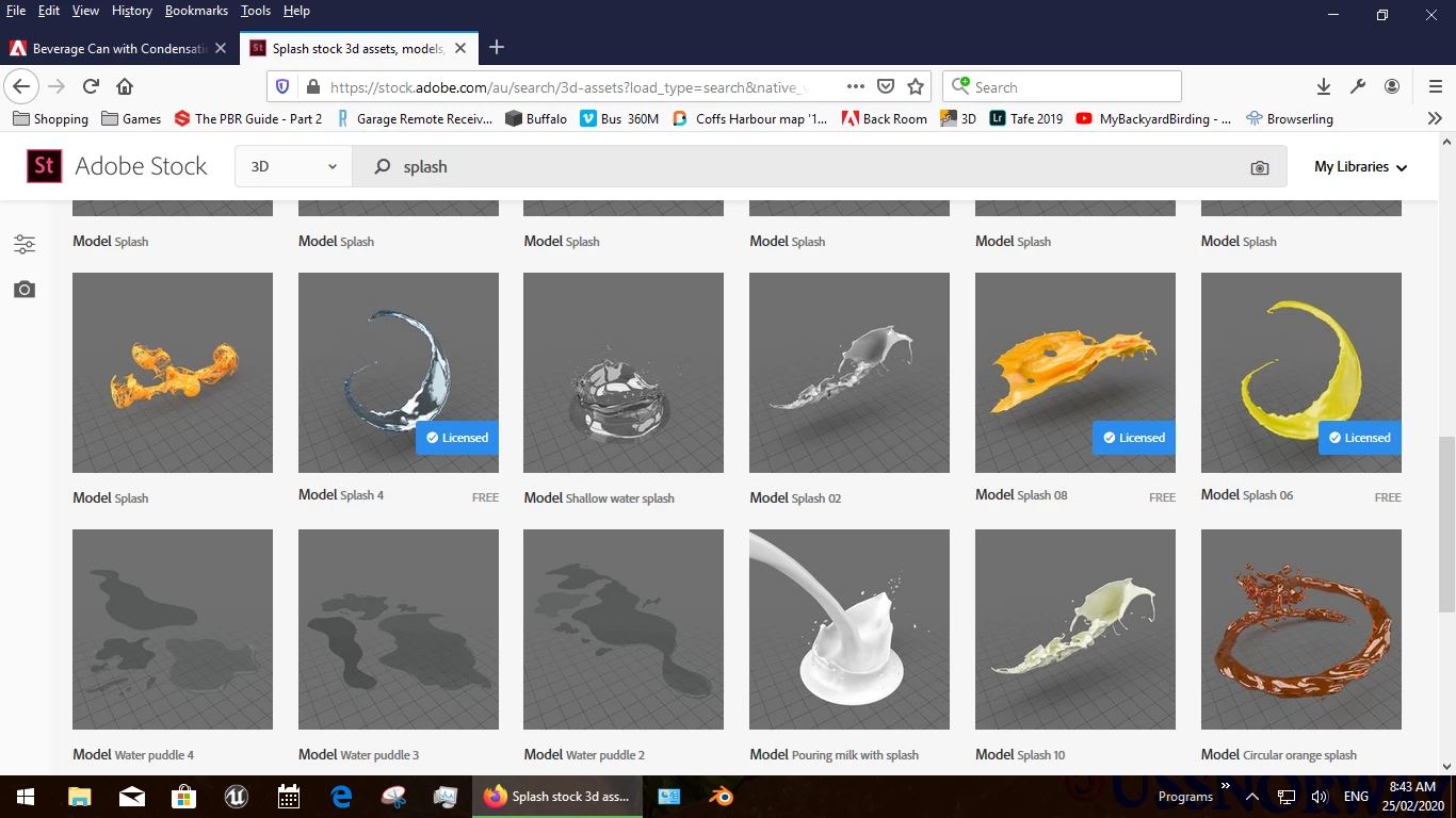

the water on the can is a sub model that can be removed or exported + you can make your own useing parts from Adobe Stock... note Free models are marked if you don't want to spend cash

So how did you end up with those droplets over the can? By modifying the splashes found of Adobe Stok into smaller pieces and placing them on the surface?

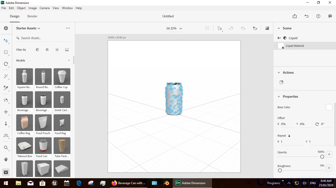

the drops in my screenshot are part of the 'can with condensation' model in starter pack i.e, it comes free with Adobe Dimension
when you drag / drog that model into Dimension scene you will notice it is actually 2 models... one is the can and the other is the drops
you can adjust these drops for use in other models... for myself I like to add them into many of the glasses i have made over the years to get a fizzy drink effect
