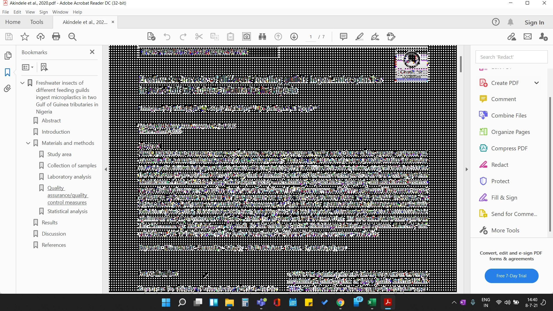

Aug 4, 2021 8:24 AM UTC
I am facing the similar problem.. screen turning black on clicking. Read through the chats, Choose "Troubleshoot Compatibility."; this step is boggling me.
I am not at all a tech person.
Help me out.
Ussnorway7605025
Aug 4, 2021 11:23 PM UTC
your issue has nothing to do with black screens so please don't post me too... apart from being rude it also makes it hard to see because old threads get sorted in a different way
anyway you gave a screengrab [well done] and it looks like the sharpening globally nvidia issue
https://community.adobe.com/t5/dimension/experiencing-strange-screen-behaviour-with-mouse-hover/m-p/12081773#M5550
