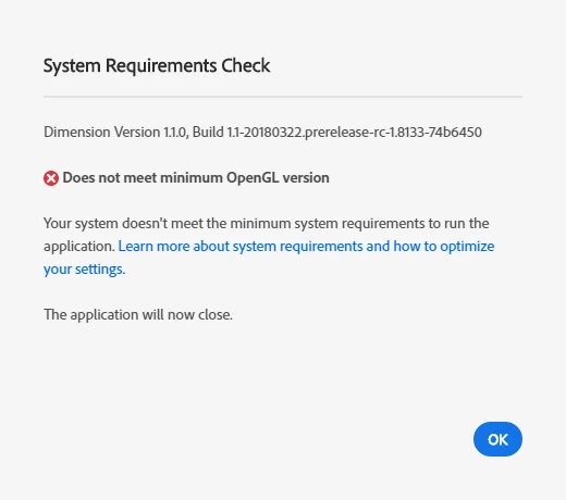

Can't start Dimension CC
  • May 14, 2018
  • 24 replies
  • 12447 views
When i go to start the application it says: "Does not meet minimum OpenGL version".
And thats not true, i did a full system check just to be sure but i do meet all requirements:
CPU - i7-4790k
GPU - GTX1080Ti (driver up to date also)
RAM - 32GB
OpenGL - 4.6
So... please send help?

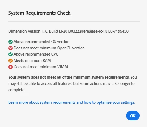

Ussnorway7605025
May 18, 2018
imo the two issues are not related; the openGL always gets it wrong on Windows systems and makes no difference to the software so something else is blocking the start up ... here is my report for ref

Just as a note, this is incorrect.  We have a hard block on Open GL 3.2 and won't allow you to open the application if you're below that (the dialog he showed states that the application will now close).  It's interesting your system check is saying you're below but still running, actually.  Going to have the engineers double check this area since this is unexpected.
Windows + updated Driver = "does not meet minimum OpenGL version" error message
I assume its because we don't use the approved Microsoft driver... I would try the prerelease build which should ignore this error and see if that solves your block
LuckrowAuthor
May 16, 2018
I did download and installed the prerelease build and the problem still persisted...
