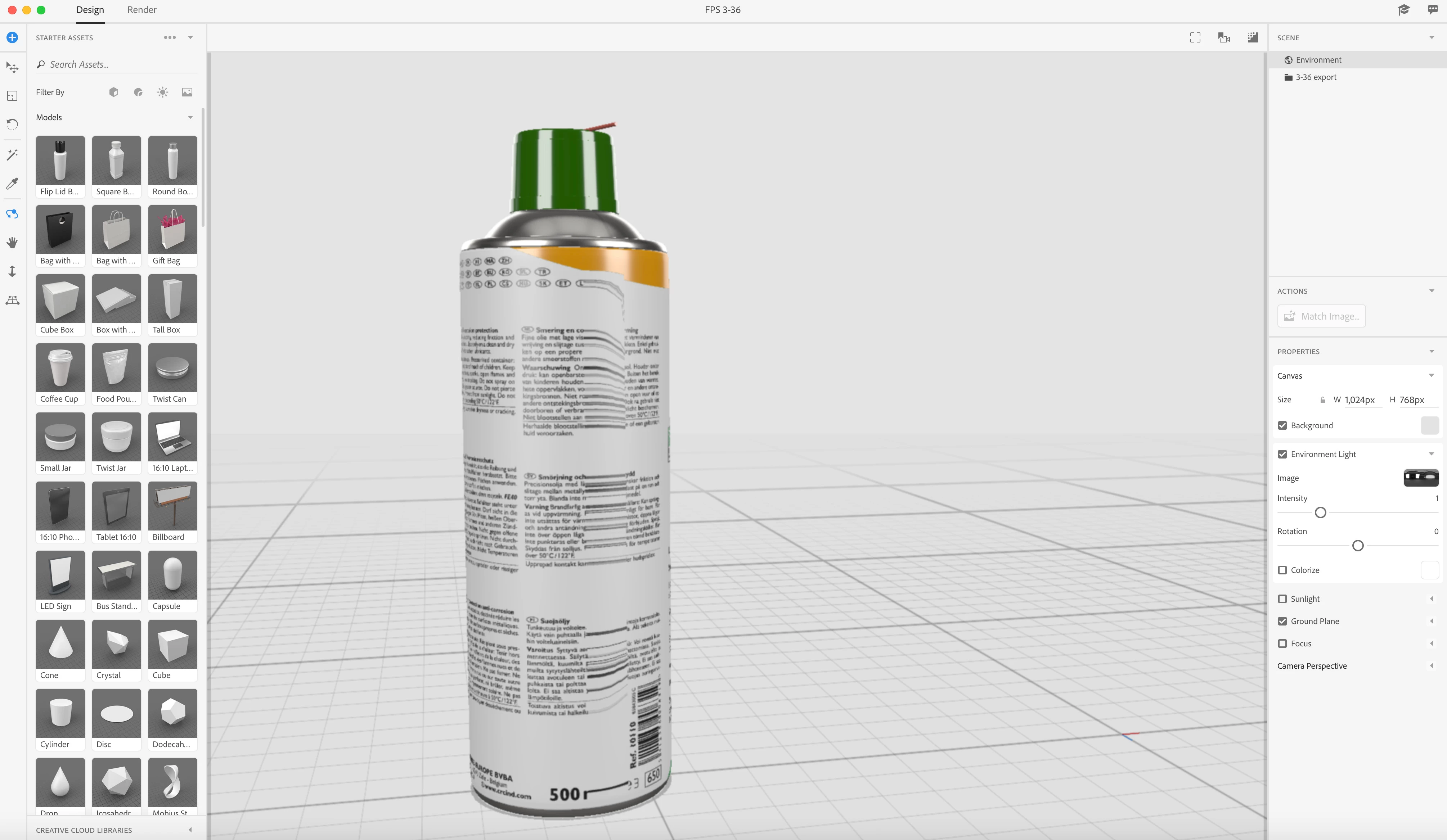

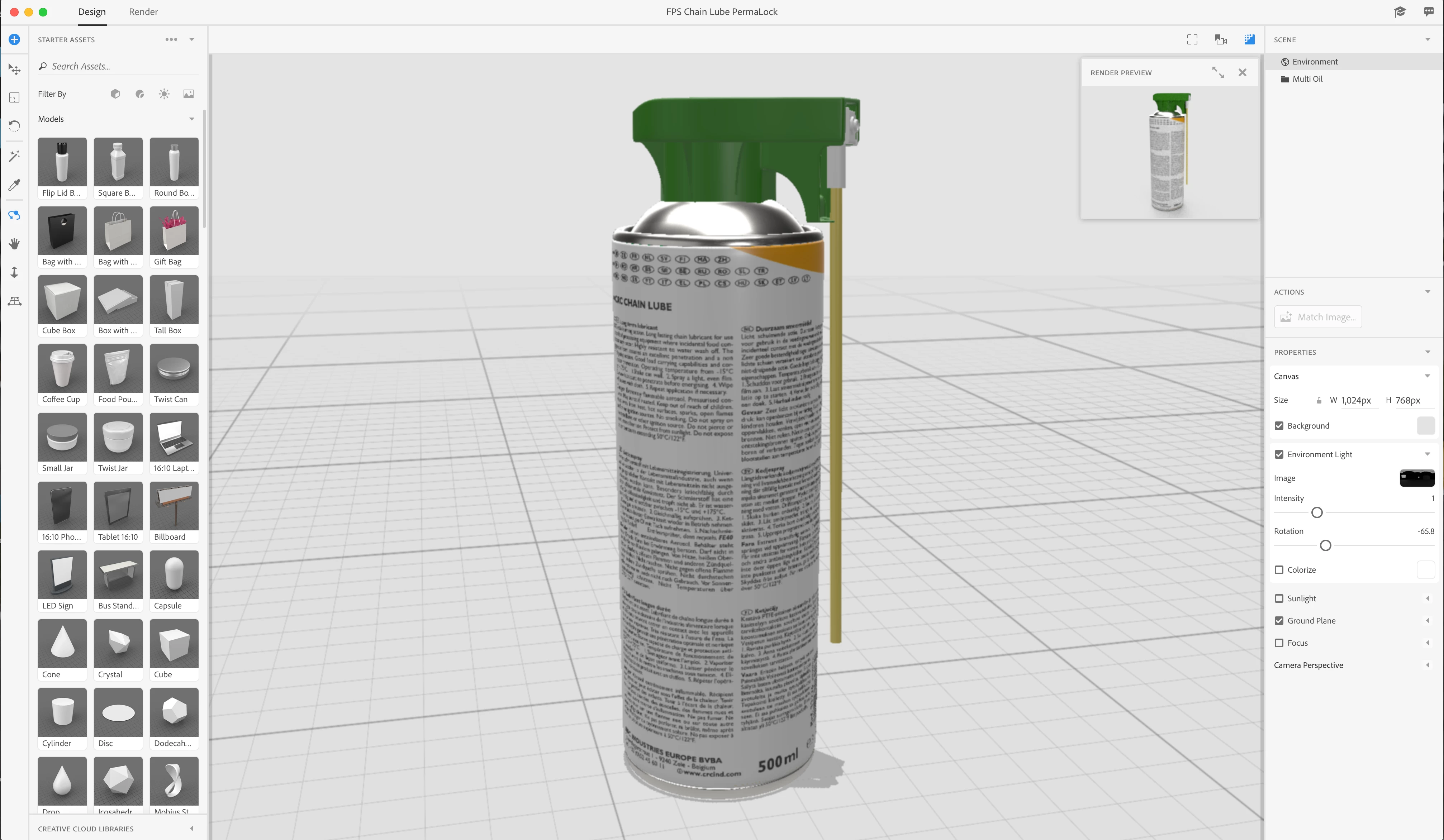

Hi everyone,
I'm trying to mockup packshots in Dimensions. I had some testruns and it comes out OK.
Now however, i have another button on the can and the green colour changes pretty badly. As you can see in the first image, that is more correct.
It's been a while since the first testrun and i'm not sure if i changed the colour settings to RGB/CMYK. Could this be the case?

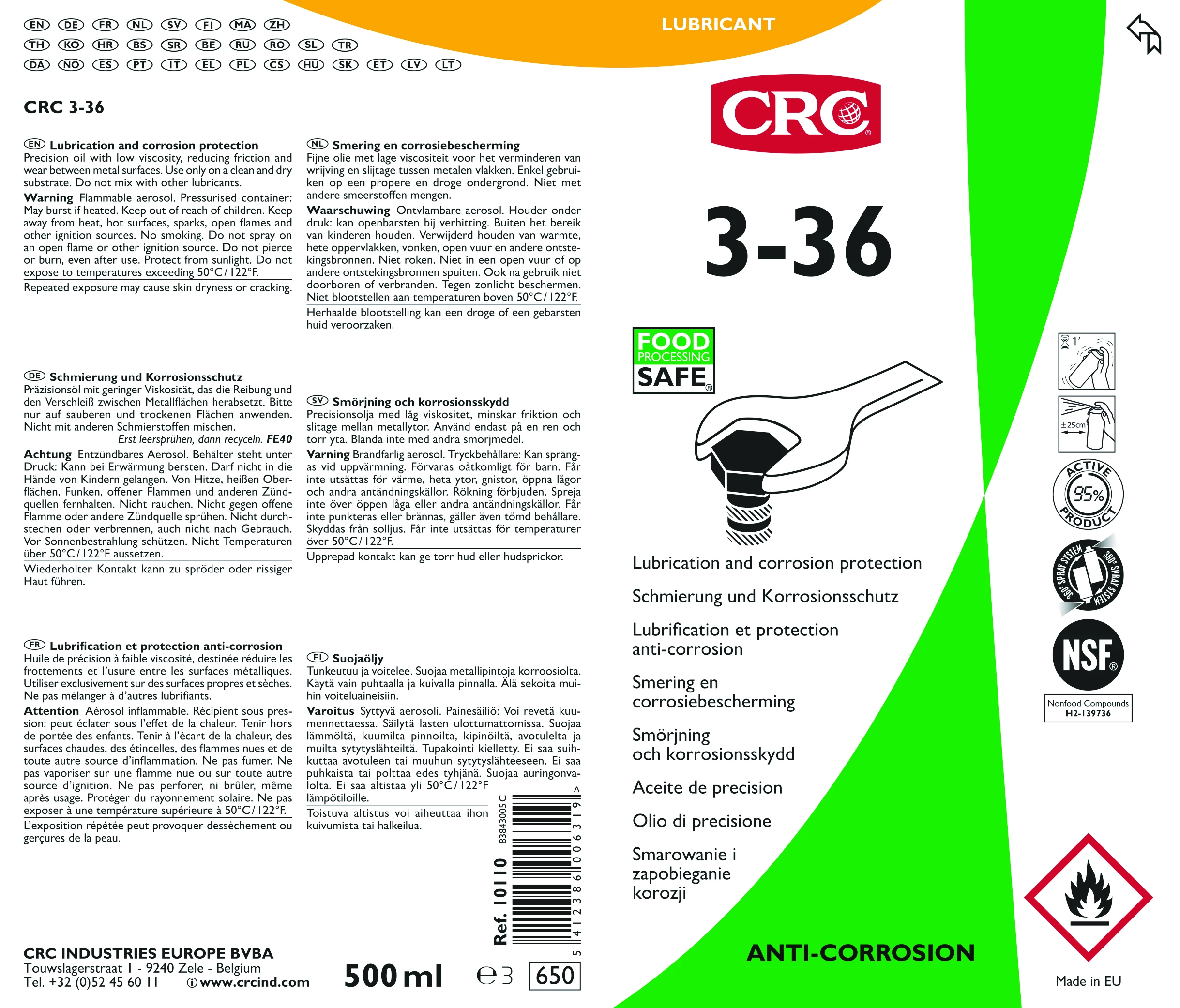

The file in the decal:

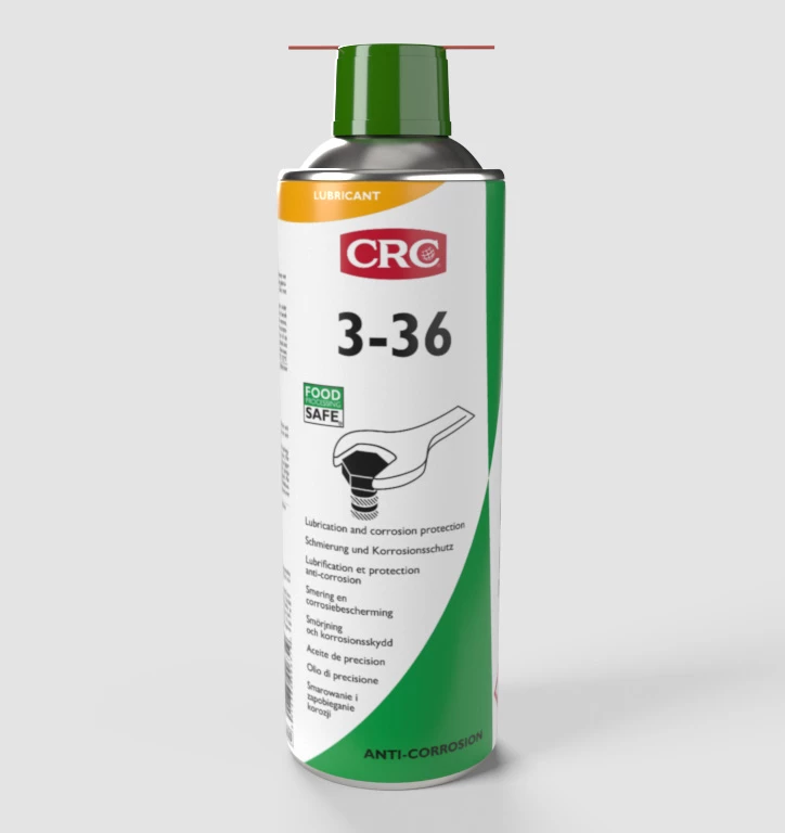

GenAjaxCorrect answer
May 14, 2018 1:02 PM UTC
In response to my own question:
I've changed the settings from CMYK to RGB in the original file (decal) and now the color seems to be correct!

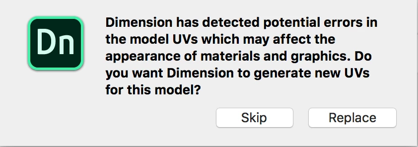

However, on this can i have this issue on the back:
This model is different from the one with a different cap. We get our 3D models supplied.
Did get a message saying:
I chose Replace.
Would you recommend using one single file/object, and just place the caps on different layers and turn on the correct one each time?
Or how can i go around making sure errors like these don't happen?!
(The other one that doesn't has this issue)

JeanetteMathews
Adobe Employee
Adobe Employee
May 18, 2018 4:38 PM UTC
We're going to work on adjusting the UV error messaging flow.  The problem is that it's a potential error.  it could be perfectly fine.  I would recommend skipping first and seeing if your UVs work as they were given to you, then if there is an issue you can re-load and try the replace flow.
This particular dialog shows on 3 detected issues:
  • If you have UVs that are out of the 0-1 space.  In UV space 0-1 is where the texture is and anything 'outside' of that space is repeated.  It's not inherintly wrong to have it out of the 0-1 space but is most usually unintentional.
  • If you have UVs that are overlapping.  UVs that are overlapping can't have different textures applied, they will always have identical textures for whatever UVs are overlapping.  Again this isn't wrong and is often used by artists to save UV space, but often it also comes from having jumbled, bad UVs.
  • Finally it checks for large pieces of the model that have very tiny or stretched UVs where textures would look particularly bad.
We're going to try to remove this dialog at import and make it a bit more clear when an actual problem is found.  Potential problems are hard to message!
