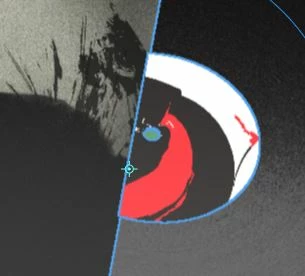

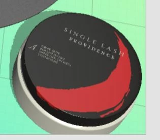

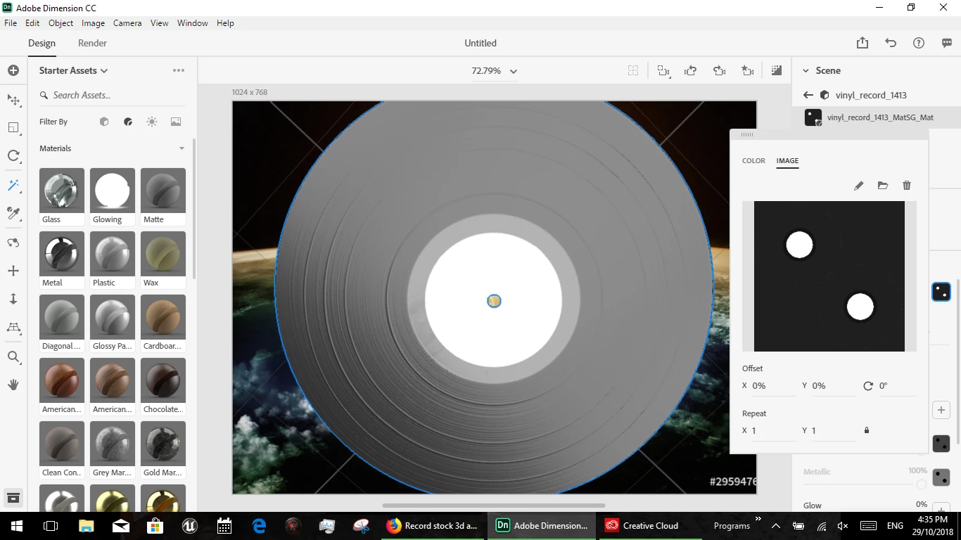

Yeah, it seems like that is what is happening, but only sometimes. Here's a couple of screenshots.
The first image shows the full on distortions. The second image shows my image on periphery before the distortion occurs. The third image is more of the full on distortion that occurs whenever my label starts to reach the center of the model. I included a 4th image with my file on top a jar so that you can see how the image should look on a circular object. It definitely has something to do with the punched out hole in the middle. Dimension always behaves strangely when I start to get my image centered at the punched out hole area.
Is this something that I can correct within the program or do I need to open the file in some kind of modelling software. I'm very confused. This seems like something pretty basic with a basic solution.
Thanks for the help!

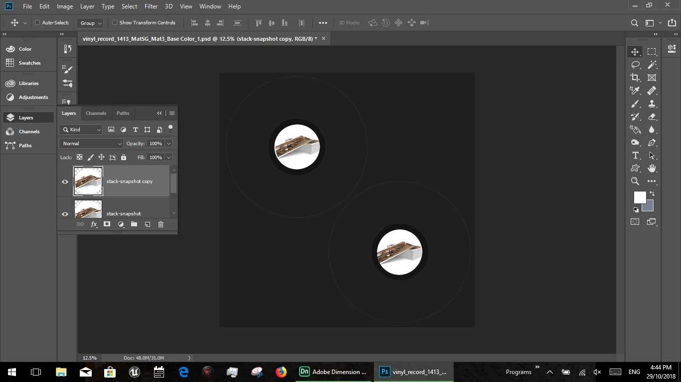

Ussnorway7605025
Oct 29, 2018 5:54 AM UTC
that looks like its on the model it self ... as for how to fix it;
I'd open the image map in Photoshop and edit the layers (assumes front and back sides)
then rendor at a 1:1 scale... you may still need to punch the hole out after in Photoshop again... it just depends on the look you are going for
Nov 1, 2018 6:21 PM UTC
I have the same problem as the OP - it happens with CD and Vinyl obj files - basically anything that has a hole in the middle.
Thanks for the suggestion - it works!
A good temporary fix, for sure.
