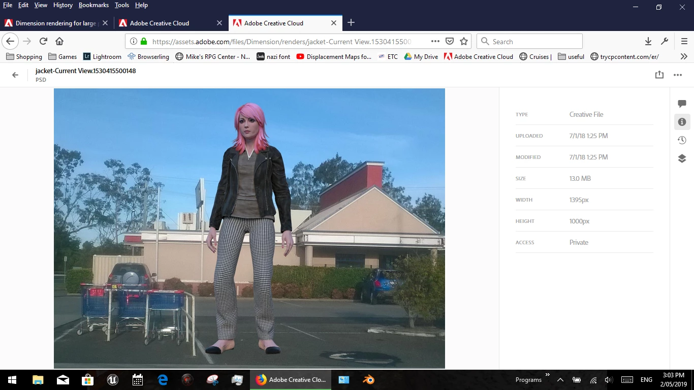

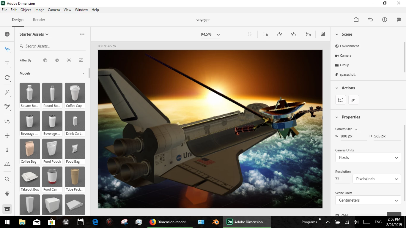

    Dimension rendors at the canvas size you set... 1024 X 768 is just a default and the fact that you have it showing inches, yards or meters isn't relevant because they are fake units
    two examples are 800 X 565 & 1395 X 1000
