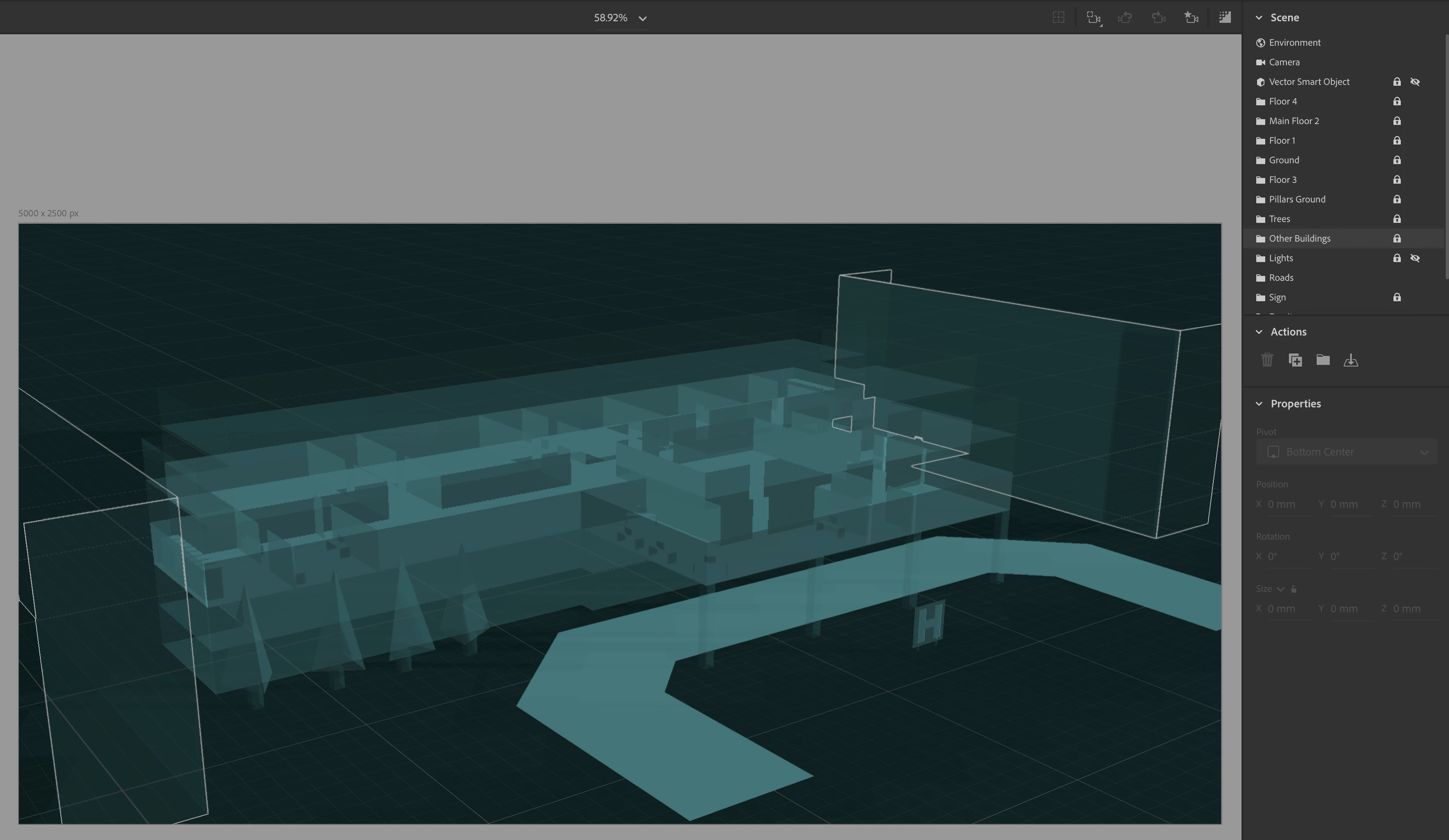

I created a floorplan in Dimension. Using a mix of simple cube, pyramid and plane elements.

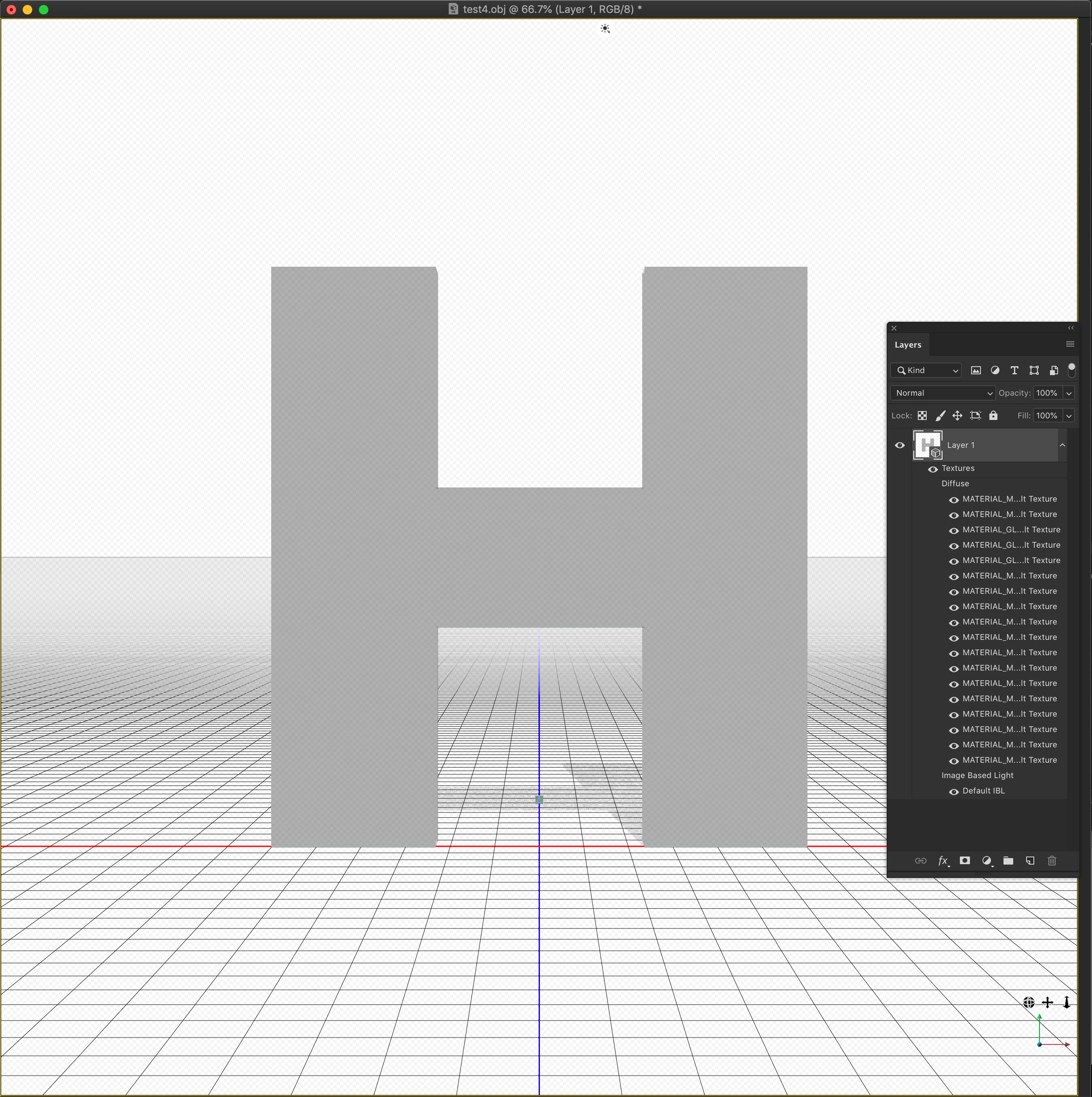

I need to convert the file to an OBJ, but all I get when opening the OBJ in Photoshop is the H, which itself was imported into Dimension. When deleting the sign first and then exporting – I get a weird cube.

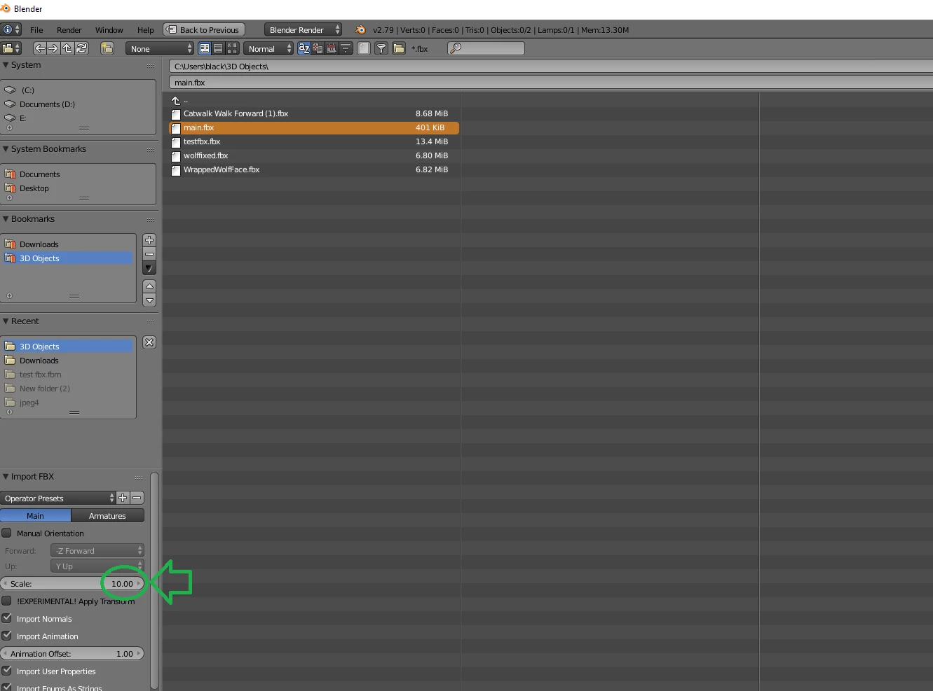

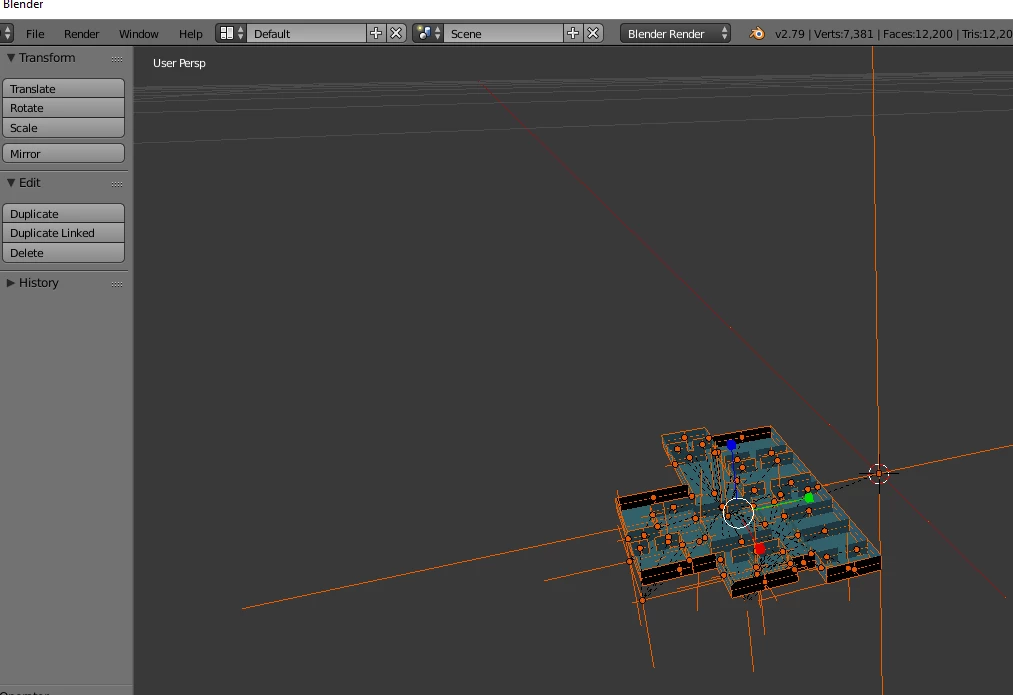

now that the model is an Fbx we can open it in Blender (again free) and I recommend uping the scale to 10 because the convert to Fbx strips out your starting scale i.e, the model is very small
at a scale of 10 you should have no issues so go ahead and export that from Blender as a Obj file

Hello.
Yes happy to – doing some tests, we managed to export single models from the normal sample range. but as soon as you add 2 planes, a cube (geometric cube) and a pyramid, all elements just get bundled onto a heap, and they don't keep their coordinates or places.
I was really looking forward to the prospect of OBJ export since it was announced as a big feature. All I need is to get this scene somehow into Cinema 4D for further development.
here is the file –
