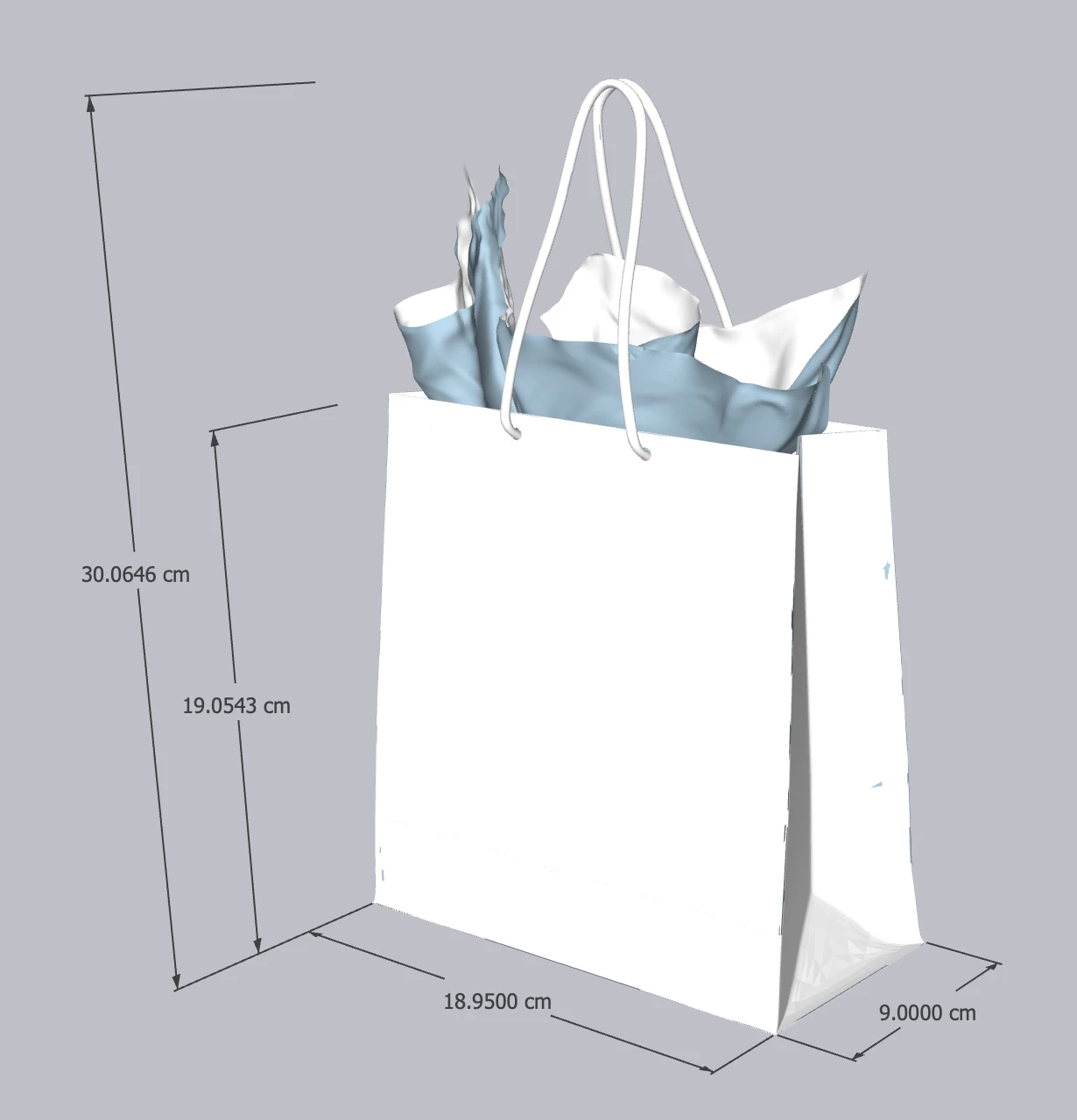

I made the bag with the sizes you gave, and took the model into SketchUp to measure it. It did come out slightly shorter than it should, not sure why (thought there seems to be a bit of rogue geometry at the back of the bag), but the height was very close. Could it be that they include the handles in the height, and you weren't expecting that?

Wow, kudos for going all the way. But, from your trial, clearly the handles are included in the specs for the "bag" itself. And, even more bizaare is the odd with (at least that should be 20cm). For packaging design, this just makes no sense.
Really appreciate your test. I'm just going to stick with crappy flat 2d mockups in Illustrator. But, clear proof that these specs are way off from reality. Cheers! I'm not crazy. Hahha. Really, thanks.

I'm reasonably sure that Dimension doesn't know it's a bag. If you wanted a 6 foot tall wizard, with his usual pointy hat, Dimension would give you a 6 foot model featuring a 5 foot tall wizard.
