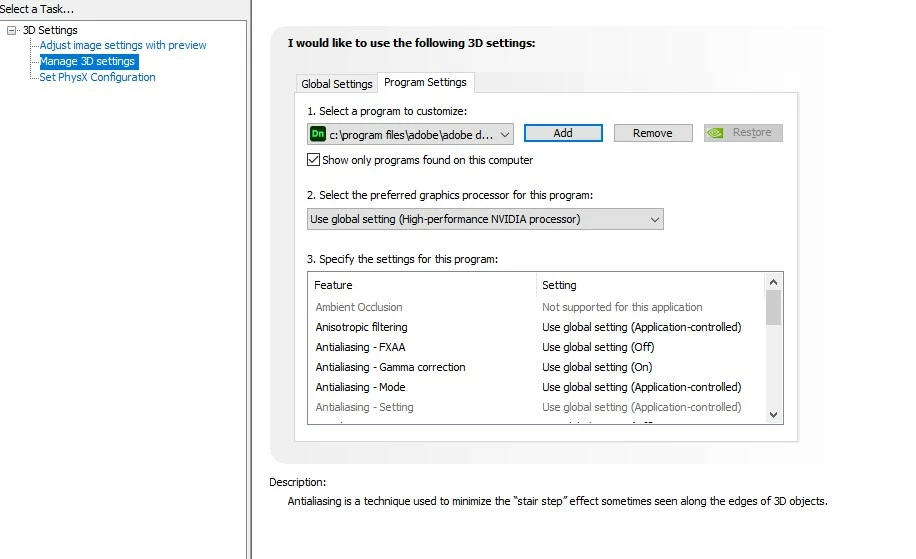

    mostafa omar mahmoudCorrect answer
    Mar 11, 2021 12:21 PM UTC
    I fixed mine through NVIDIA settings GT540M, hope this help
