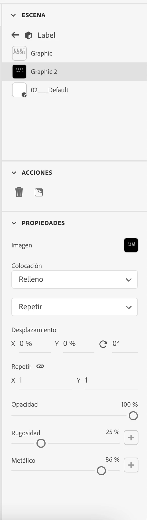

Sorry to hijack this post but oddly I was coming on to ask exactly the same question I think?
I to have a product tub with a label that has metallic/foil print on it so I need to give a metallic finish to part of my label.
I have attached my project file which just the label with a black background and text positioning. I tried to duplicate the text layer as a png over the existing label with the hope of giving this layer a metallic material thus hopefully creating a metallic text layer I could overlay on the existing label. This obviously doesnt work because I can't make the text layer an object I can add a material to, so I'm a bit stuck.

Please correct me if I'm wrong but you are trying to give the text a Metallic finish? If so, you need to double click over the model on the layer section (not the folder but the box icon with the "label" name inside it).
Once you double click on your model you will be able to see the layers inside it, select one of the PNG layers, and on the bottom right. you will the properties for the layers, there you can give both layer a "metallic" finish.
I'm attaching here the examples, I apologize in advance as my UI is in spanish, but is right there where it says "Métalico".
