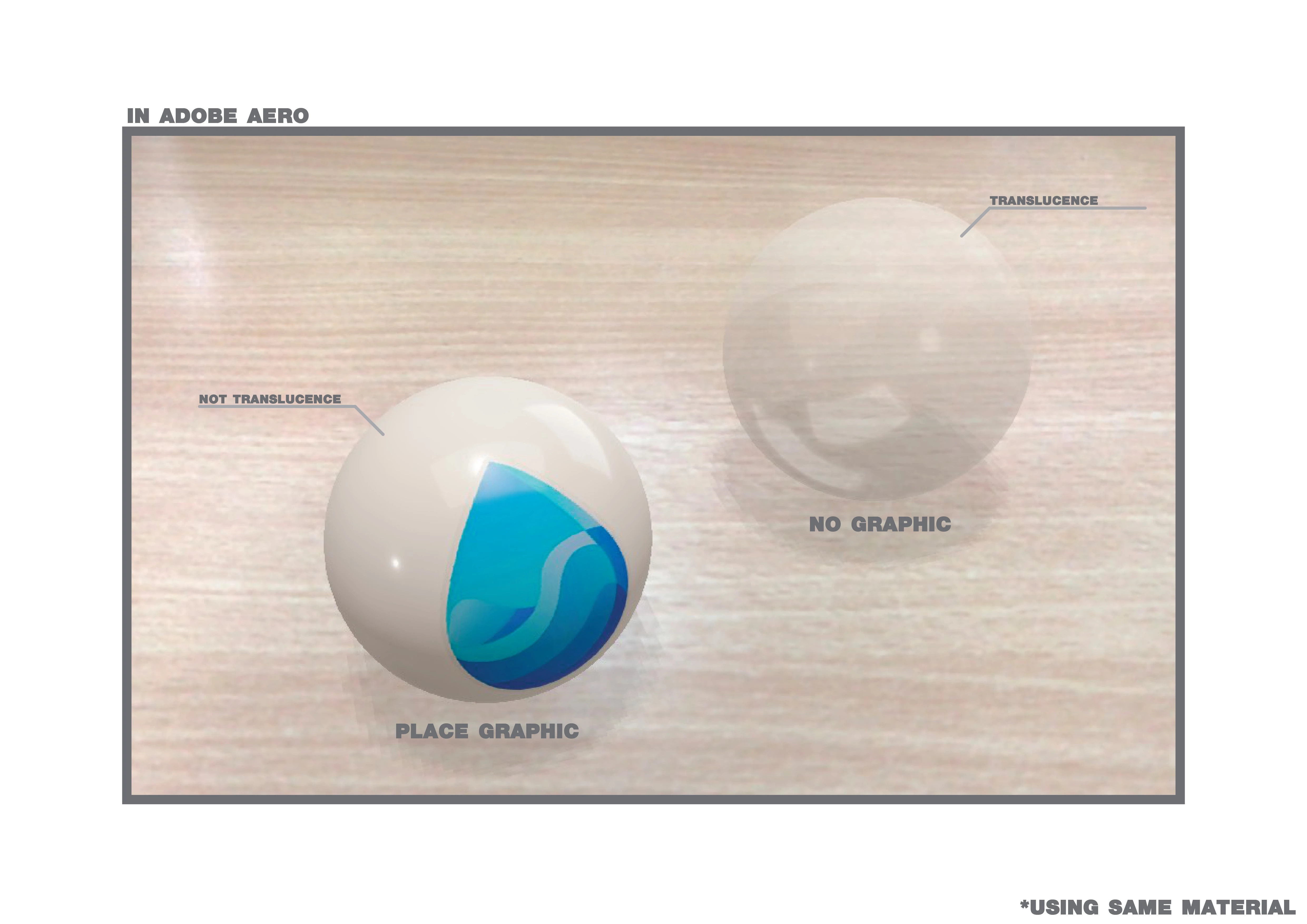

Me and my Team using Adobe Dimension for packaging presentation. The program is easy and make an amazing and beautiful rendering picture. But I want to create an advance presentation.

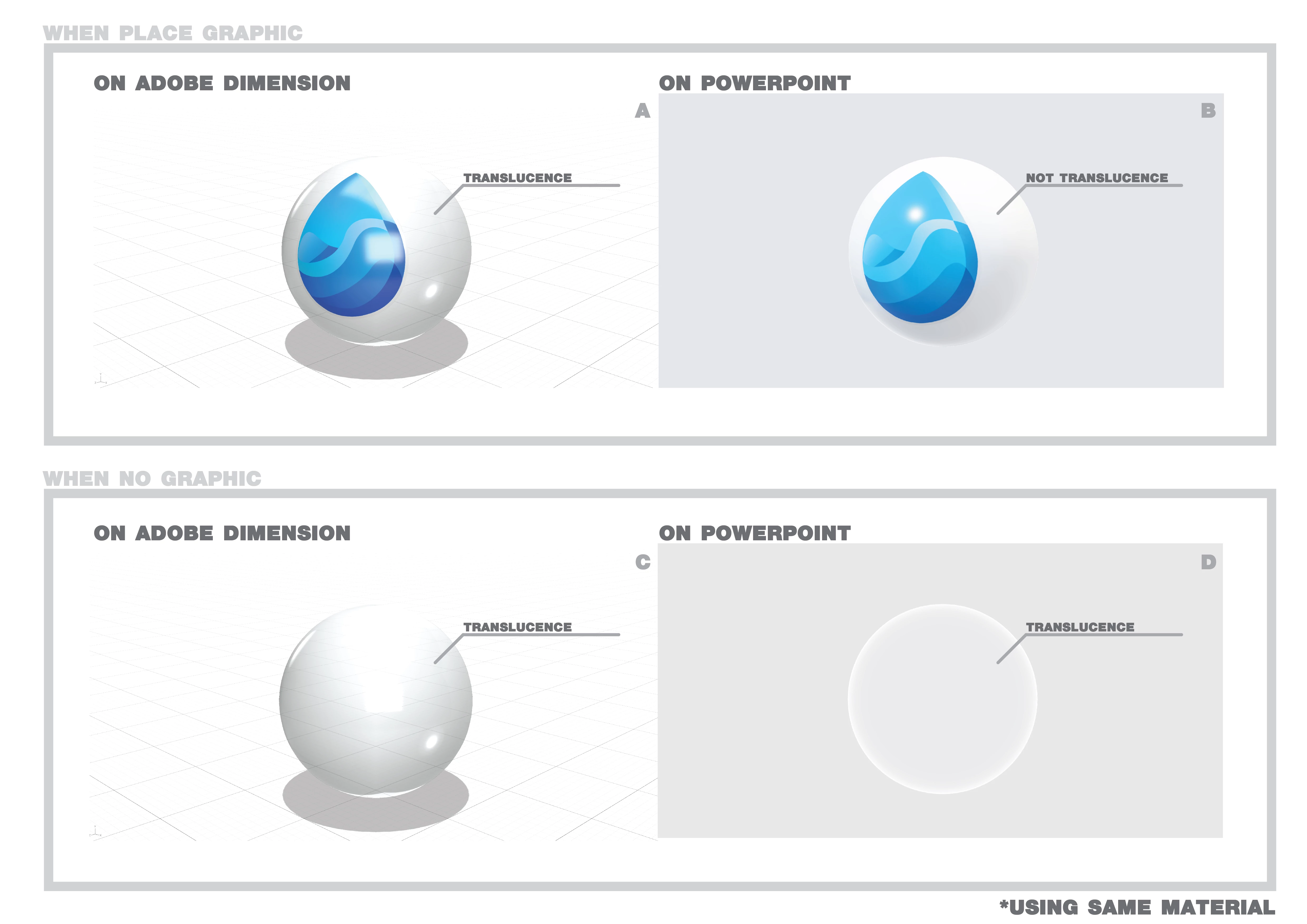

So I use .GLB format file from a program sent to Adobe Aero for making an AR and import to Power Point for making 3D presentation. I found some problem. When I place graphic on the translucence body like glass material. When it show on Aero and PowerPoint the transparency is disappear, But the glass body that not place a graphic still translucence.
Me and my Team try to do many way but can’t solve it. I want to asked to Supporter did you have some special technic or solution ?

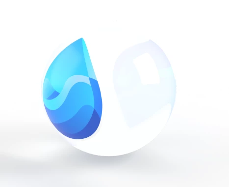

I've just tested this and to take any other apps out of the equation, I tested exporting and re-importing from and to Dimension.
When I exported and re-imported using GLB the translucence was not re-imported as a map, in the same way that Base color was  (suggesting it had not been exported that way). Instead, on re-importing, translucence was set to 0%
When I used OBJ format instead, the translucence map was correctly exported and re-imported. On import it looks like this:
I did a bit of digging and there were suggestions the GLB does not support maps for translucence (which would explain why no map was re-imported) but I've not been able to confirm that definitively.
Dave

Thank you for your advice and yes transparency is translucence.
I try to use Dimension on window but it not translucence too.
This time I make the sample picture for easy to understand what I mean.
So what I want it to be is translucence body like D. but have a graphic like B.
