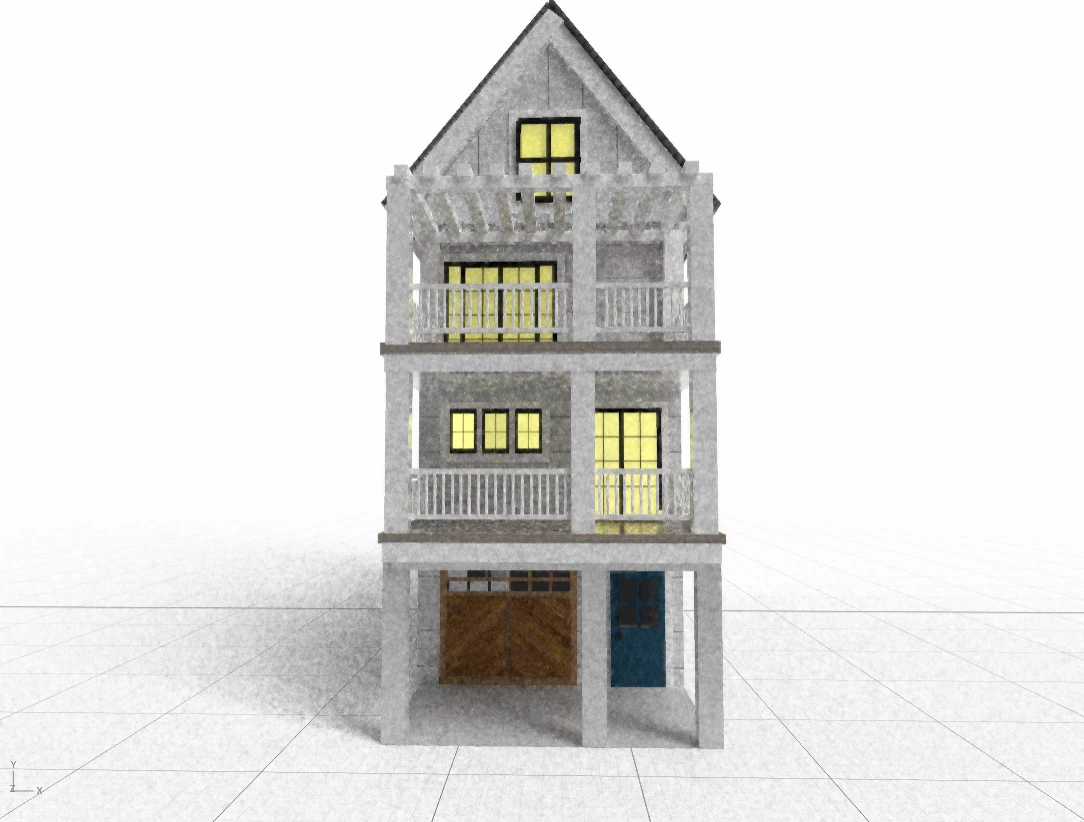

My render preview comes out very grainy. How do I fix this?
Whenever I click render preview, the image is very grainy, like old TV static. I don't think it's the DoF, but I'm not sure what else to try. The resolution is full, and I'm working from a Surface Book 2, so the specs shouldn't be the issue. Any help is appreciated!
Screenshot

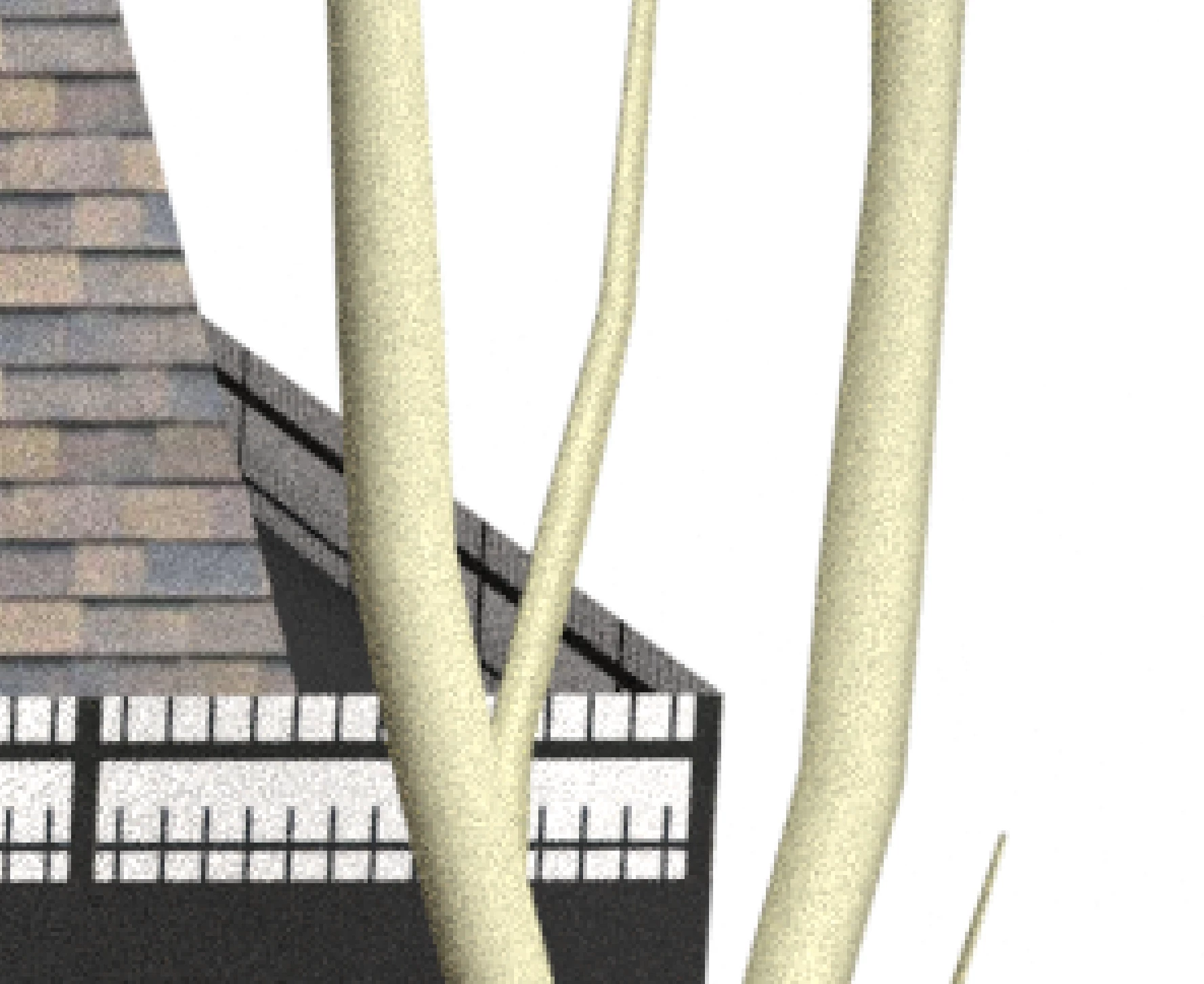

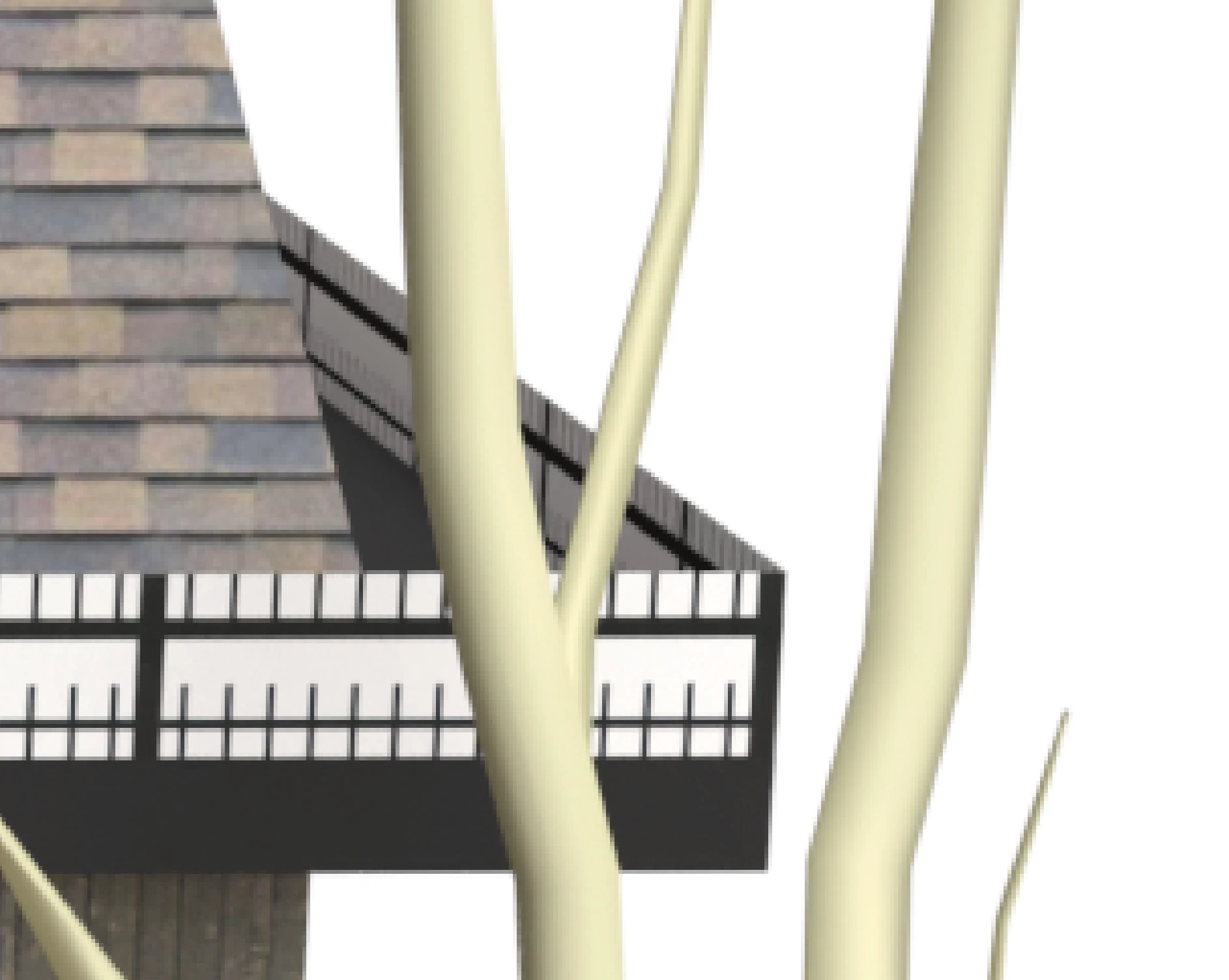

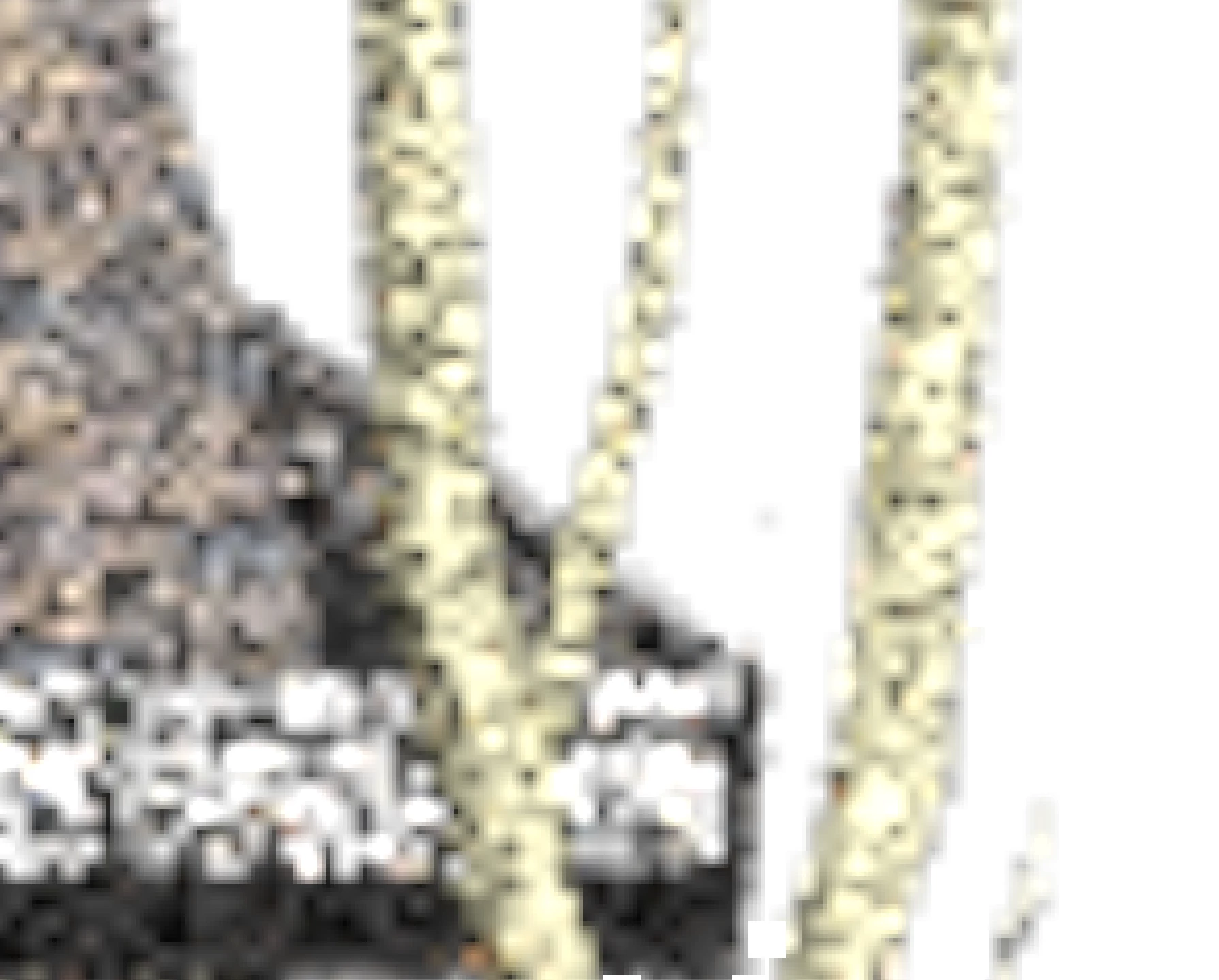

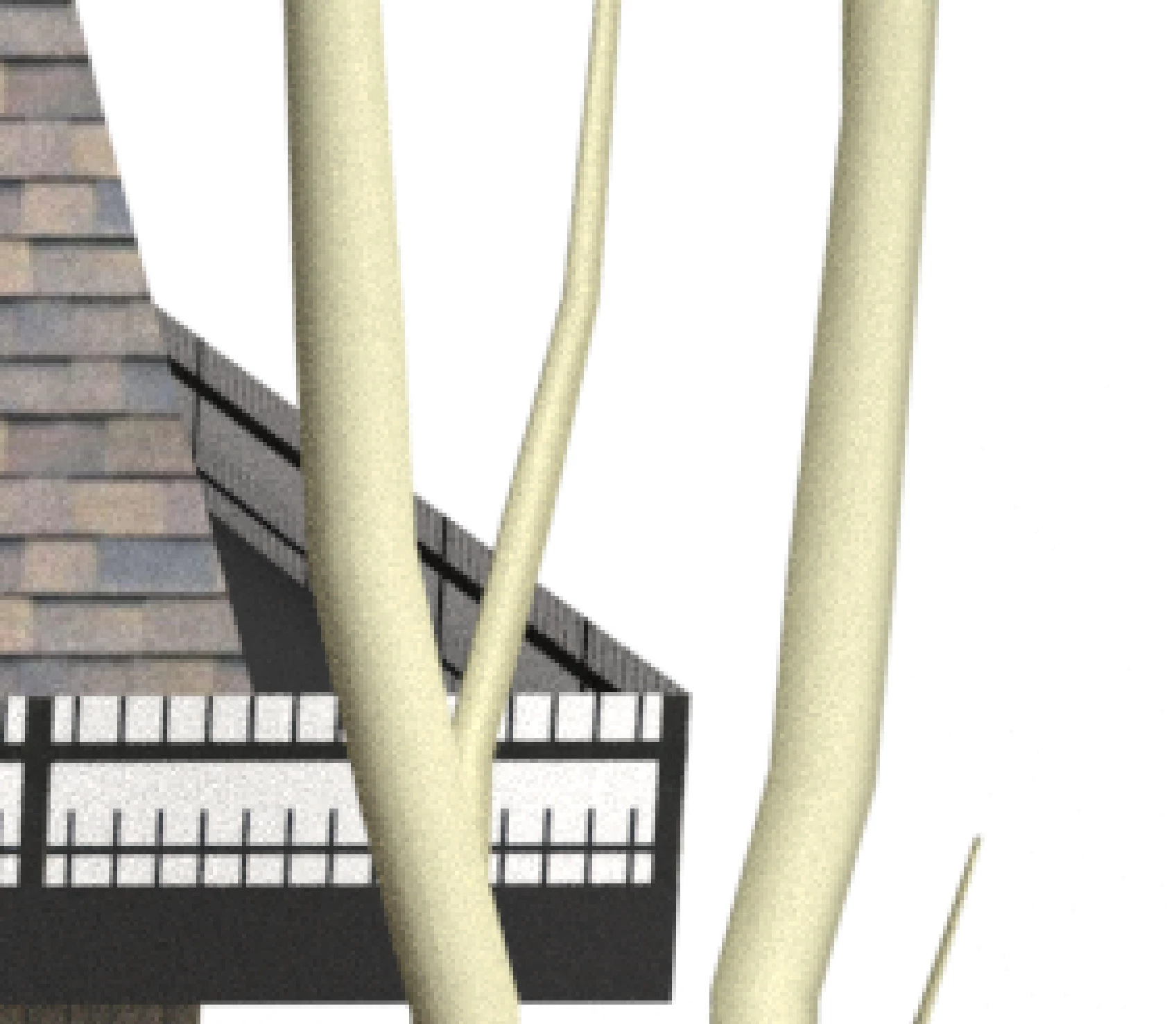

Colin Holgate
Jun 27, 2020 1:23 AM UTC
How grainy things are is usually down to the time you gave it to render. Here are some closeups of a render I did, one image after a few seconds, then a minte later, two minutes later, and 10 minutes later. The improvement even between the 9 minute and 10 minute stages was still noticeable. Would you be willing to post your DN file, so we can see if there is a setting that you're using that leads to more graininess?
