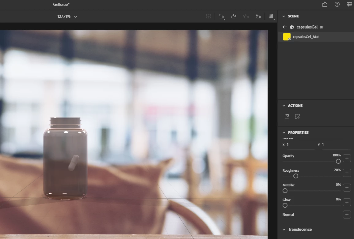

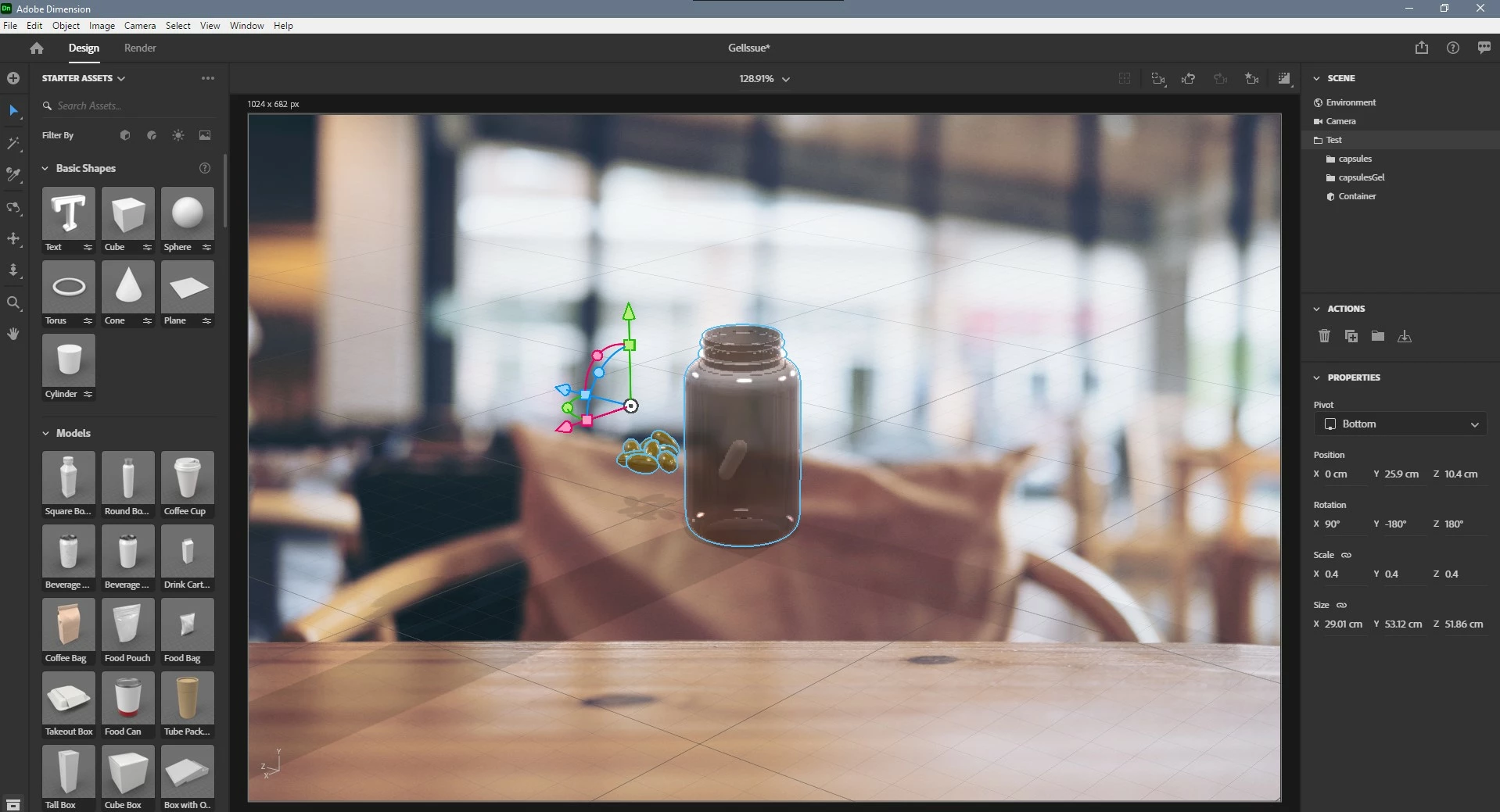

I have a tub object I have been using for a while and usually use it with a capsule object and I can place the capsules inside the tub with no issues. I recently downloaded a gel capsule object from Adobe and placed it in my scene. For some reason when I place the gel capsule inside the tub it disappears.
I have no idea why this could be happening? I have tried a couple of things but nothing has worked, so any help would be greatly appreciated.

dam0bAuthor
Dec 15, 2020 12:12 PM UTC
I tried what you suggested and it worked, but then I did a bit more testing and it turns out it doesn't matter what material you select, its actually down to the Translucense setting. Unless the Translucense is set to 0 it will disappear once placed inside the tub.
I selected Gelatin, that disappeared, I selected Olive Oil, that also disappeared, but when I set the Translucency to 0 they both stayed visible inside the tub. I guess the only workaround is to use the material I want and only set the translucency once I am happy with everything just before rendoring?

dam0bAuthor
Dec 15, 2020 10:32 AM UTC
Thank you for the replies.
@Ares Hovhannesyan The capsule is not the issue as that shows up in basic rendor, its the gel capsules that disappear when you place them inside the tub.
@Ussnorway7605025 so does that mean there is no way to have them show in basic rendor? As you say I can click prerendor and they will show up but I can't place them in basic rendor. It's rather annoying that I don't have these issues with objects i've built myself but only with the one object I purchased and downloaded from Adobe lol.
Also I am using a brand new Mac Book Pro so I wouldn't have thought I'd have any issues with rendoring.
