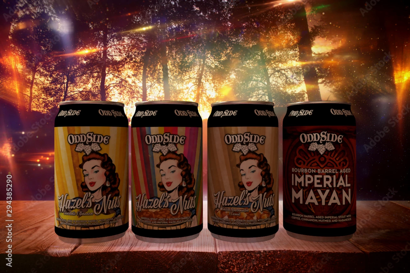

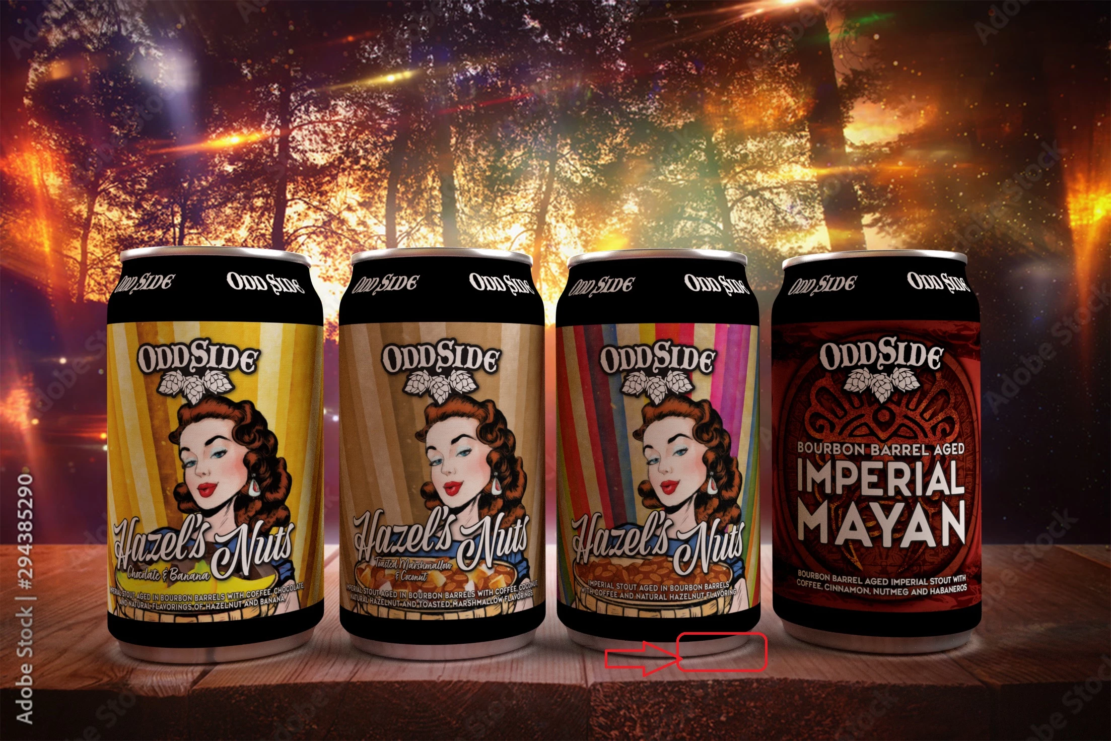

Relatively new to Dimension. I have not run in to this problem yet. As you can see from the attached render, there are light circles around the bottoms of each can. I have relection set to 0. I can't seem to find why they are there or how to fix them?

It seems that the critical value is lights Rotation and Height Values. Try to play with these value for each light.
Also when you are "Match Image" select type of Lights "Outdoor Sunlight" or"Multiple lights". It seems looks beter. Then try to cusiomize lights.
I get this for "Outdoor Sunlight"

Definitely a reflection of the bottom of the can. Try to move the light a bit

the light is bonce back down from the ridge of the can bottom... I agree with Ares
