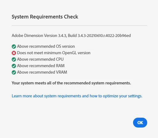

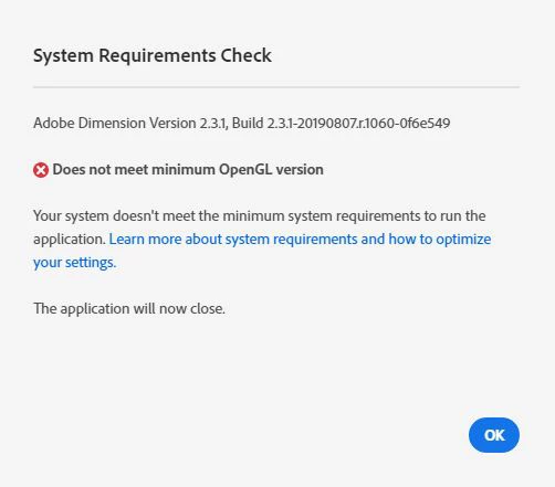

On restart, it installed a Windows update and I’ve not been able to launch the app since without getting the ‘Does not meet Open GL requirements’ error message, and says the application will now shut.

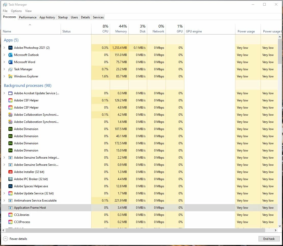

However, it seems Dimension doesn’t completely shut down and appears to run as a background process instead ? This means that the OS still sees Dimension as running, meaning the only way to quit it (in order to be able to uninstall/reinstall) is by ending the process in Task Manager... (annoying).

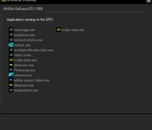

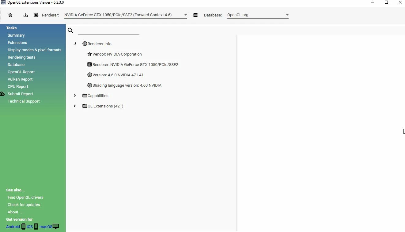

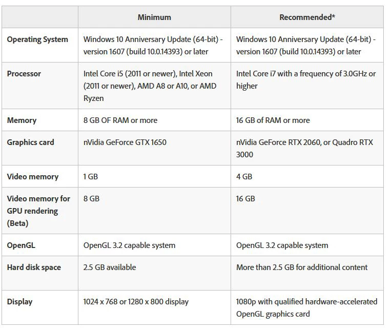

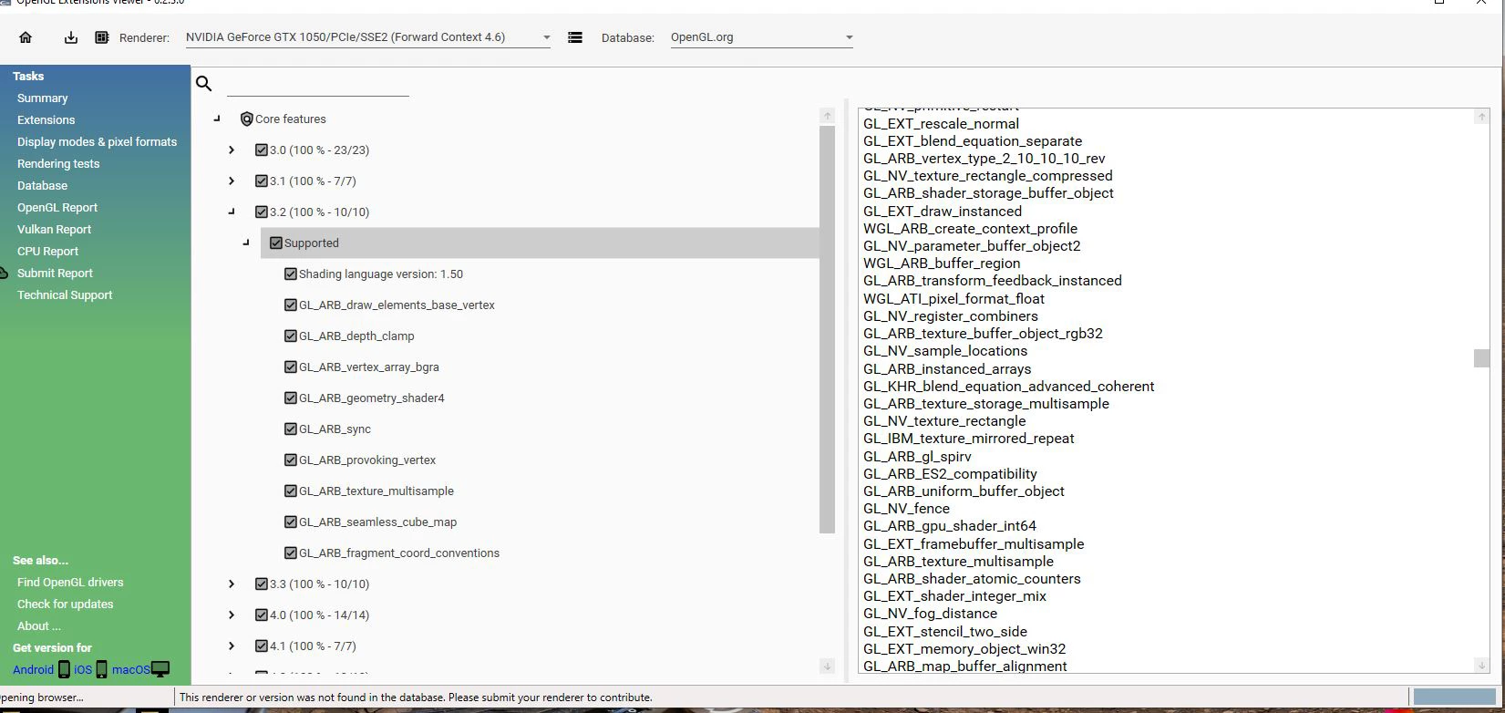

I’ve tried all the fixes suggested (updates to OS and drivers, clean install of graphics drivers, remote access by Adobe Support) with no joy, and also had NVIDIA support look into it – they have confirmed that my card should run Open GL version 3.2 (as it’s running version 4.6) and I’ve also checked this with Open GL Extensions viewer which also seems to confirm it supports the necessary version 3.2.
As far as NVIDIA can tell the issue appears to be that Dimension is not ‘reading’ the GPU correctly ?
