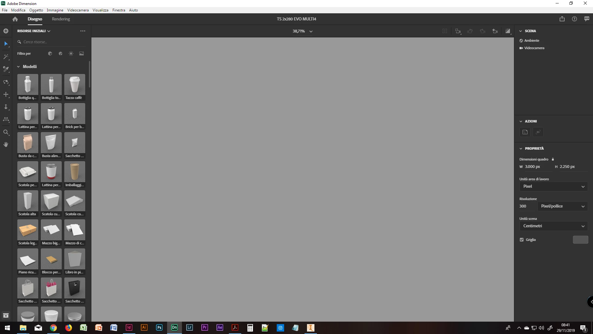

Ciao
scusate se scrivo in Italiano. Purtroppo ho alcuni problemi ad aprire alcune files pesanti. Mi si blocca la schermata e non si apre più niente. Devo forzare la chiusura del programma. Gli altri files più leggeri non mi danno problemi.
Cosa posso fare?
Grazie
[edits ussnorway]
Hi
sorry if I write in Italian. Unfortunately I have some problems opening some heavy files.
The screen freezes and nothing opens. I have to force the program to close.
The other lighter files don't give me problems. What can I do?   Thanks

Ussnorway7605025
Nov 29, 2019 11:09 AM UTC
looking at the screengrab I'd say your system ran out of ram... try closing all the other software first and see if Dimension can manage then
tatianal1918053
Nov 29, 2019 12:46 PM UTC
This morning when I turned on the computer I opened the image and immediately gave that problem.
I've an Nvidia GTX 1070 Ti.
