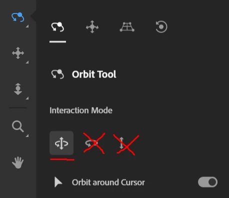

Hi. When I use the Orbit tool I am only able to rotate on the x-axis so I am unable to look around the object. I'm sure it's a setting but can't find any information anywhere to help.

The issue is I am only able to rotate on the x-axis so if I try to rotate to view the object from above or below (y-axis) it won't allow me. I have tried to use the right-hand mouse button to orbit around the object and the orbit tool but either way, I am only able to rotate on the x-axis.
I hope that explains it better.

From what you describe it looks like you've activated the second 'interaction mode' of the orbit tool, which looks the orbit mouvements to the horizontal.
When you right-hand click on the orbit tool, is it the first option that's selected? If not, choose the first one, and it should be better...
