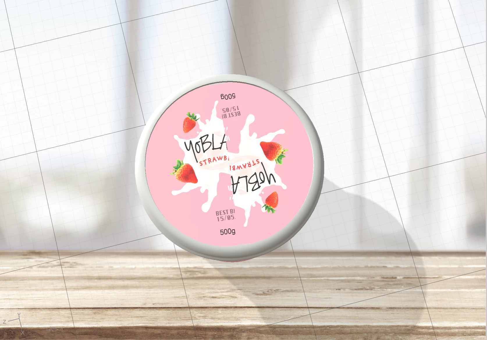

So i've created my own obj model on dimension for a yoghurt tub packaging for the tub and the lid and I am currently struggling to place the decal image on the lid. It seems to have been having a malfunctioning split  and I cant seem to fix it in any way. I've tried googling and youtube but nothing seems to relate to my issue. Is there any way I could fix this? I've placed it in png file, jpg and psd but nothing seems to change.

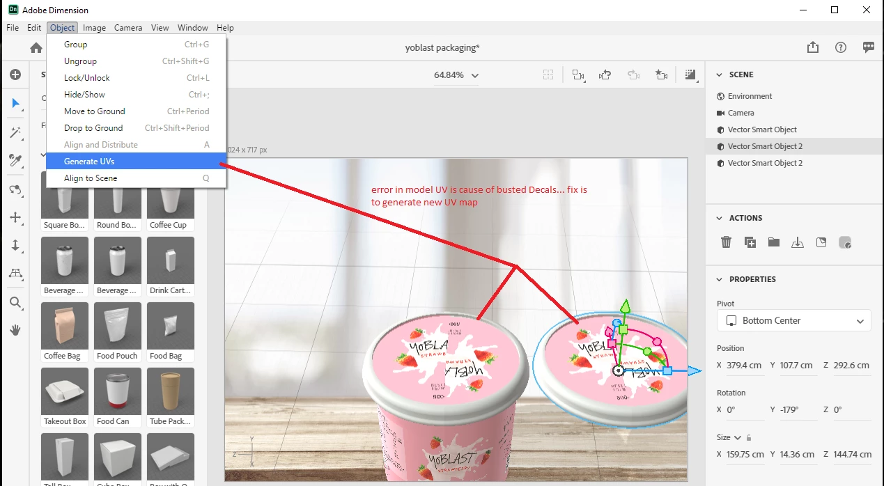

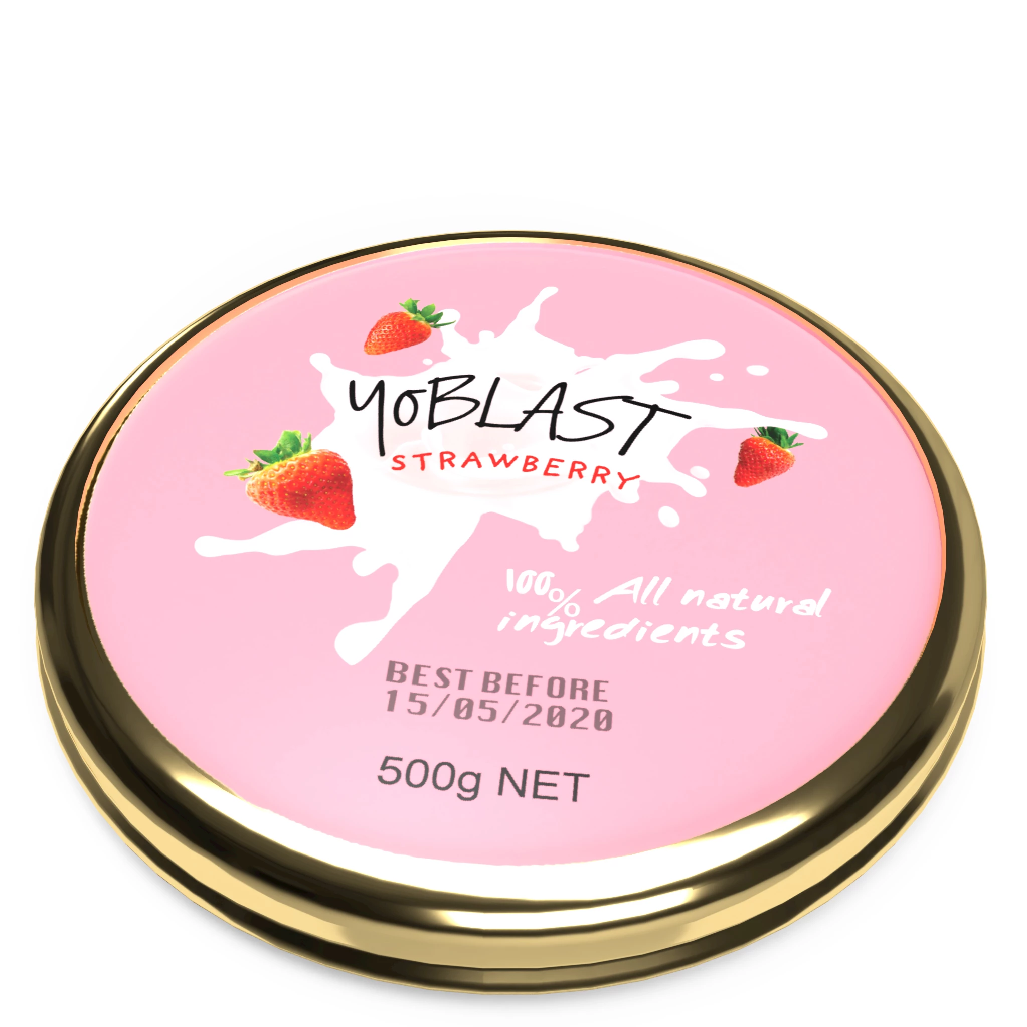

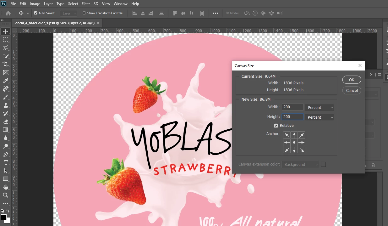

i got your file and have repaired the errors
your file back = https://adobe.ly/2RykcKQ
  • error 1 is the model itself and very common for new makers... its easy to fix by just asking Dimension to build a new UV map

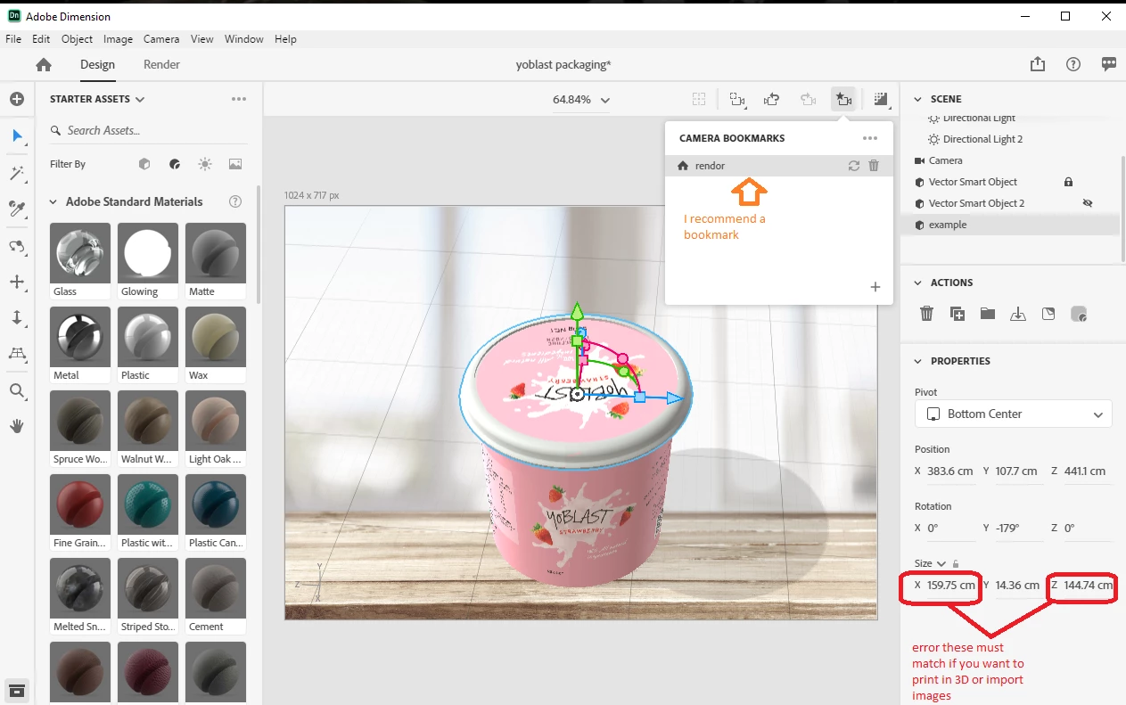

  • error 2 is also common but important because adding a decal to this model will cause Dimension to crash [giving you a BS error message] and will also make any 3d print fail

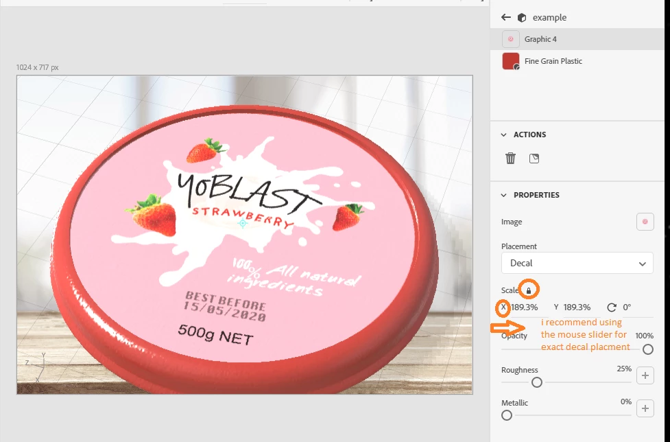

I recommend adding blank space around Decal to save yourself going nuts trying to place them... note i added 200% to the image so the correct placement will be around 180-190% and i use my mouse [with the lock] to adjust this by eye
I also recommend adding at least 1 bookmark so you can move a model around to test and then just click the bookmark to jump back for rendors
final note the pink mark on the front of the test rendor is noise from the model under i.e, the cup... i didn't repair it because the question is about the lid but I figgure you may want to know
all up these are small errors... you did well mate, good luck!
p.s, nice design

Thank you so much for your help!I really appreciate it! I also like the gold finishing touch that you did at the end, you made it look amazing! 🙂

i would use the magic wand to select [just] the top of the model, give that a new material and then place the decal
if you share the Dn file I can take a better look at it for you

I did what you've told me to do with the magic wand, still doesnt make any difference. I'll share the Dn file for you along with the images as well if you like

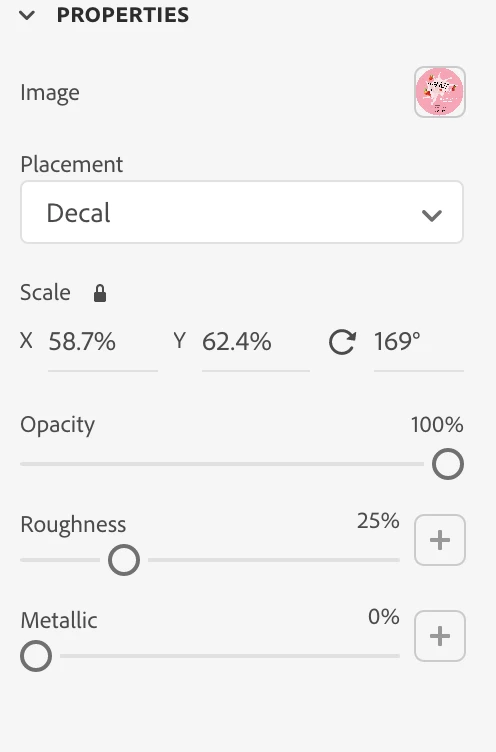

I am not shure but can you check decals filling option in property panels?. it looks like you have check mirror option for "Fill".
Quinni NAuthor
April 11, 2020
Actually I only put it up as Decal. This is what my property panel looks like right now. When I try putting it in as a fill the whole thing becomes abnormally distorted and stretched.
