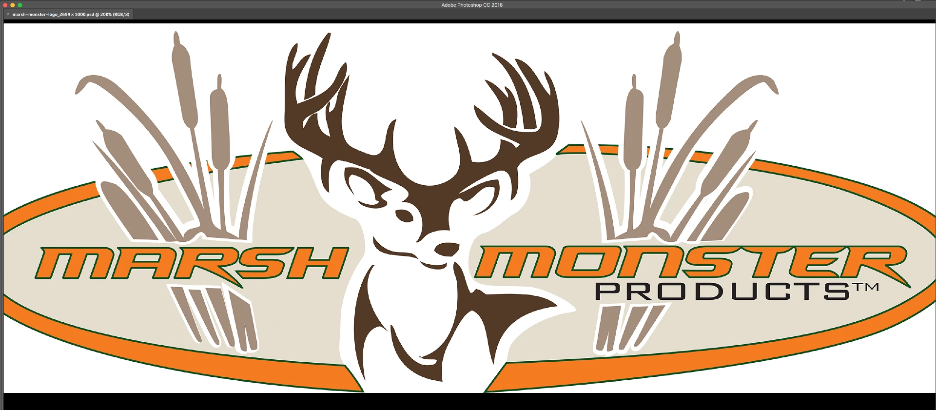

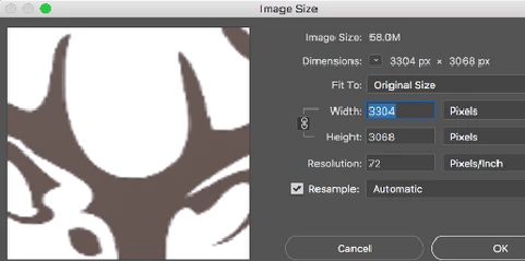

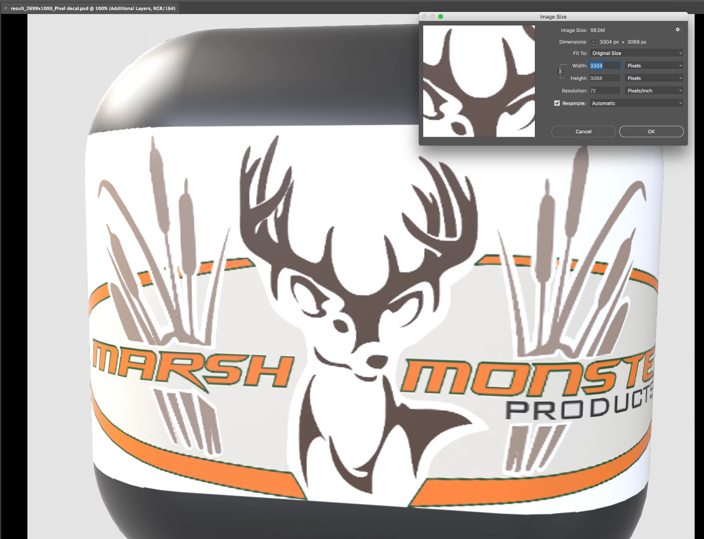

Placed logo art rendering with stepped edges
I use Dimensions to place label art onto honey pots. The problem I am having is no matter how big I make the canvas I get a very poor result with stepped edges on the text once rendered.
Does anyone have a fix to this or is it a current limitation of the software that everything is actually only rendering at a very low res? I have tried playing with the Viewport anti aliasing also and no difference. Screenshots attached.

There is an internal resolution limit on the decals currently.  This will be fixed in a future update.
Render quality and the option for viewport anti-aliasing will not affect this.

Add a 4096x4096 solid color image to the material's base color.
Dimension changes the decal's resolution to the material's resolution, so increasing the resolution of the material also increases the decal's resolution.
