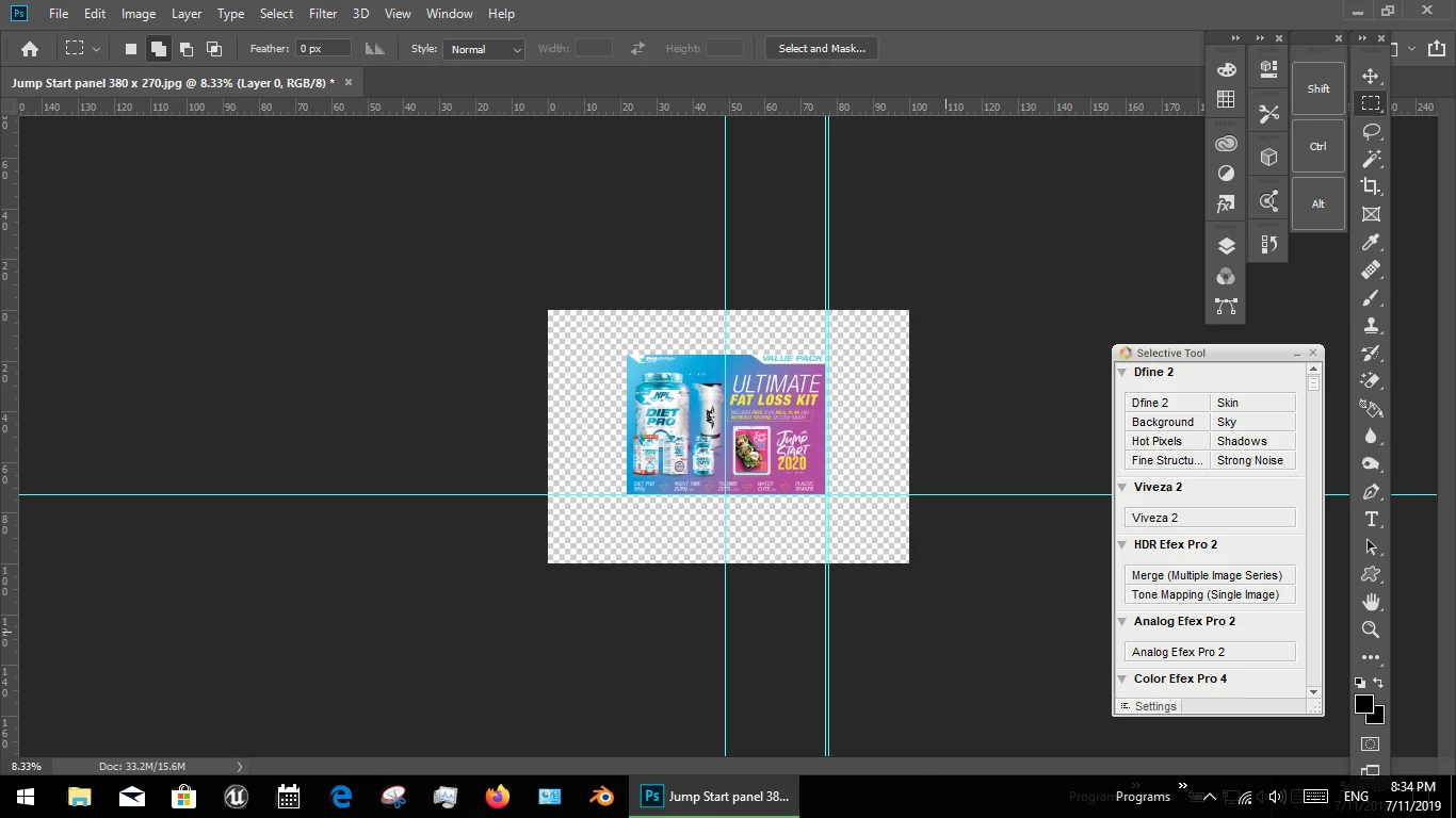

Does anybody know the best way to place decals onto a cube precisely in ADOBE DIMENSION? I've designed an image to the exact specs that match the plane of the cube but no matter what I do it doesn't fill the space correctly, and no amount of stretching and fiddling with the decal gets it to sit correctly. Any advice would be greatly appreciated.

the white edge is normal and I add blank space around my decals to correct it... distortion is what happens when you try and make decals the exact size i.e, the edges will auto wrap around the edges
also that is not square so a square decal will not fit unless it has blank space
Nov 7, 2019 9:04 AM UTC
I'm using a decal that is the same dimesnion as that side of the cube ie 380 x 270mm. When I place it it distorts as you can see from the image in the reply before this one.

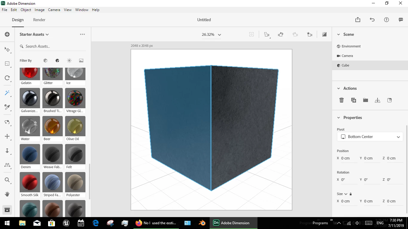

are you using the magic wand to split the cude into different materials?
Nov 7, 2019 8:46 AM UTC

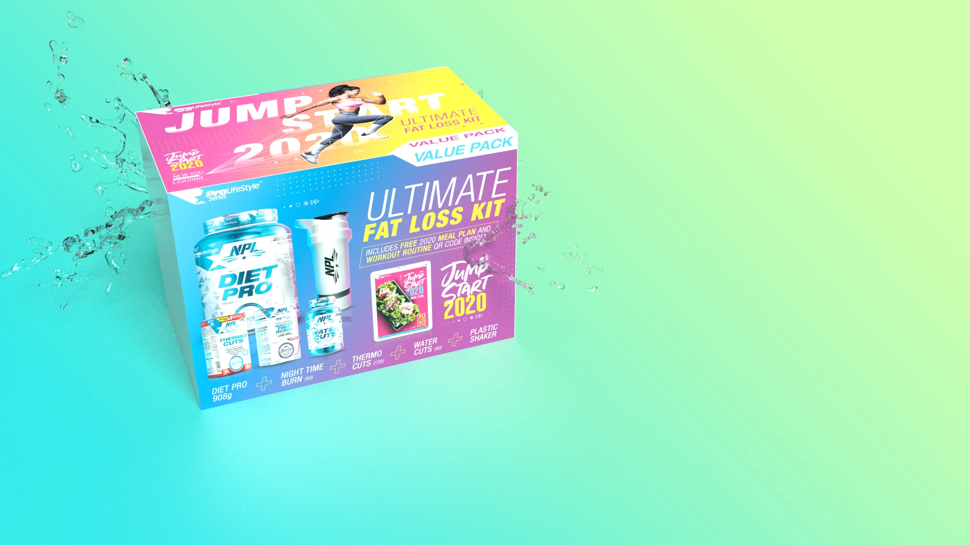

It's the same material just with a different image on the sides. I have pasted a render for you to see. You can see that it doesn't quite line up exactly to the plane. It's a white cube with decals. Also when I place the decals I make them the exact width and height as in photoshop as each plane is meant to be, but it always distorts the image and doesn't bring it in as it's original dimesnions. I have no idea why.

Nov 7, 2019 7:52 AM UTC
No I  used the exsting cube in dimesnion and just chnaged the size of it. The problem is I have four different decals that need to go on four different sides of the cube. And it needs to go to the exact edges of each plane of the cube. I can't get it exact, it's either too short or it freaks out and creates artifacts spilling over to the othre plane of the cube.
