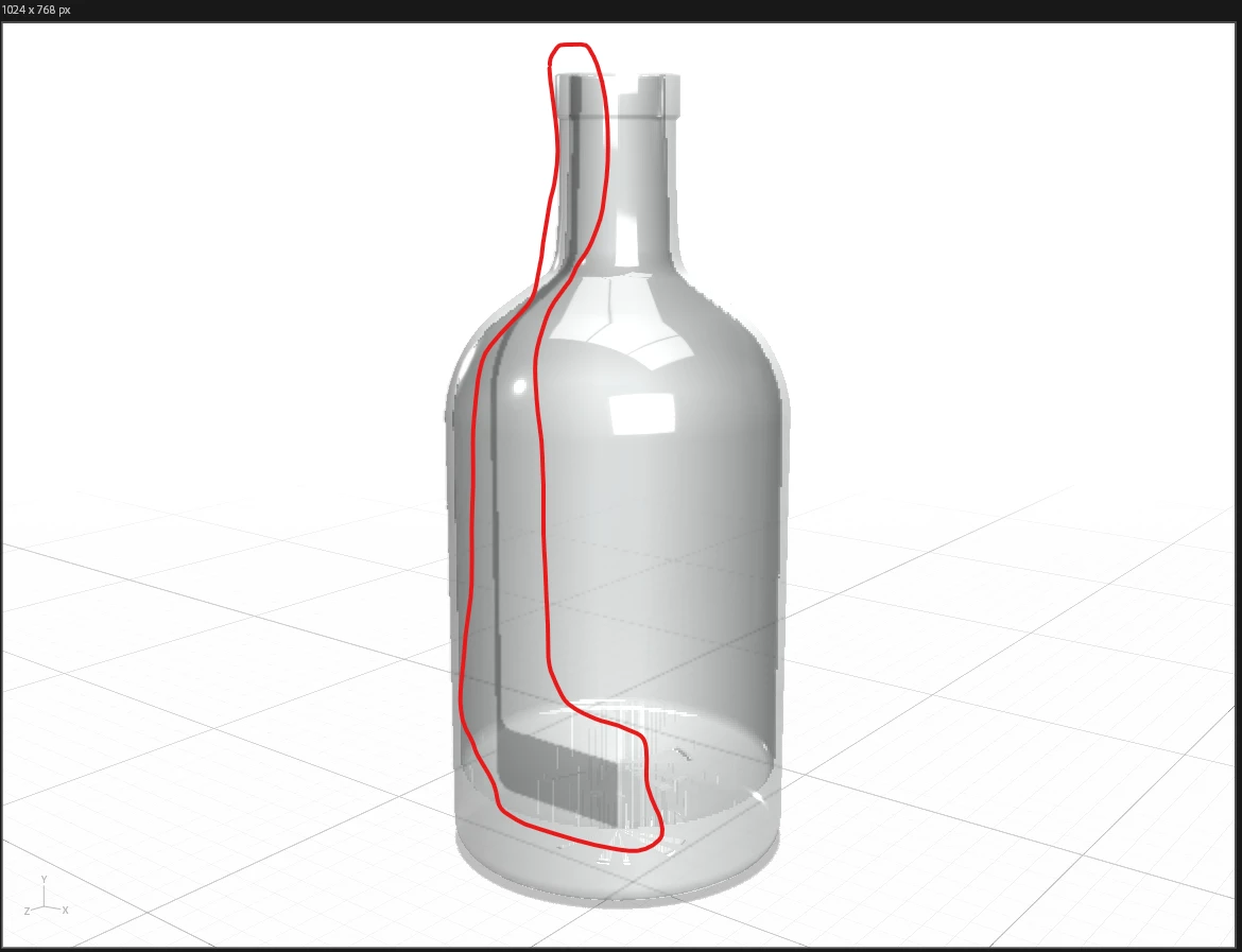

Problem revolution 3D in Dimension
I would like to create a bottle in 3D through Illustrator, Photoshop to finish with Dimension. But I can not achieve it without the edge being visible. How can I remove it? Thank you for your help

the edge is because you used an extrustion and they always have a small edge... not normally as big as your model but always there

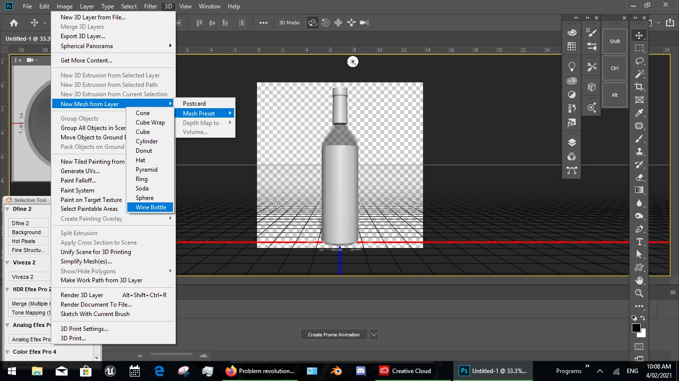

there is a template bottle in Photoshop which does not have this edge because it is not an extrustion, if that helps or your other option is to use a 3rd party 3D tool like Blender to remodel your bottle after export from Photoshop
but most people just make a bottle with 1 pixel edge ... unless the camera angle is down the neck this is never seen

Illustrator is not good solution as it create vector that canbe transferred as 3d object into Dimension
In Photosho you can find bottle model in 3d panel to creat one.
Also use Adobe stock free example from Dimension to download one and use it in Dn.
