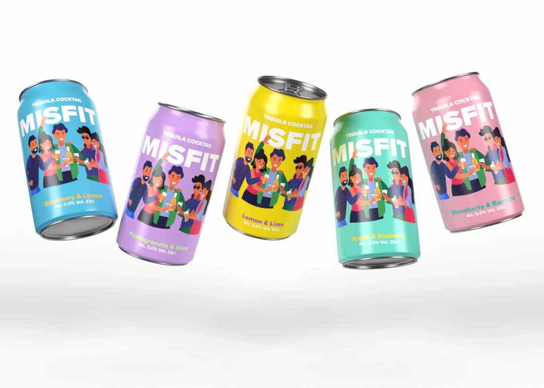

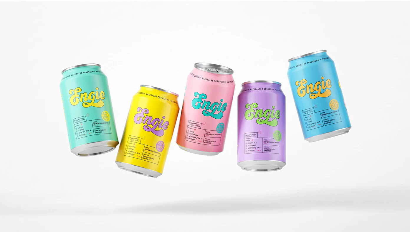

Thanks for taking the time to help me. I'm a begginer in dimension and I'm struggling with rendering and lighting my product. When I render to PNG, the resolution is rather low. How can I make it higher, like 4K? I'm very new to lighting, I'm trying to recreate the example below but the lighting currently shines on the can too much which ruins the design. I want it well lit, without the reflection.
My design -
The one I'm trying to copy -

the main difference is the image below has surface reflextion i.e, the light is hitting the ground and bounceing back up onto the cans which is why the colour looks washed out more and the shadow on the can bottom is gone

Hello, what is the settings of your file? Also you need to create and check the light settings. But there is a lot of settings you need to fine tuning if you want the same result.
There is the rendering settings PSD or PNG and you can choose between 16 & 32 bit.
For the Lightning in Dimension :
https://helpx.adobe.com/dimension/user-guide.html/dimension/using/lighting.ug.html
The canvas size :
https://helpx.adobe.com/dimension/user-guide.html/dimension/using/set-canvas-size.ug.html
Ares Hovhannesyan
May 22, 2021 10:28 AM UTC
Try to use different lightening option. F.e 3-point light, manage size and mode of highlight and manage roughness from property panels
