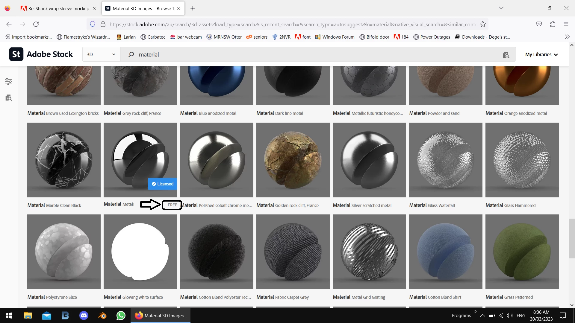

materials are listed in your starter assets and you can filter them [see image arrow]
for the sake of example lets say your bottle is currently set to metal and you use the magic wand to select all the outside edges [holding shift will add to a selection] then you press the plastic material with your mouse
so now the inside of your bottle will be metal and the outside edge will be plastic
ref = https://helpx.adobe.com/au/dimension/using/apply-materials-images-to-models.html
p.s, i should also point out that you can find and download more materials from Adobe Stock, some of witch are free and those are clearly marked

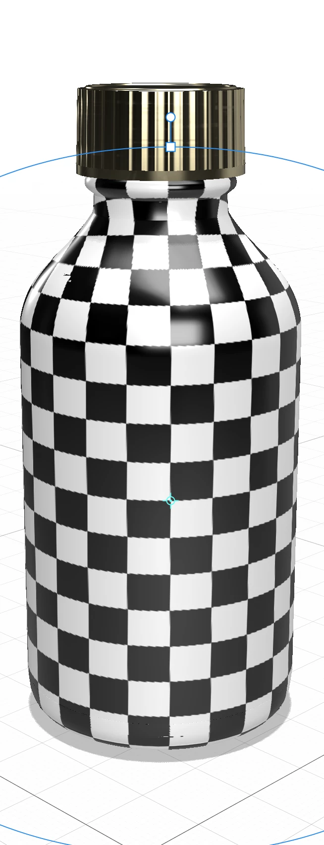

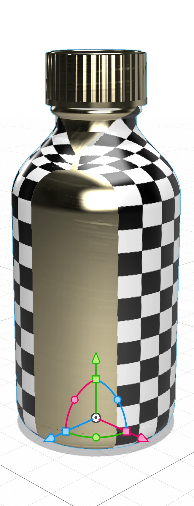

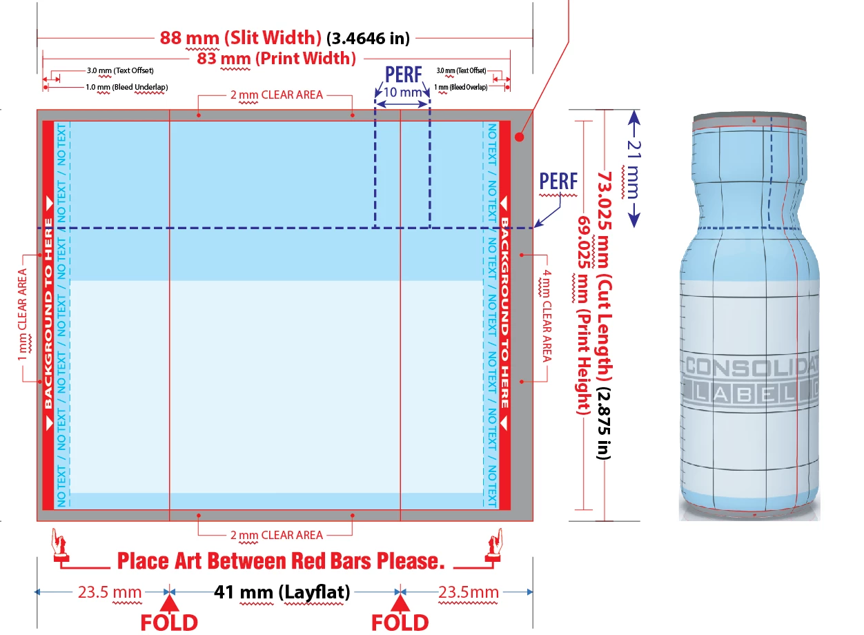

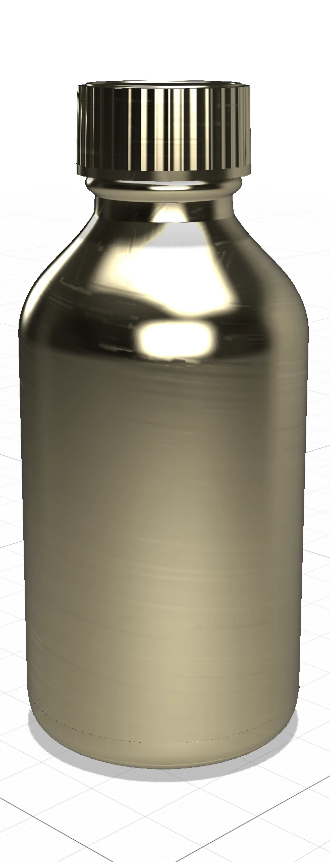

I can change the material, say to Brass and it's forgiving enough to look ok. You can still in the reflection the different shapes from the UV Map. I can then add just a stock image of a checkerboard, and get it to look OK from the ring down facing in one direction, but a peak at the back shows how the "decal" is not "wrapping" correctly. The last image is the tmplate I have been supplied by my customer's printer. Showing the flat die line then a rendered bottle. They using different software to create that render as it dimentionaly accurate to the bottle. I'm trying give a quick and dirty concept. But it appears too challenging to simulare a full shrink wrap.

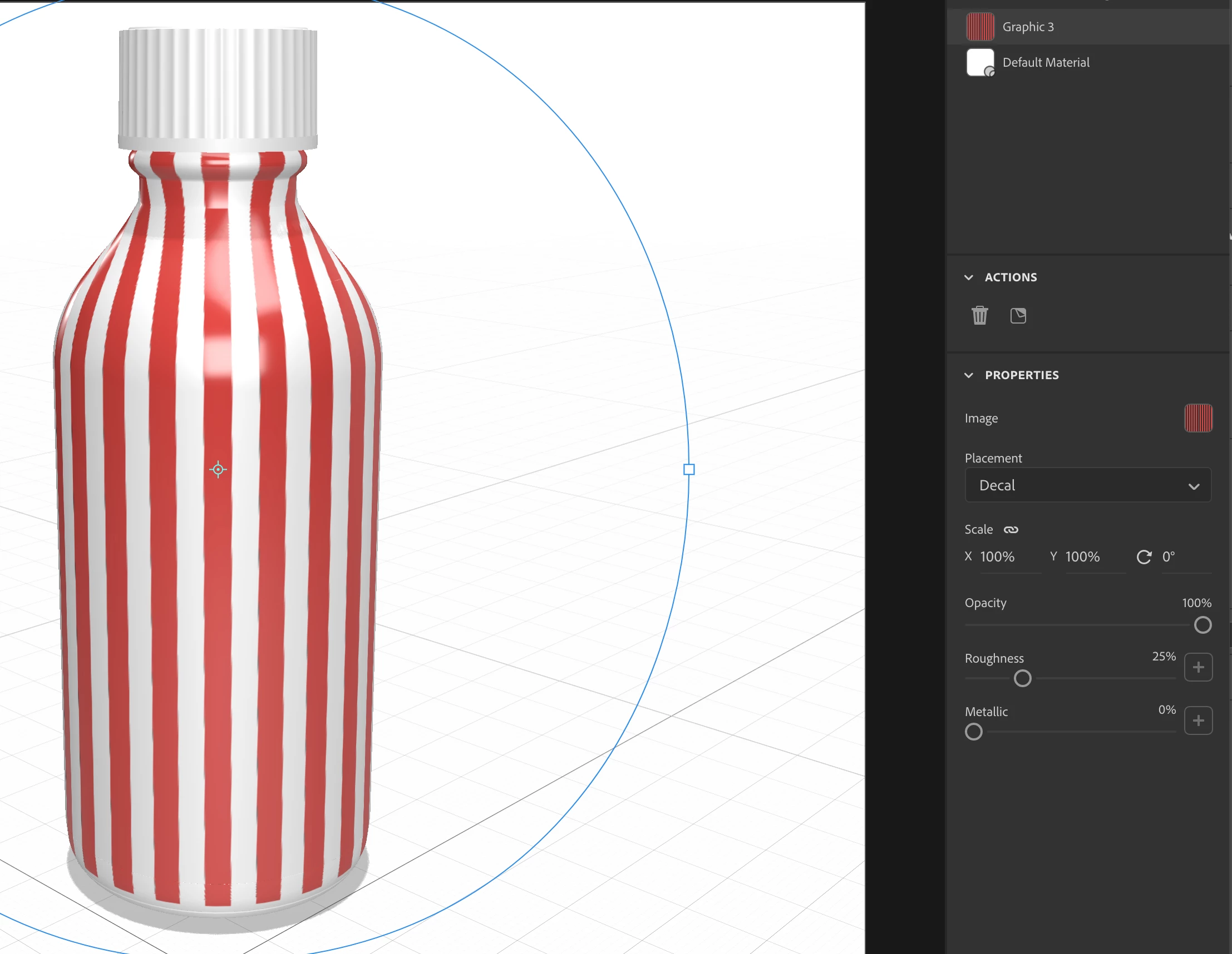

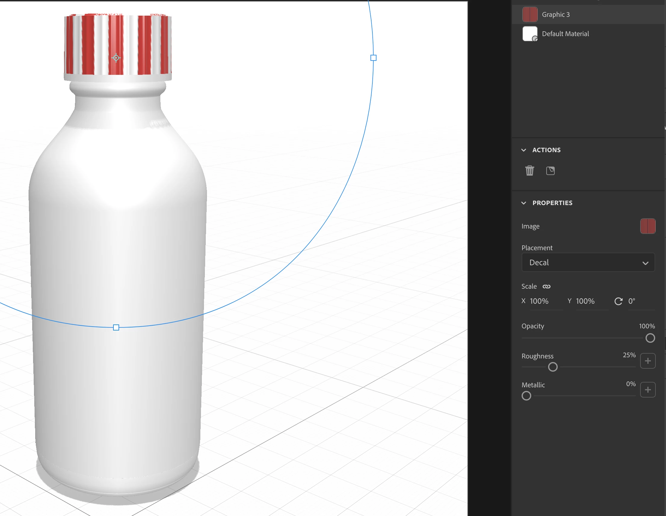

I have a grid built for a bottle modle I found in Adobe Stock. I want the grid (in this case the Stripes to gon completely to the top to the cap.
Image One: the grid placed as decal, and the image stops at the neck of the bottle.
 Image two: the image is only in the Cap Band:
Image Three: the image is only in the Cap:
Image four: If I make the placement a fill it's totally wrong, I'm guessing it's because of the shapes used to creatt he model.
I am ttrying to recreate this type of look. A shrink Wrapped bottle. Once I get my grid figured out.
