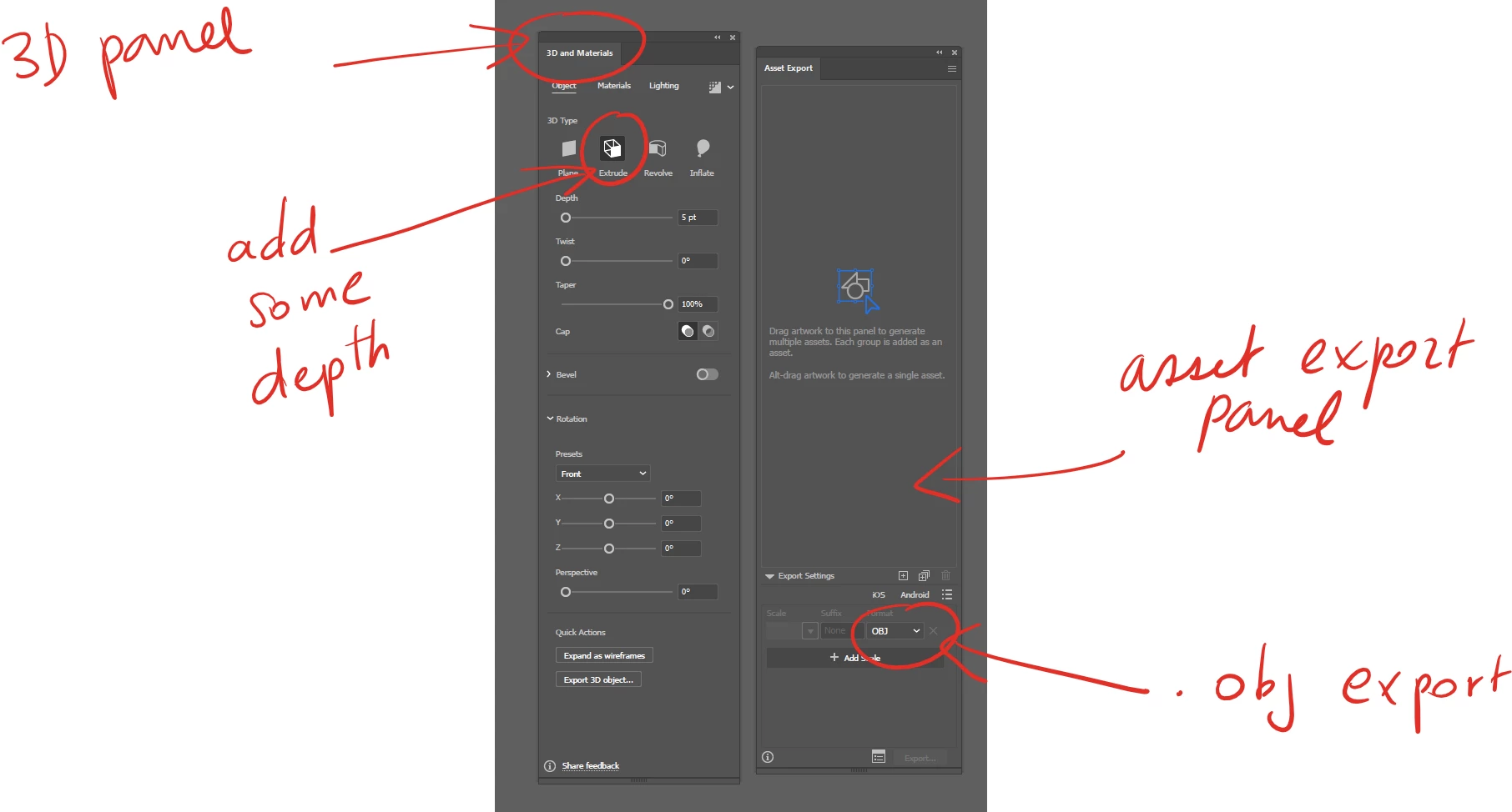

You could add a very shallow depth plane and place it on top of the object? (Of course it doesn't work if it's a rounded plane, instead of a flat surface)
For example, assuming you're creating the label in illustrator, you could use the 3D feature to create an .obj of said label, to be neatly "glued" to the surface in question.(you could also create a blank countour and apply the decal at the Dimension stage). It's made easier with the snapping...
That's the kind of thing you could do, in app, with Stager (as Ares, rightly mentionned) but not possible in Dimension as is...
