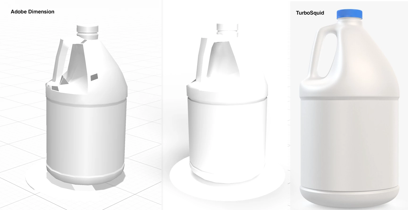

working left to right;
  1. the missing parts are because you changed the material to no standard and your cpu can't do the work... its only a preview
  2. the mid one has glow... thats why the lighting is so bright
  3. the turbosquid model is extra smoth because of the normal map
Dimension is working correct from i can see

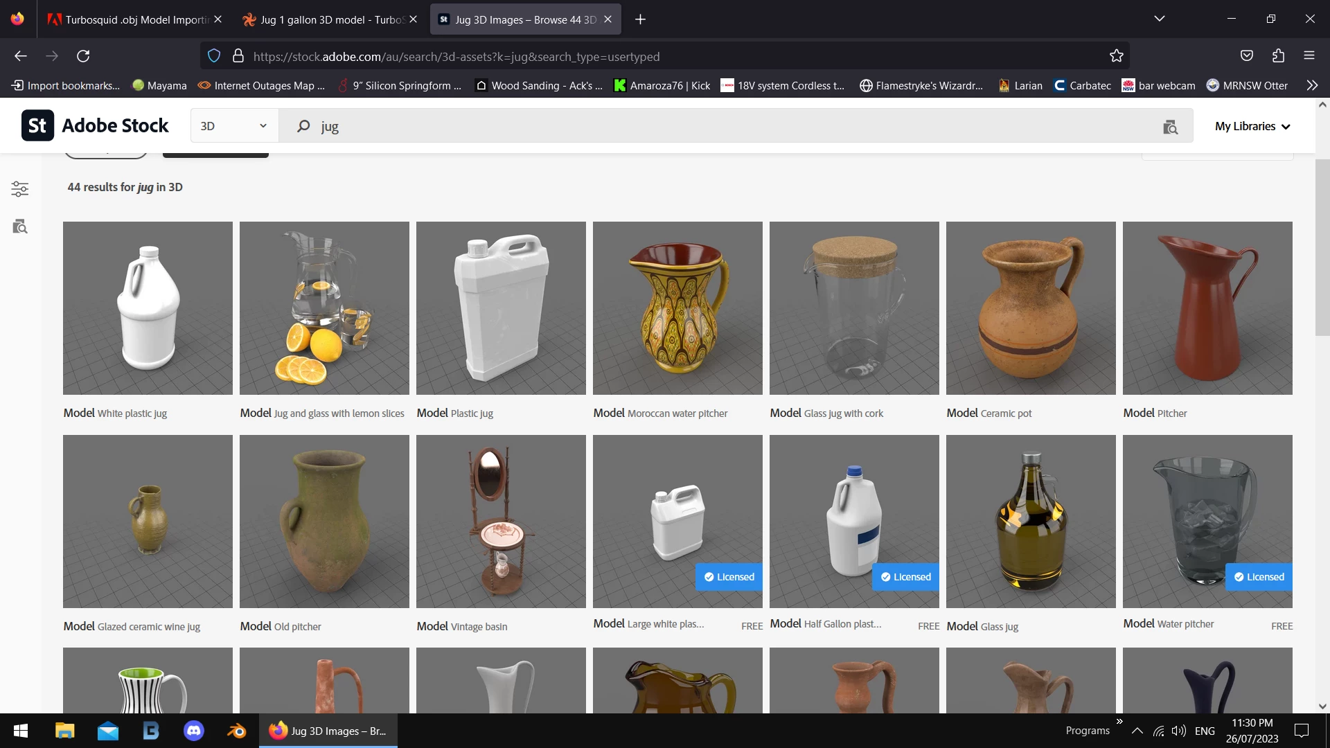

Jul 26, 2023 1:34 PM UTC
start by loading only the jug into Dimension on it own [press F] the focus on it and rendor so we know the issue is the model
next download another jug from Adobe stock... just pick on of the free ones for now and redor that on its own as well... once we know what is because of the models and what is just your system then we can decide
Jul 26, 2023 4:08 PM UTC
Thanks for the quick response!
I did as you suggested. I am attaching a PNG which shows the difference between the Dimension preview and rendered files as well as one of the Turbosquid renderings of the same model. You can see in the handle especially the difference.
I also downloaded the "a_jug_129.obj" from Adobe Stock and it rendered out fine, but it is all one piece (cap not separate) - so I guess the problem is with the TurboSquid model I paid for?
