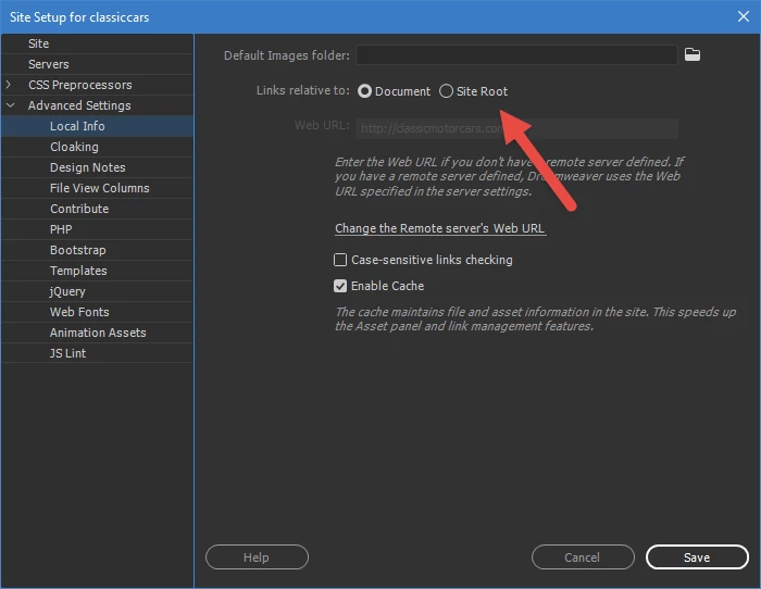

BenPleysier
Dec 23, 2018 1:43 AM UTC
karpiyon  wrote
Which I think is the root cause of this issues - it should be C:/xampp/htdocs/DnD_B4/css/main.css
Something just struck me that may solve the problem. Try links relative to site root.
I tried this using another program with positive results. No fiddling around with PHP code.
As side note: Birnou has indicated that he is sick of the criticism from one poster in particular. He will not be coming back. A PM to get him back here will not go astray. Hopefully others will follow suit..
karpiyonAuthor
Dec 23, 2018 7:18 AM UTC
Thank you again for all the effort spent on this thread.
...its not working...
I'll stick with my unclean solution for now.

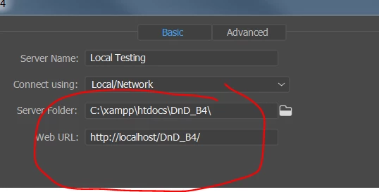

karpiyonAuthor
Dec 21, 2018 1:42 PM UTC
Thank you for your time & effort !
I followed your instruction and yes, now http://localhost/DnD_B4 takes mo to my website.
However, it does not solve the 404 issues when i use a link relative to root, e.g.
<link href="/css/main.css" rel="stylesheet" type="text/css">
I still have to use this unclean method if i want the styles to be applied and DW to show me the element properties:
<link href="<?php echo siteRoot()?>/css/main.css" rel="stylesheet" type="text/css">
<?php if(isLocalSite()):?>
<?php endif?>
I guess i'll have to stick with this
