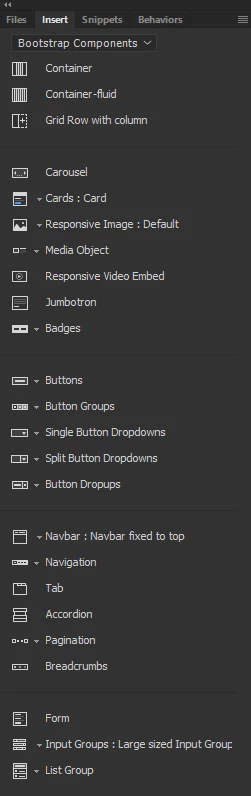

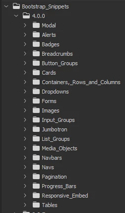

As osgood_ has explained, Bootstrap can be edited by any text editor, it is just that Dreamweaver makes it easier for you to manipulate the layout and add components without manual coding. The snippets panel looks like
However, Dreamweaver has a much handier way of incorporating Bootstrap 4, as the Insert panel suggests
The lines that contain a down arrow, can be expanded for variations, such as
With a click of the mouse, the component is added to your document, no hand coding required.
