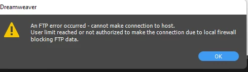

    I just tried connecting with the leading / in the root from within the site and got a new error message. See below.

    That error you are receiving is not a time out.  That is a shared hosting error that too many people are connected to your server or their firewall is blocking DW this transfer and has something to do with DW specifically. I was able to search for other posts and it appears this is something they are doing that is impacting DW. https://community.adobe.com/t5/dreamweaver-discussions/dreamweaver-20-2-won-t-connect-to-godaddy-any-longer/td-p/11508592
