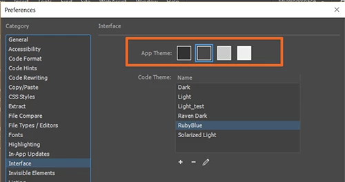

Nancy OShea
November 9, 2017
https://forums.adobe.com/people/wez+hind  wrote
Any clue how to turn the background colour of the files area white again?
Go to Edit  > Preferences > Interface and select a different App Theme:
I'm using a Dark Theme. This is what my Files Panel looks like.
Expanded Files Panel.
