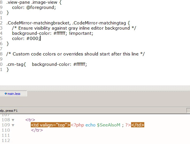

HOW TO REMOVE ORANGE CODE HIGHLIGHTING
How do I stop this moronic orange highlighting from appearing.
Thank you for deleting my previous question. Apparently you do not mind being idiots but you do not like people making the observation...
How do I stop this moronic orange highlighting from appearing when I click a <P or <TD etc?
I have tried the "main.less"
I have tried the "brackets.json"
And I have spent several hours trying everything else.
PLEASE ONLY POST IF YOU KNOW.
DO NOT ASK me stupid questions like "Have I tried VIEW > CODE > SYNTAX COLORING" because you obviously do not know.
Thank you
STOP-SPAMMING-MECorrect answer
May 24, 2017 11:42 PM UTC
I think that I fixed the problem,
Thank you to all who have helped.
The solution:
Go Here >>
C:\Program Files\Adobe\Adobe Dreamweaver CC 2017\www\main.js
CHANGE THIS
{className:"CodeMirror-matchingtag"}))}var s="close"==o.at?o.open:o.close;s?n.state.tagOther=n.markText(s.from,s.to,{className:"CodeMirror-matchingtag"}
to this (just put any letter on the end of the CodeMirror-matchingtag)
{className:"CodeMirror-matchingtaga"}))}var s="close"==o.at?o.open:o.close;s?n.state.tagOther=n.markText(s.from,s.to,{className:"CodeMirror-matchingtaga"}
Do some creative saving (Make sure that you make a BACK UP COPY FIRST
SAVE as main.js
Reboot DW
problem solved.
over 28 hours wasted on this
60 replies
May 24, 2017 11:23 PM UTC
Jon, the css above is when I tried to create a NEW theme.
I also went through the C drive and did a global search for MAIN.LESS and found 10 of them, out of this 5 had the CodeMirror-matchingtag etc which I also changed.
BG == #fff
Color == #000
Still nothing
So I changed the theme and now the orange has changed to a lite blue
Just marvelous...............

Ben, I already did that
It does NOT work
.CodeMirror-matchingbracket, .CodeMirror-matchingtag {
    /* Ensure visibility against gray inline editor background */
    background-color: #ffffff;
    color: #000;
BenPleysier
May 24, 2017 4:58 PM UTC
Did you add the red bit.
background-color: #ffffff !important;
May 24, 2017 6:44 PM UTC
I just did now you showed me and it still does not work.
I did reboot DW as well.
See image below
May 24, 2017 4:44 PM UTC
Jon, I do not understand. I do not want to change the "theme" and recode every css.
I just want to get rid of this one annoying Agent Orange feature.
I have spent almost 18 hours learning many of the new features (a complete waste of my time which has resulted in an angry client)
This is what I have done, I have tried both the white "theme" and the light gray theme and (Please read this) when I click the </td> tag or ANY OTHER tag, they ALL highlight with the same insipid orange color.
As per the attached image in my previous post.
I do not want to include any external CSS because google "Now" penalizes me for forcing them to do another "loop" to pick up the css before building the page.
I have gone through EVERY Hex code on the MAIN.LESS page and checked it against this color picker and anything orange, I have changed to white
Color Picker by WebpageFX
Yet the Orange BG problem persists.
