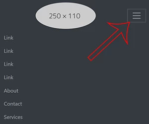

You asked for a navbar with centered logo that is responsive on smaller devices.  I gave you what you asked for using a Bootstrap document.  However it won't work without Bootstrap and jQuery source files.  See screenshot of the responsive (hamburger) menu.
Bootstrap is an open source framework.  You don't have to have the latest version of DW to use it.  But it makes things much easier if you do.

Nancy OShea
Mar 13, 2019 11:13 PM UTC
I wrote a document on this  below.
Bootstrap 4.2.1 Navbar with Centered Brand/Logo
Your social icons could go on either side of logo or in your footer.  It's your choice.   Personally I put less important content below the fold.
